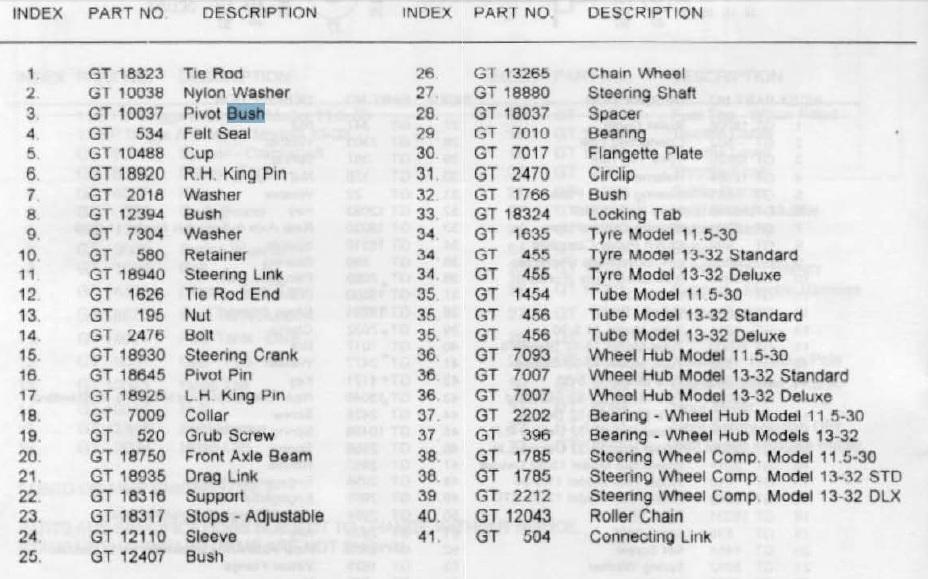

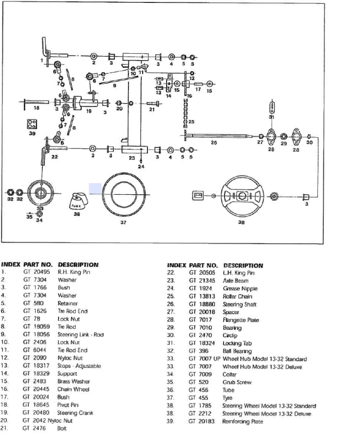

I am currently replacing the 3 steel steering bushes, the first 2 which connect the steering arm to the kingpin are not in the drawings so no part #, the third is GT20024 is this readily available and how do you get the steering assembly out.

I'm not clear on which parts you are talking about with regard to bushes. By my reading the kingpin bushes seem to be GT12394 - Item 8 on the assembly diagram in the Illustrated Parts List.
For parts availability I think you will need to contact a Greenfield dealer, or perhaps the Greenfield service department.
To discuss how the steering is dismantled, I think we will need a series of pictures of your mower's steering.

Thanks for the reply, In my manual that came with my other greenfield mower (only difference is the blade engage set up) the part bush doesn't exist. Item 8 is a tie rod. but saying that your list may be more precise than my supplied manual. May try just to get some made as they don't look to be to hard to make.
Will do the pics of the steering assembly when I get to that point, just so there aren't more parts on the bench. one step at a time
Here are the pages from the Illustrated Parts List for the Evo 3 Mk 2:
Item 8 looks like the right bit to me, but I suggest you compare the diagram with your mower, and see if it all fits together.

Your right but that is not the drawing I have. is the Evo 3 Mk 2 A different ?
I have the owners manual for a evolution 3 Mk2 A, and on page 20 show a different picture.
https://www.outdoorking-forum.com.au/forum/ubbthreads.php?ubb=showflat&Number=12089 second bottom one
But the item 3 GT 10037 ( Pivot Bush) looks like the part I am looking for. Item 8 parts are ok
How do do post pics?
If your mower is an Evo 3 Mk 2A, not an Evo 3 Mk 2, we have been discussing the wrong mower. Here is the Mk 2A steering parts diagram:
Here is the corresponding parts list:
What I would describe as the king pin bush is Item 8, Part Number GT12394. Note that 4 of them are required: right and left, upper and lower. Do not omit the thrust washer, GT2018, which must be placed between the underside of the front axle, and the stub axle, on each side. Note that these parts are identical to the Evo 3 Mk 2 parts.

this is the pic. I have, both pivot and steering bush are around $8 each so all will be good thanks to all for your help.

P.S. there is a lot of difference between the 2 and the 2A or is it just the drawings
Hi Besser, and many thanks for posting, this may come in handy for another member that has a 2A...and yes; there are some differences. wink

Found the problem with the drawings, both greenfield s I have, have the same markings eg: Greenfield Evolution3 MK 2 A. But different years so the steering system is different as I found out today when I went to change the pivot bush on the other one. so that explains that part. Now just the upper steering chain & gear assembly to pull apart and see which bush it is( hopefully only the bush and not the gear)
