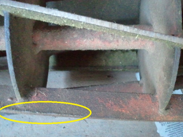

hi Deejay, here,s the piccies
[Linked Image from i856.photobucket.com]
from what you,ve said with the myths, is std A4 paper a large enough gap between wheel and cutter bar, or should it be larger/smaller,,?
{a friend uses a cigarette paper}
also out of your info I,m thinking the amount of face on the cutter bar is to large causing the grass to be gummed to death rather than cut,, the mower cuts carpet grass cleanly, but couch is a bit less than ordinary,

Geoff, one of those reel blades looks as if it may have burrs, which would mean it had been making heavy contact with the bedknife. See the yellow oval:
There is some kind of grass fur all over the blades, so perhaps that accounts for the build-up on the back of the blades as well. However, they must not make any significant contact with the bedknife at all. Deejay is the man to sort all this out with you, to the extent he can while he is interstate working on a mobile phone, but if your blades are burred it looks as if you are going to need to tidy up that mower quite a bit - the bedknife will be damaged too, by the contact. This might also explain the issues you have been having with the adjusters.
On the plus side, there is still plenty of meat left on the reel, which is the most expensive part of the mower. If you listen closely to Deejay, chances are you will soon have your SB humming and cutting like a new one.

the small burrs are a mix of dry and wet grass, and is on the back of the cutter,
wondering if any ideas for a fix have been thought of, or am I buying new bits
steptoexs11 #44430 08/03/13 12:34 AM
Hi again Geoff, In my opinion, that reel has plenty of meat on it, a little hard to see the bed knife blade; but in any case from the appearance of the reel, it needs to be professionally sharpened. wink
You need to remove both the reel an soleplate complete with the bedknife still attached, and take them both to the engineer/machinist who will spin grind the reel and face the bedknife correctly for you. Instructions on how to do that are found HERE
To adjust the clearances correctly on the re-install, you will need to check the serviceability of the reel bearings, these are cheap to replace...so please do so if you are in any doubt at all. wink
