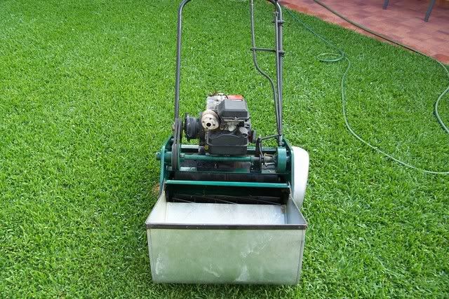

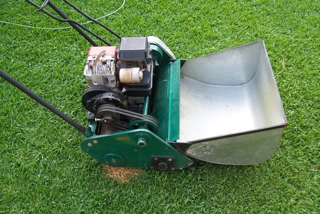

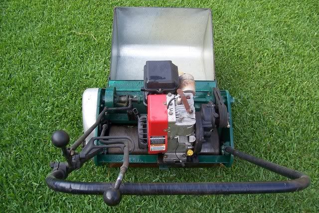

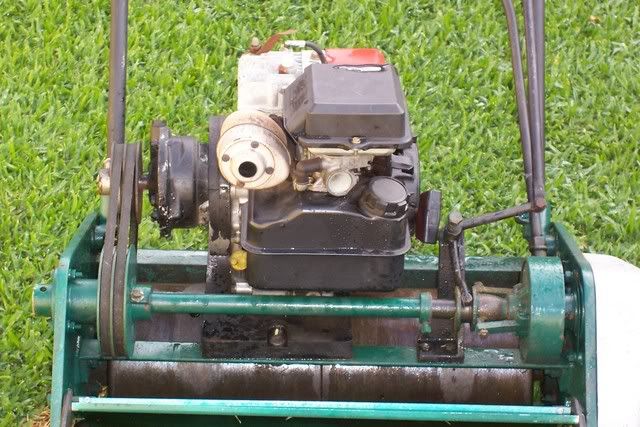

Thanks for the reply Bruce. I dont know any thing about these mowers, i picked it up out the front of a house that was having a yard clean.For the grand total of 2 nuts and bolts and some time on the motor she runs.When picked up it had no compression,pulled the head off to find a valve was stuck open. Some CRC and a tap with a hammer freed it up.I have even mowed the lawn with it now, though its not perfect.I will post a pic so memebers can id

[Linked Image from i235.photobucket.com]
Today i fitted a new catcher i knocked up from some galv sheet metal
