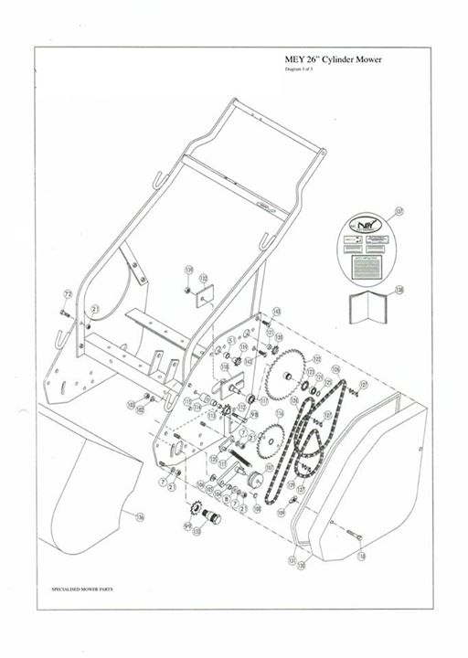

They are chain drive.
Here's a pic from the 26TC Parts List:
