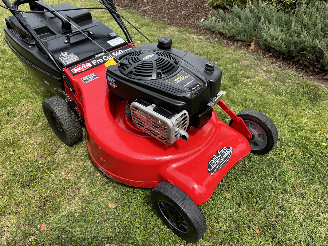

After near 20-years working part time for the same company, starting in early October 2024 I decided to use up some hard-earned long-service leave. It's a long story, but I had been planning this leave for just on two years, basically waiting for my brand new Mustang to be build and delivered. Yes, I waited two years for a Ford. I ended up taking off on leave two weeks before the car arrived, promptly finding something that caught my eye on Facebook Marketplace....................................
[Linked Image from i.postimg.cc]
This is what I call the Unicorn.....................a Rover ProCut 560 with the Briggs and Stratton 190cc 850-series engine. Having had a number of these over the years, this is the engine I always wanted on the Rover. The OHV 850-series appeared in the late 2000's and replaced the older Intek Edge engines. With a cast iron bore and a healthy 190cc, I've always found these engines to be super strong, pretty much the only 4-stroke push mower engine that can keep up with a Victa 2-stroke. The only main drawback to them is the fuel consumption, but I'd much rather have power and torque to spare than saving fuel.
This example presented very well in the advertisement and was located only an hour away.
So, after I contacted the seller on the Saturday and organized a time to have a look at it, I got in the Ranger on Monday morning and set off towards Cobram-Barooga.
Once I arrived, I spotted the mower in question was stunned at its condition, the photos didn't do it justice! Chatting with the seller, he seemed to be into mowers as well and once bought (another, not this one) brand-new Rover from the factory back in the day. This particular ProCut was handed down from his grandfather, which nearly had me in tears because I too have my grandfather's old mower. Apparently, the seller was downsizing so the Rover was just too big and heavy for him. The machine was originally sold by Sugden Kerr in Toowoomba, its better traveled than me!
After collection and on my way home, for the first time ever, I decided to check out some silo art....................
I can't begin to explain how excited I was to get home and get stuck into this new-old Rover! I never intended on buying another ProCut, let alone one with the good engine. This particular example happened to pop up at just the right time and kick-started my long-service leave on a high.
To be continued...............................

Once I got home, I wasted no time and got stuck into mowing the front nature strip to get a feel for it. I then grabbed the tachometer, the 3030 rpm is the fastest standard Briggs 850 I have come across, most of them sit at 2800 - 2900 rpm from the factory. I then grabbed my excellent Knipex curved pliers to bend the governor spring tab towards the front of the engine, bringing it up to a healthy sounding 3670 rpm. This also speeds up the self-propel to a more efficient walking pace.

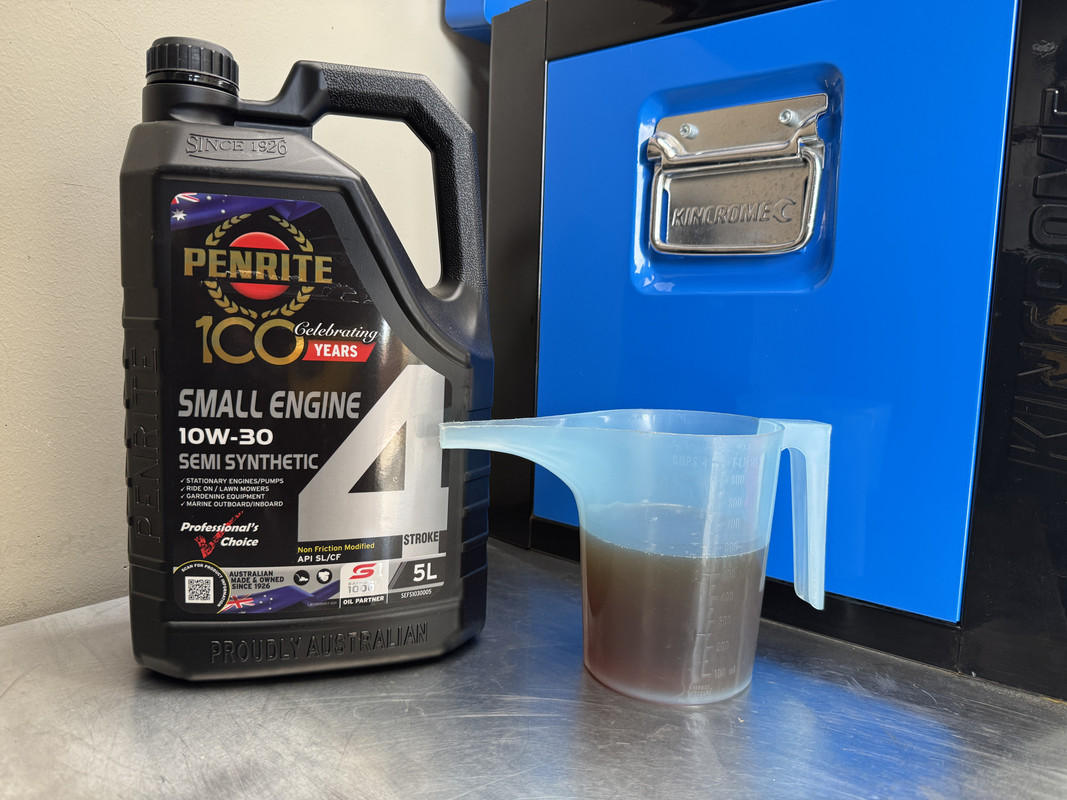

I do this to all of my engines, usually after the first oil change. I don't necessarily run an engine at 3600 rpm all the time, but it's nice to have some headroom when the going gets tough. And compared to some contractors I see (and hear) going around, 3600 rpm is tame!
The seller mentioned it had synthetic oil in the engine, and it still looked golden, if a little over-full. After tuning the governor, the oil was up to temp, so I decided to change it out for peace of mind. Oil of choice being my usual preference, Penrite 10W-30 semi-synthetic.

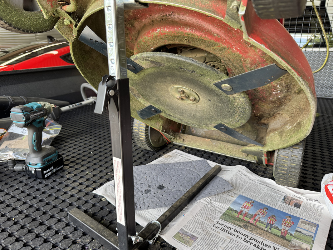

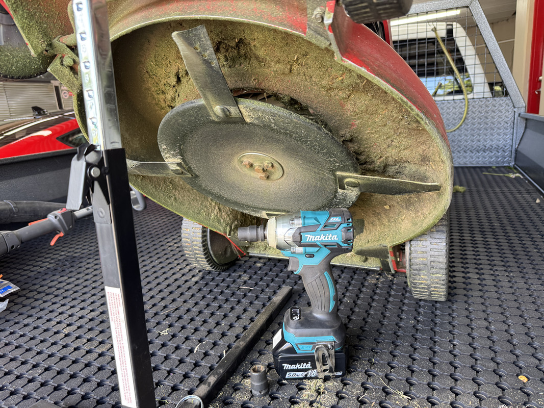

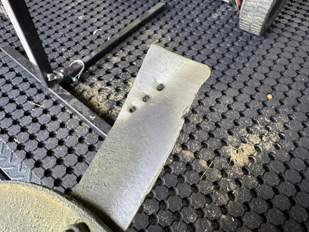

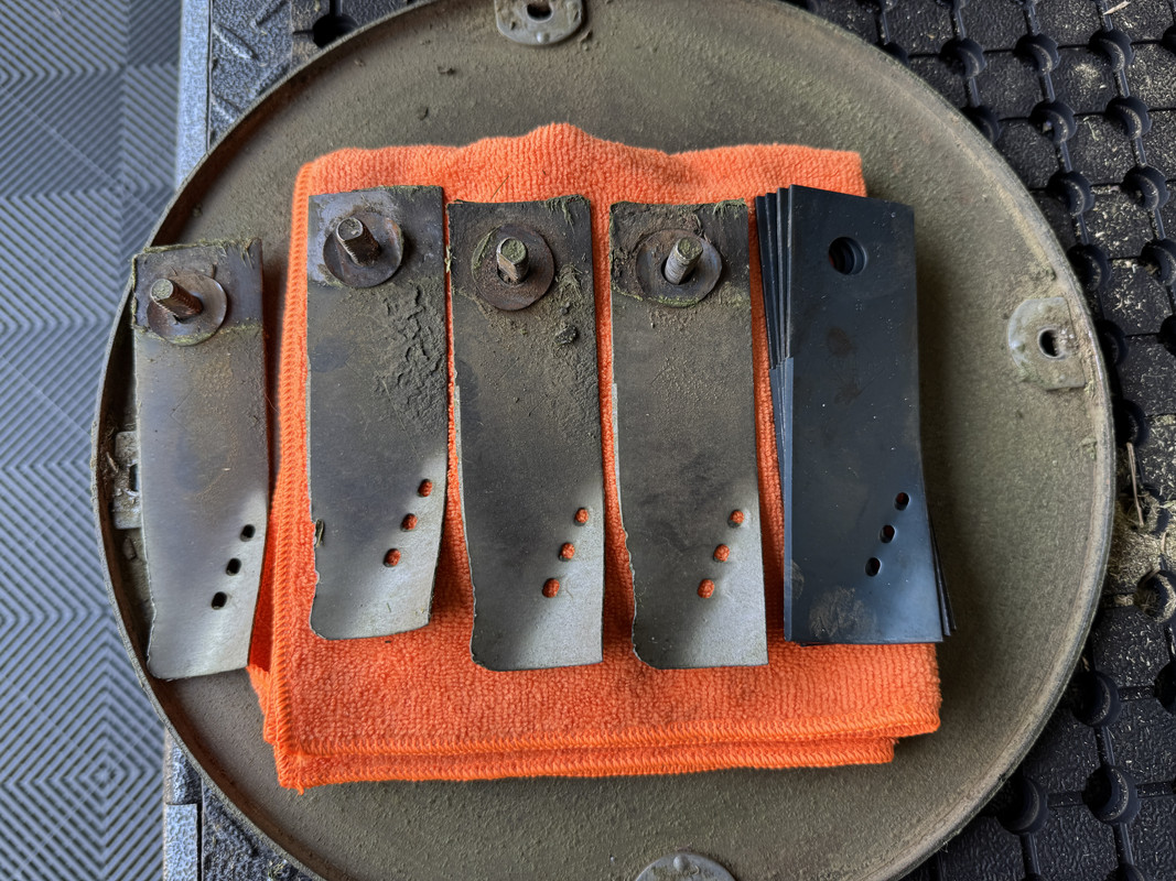

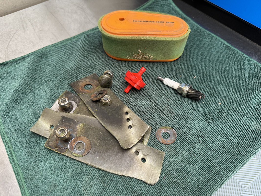

While the oil was draining, I took the chance to inspect the blades, which are the OEM style with the three holes. The belt also looks in great condition.
The drive system is a little clunky and needed investigation, which the seller mentioned so it wasn't a surprise to feel this. I did pop off the hub caps and inspection plug to look at the cogs, which looked fine. So, I lubed the cogs with graphite to see how it went, and if needed, I had a replacement set of cogs and pawls. I then removed the gearbox/clutch cover, blew out a small amount of debris and lubed the drive chain.

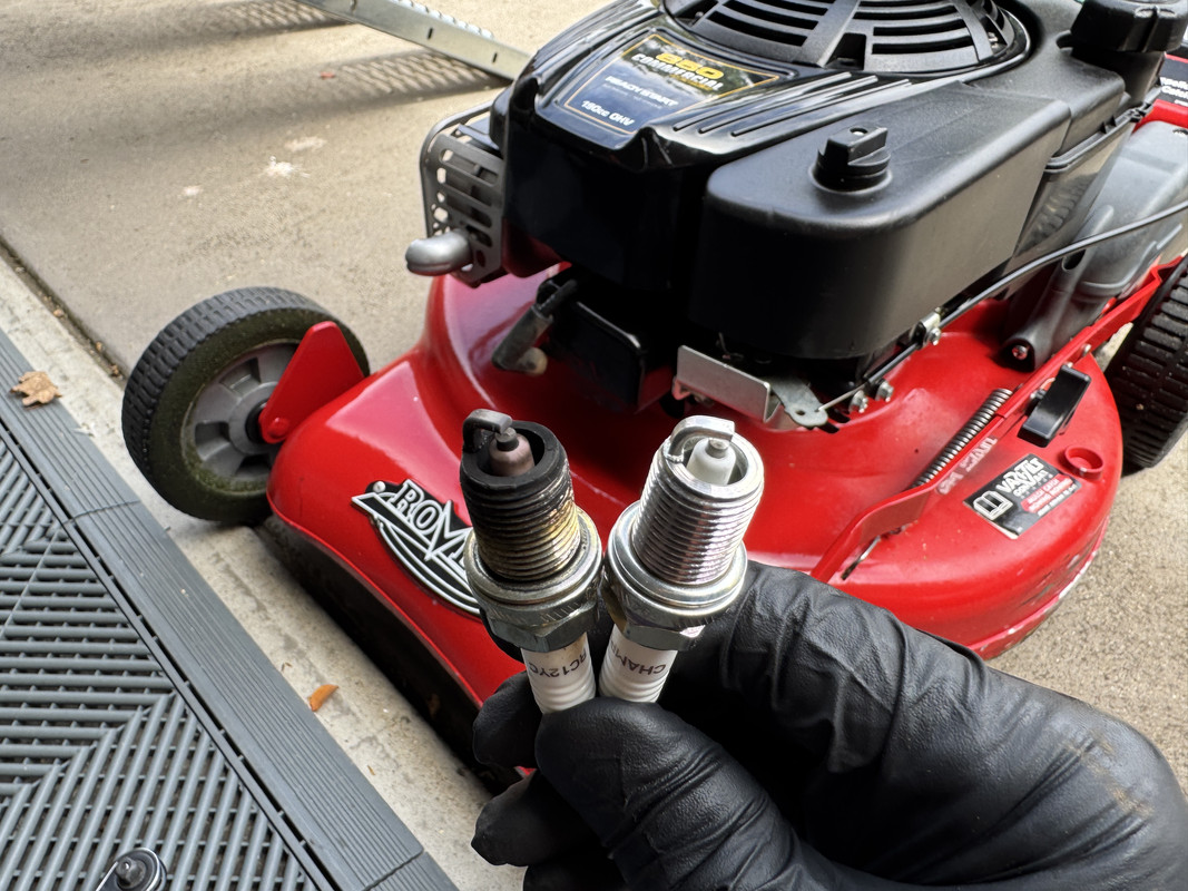

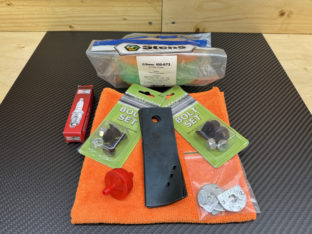

Next, I decided to pull the plug, which was ok but well worth replacement. The 850-Series uses a Champion RC12YC or NGK BCPR5ES, of which I keep the Champions in stock. You will need a 16mm deep socket for this. I use these plugs across 3 Briggs 850's and one 750iS.

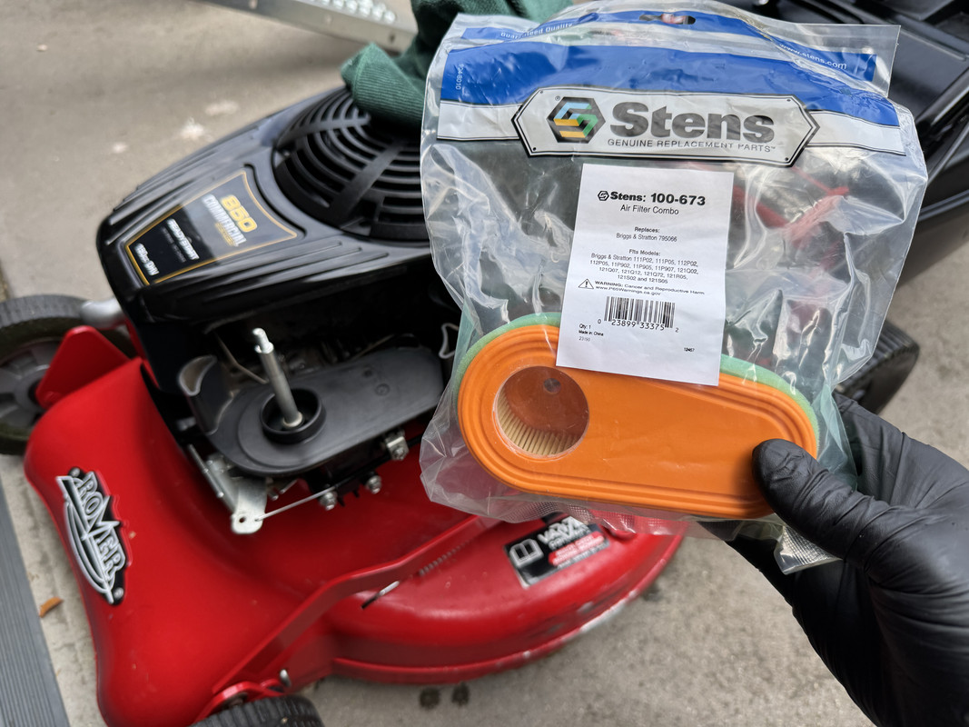

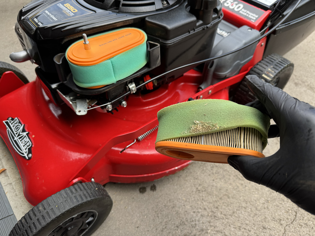

Annoyingly, I didn't have a brand-new air filter in stock. These earlier 850 engines used a longer rectangular filter instead of the triangular version on the newer engines. A clean used filter I already had will have to do for now, which was better than what came off the machine.
To be continued................................

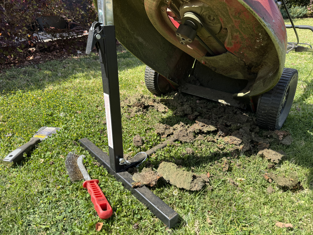

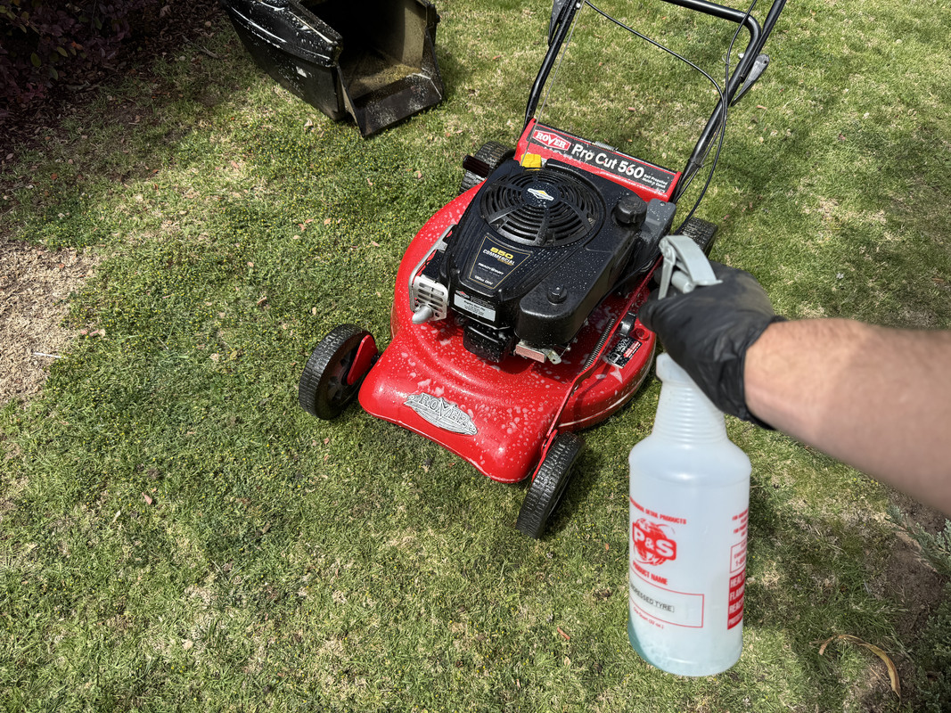

Because clean mowers cut better, I then got stuck into giving the new-old Rover a little detail.
After a rinse with the pressure washer, I sprayed the Rover down with Shine Supply Wise Guy, agitated with a brush and then rinsed. I then followed with Carpro Hydr02, which is a touch-less water activated spray sealant that is applied while still wet and immediately rinsed with water. From here, I dried it off with a leaf blower, then went over the catcher, engine plastics and wheels with Megs Hyper Dressing.
After a basic service and a clean, the Rover was ready for work. Hard to believe this is a 11-year-old mower........................

Rover ProCut 560 – Spring Service
It’s now been a year since I found this beauty, and its been working hard!
When the Rover came to me, it was in remarkable condition for a 10-year-old mower. The previous owner had inherited the machine after his father passed away, both clearly kept it well maintained. Even still, I did a reset on it by changing the oil, plug and air filter. I also had to refresh some of the drive system parts, but overall, I had a near new ProCut 560 for half the price I paid for one new in 2015.
After a busy 2024/2025 spring/summer, in February this year I gave it an oil change and a set of new blades. I also replaced the useless fuel tap with a fuel filter. Now that the weather has warmed up and the grass is growing again, I want this mower in top condition for the season ahead. Look after your tools and they will look after you……………………..

Blades –
The current set of blades have been on the mower since February, and while they looked ok at a glance, I had been noticing a decline in cut quality. On closer inspection, they were well worth replacing. As per most Rover stuff now, finding OEM has become hard. I’ve noticed that when I’ve put the OEM Rover blades on the mower, they seem to last longer than the aftermarket stuff from GA Spares or Jak Max. Depending on where you get them, they will come pre-packaged or drawn from bulk lots of blades and hardware. The Rover branded ones come pre-packaged in sets of two. In this case, I’m using the Jak Max versions.
Deck –
While I had the blade carrier off, I took the opportunity to scrape off the accumulation of dirt and grass. Nothing special or glamorous here, just a paint scraper, wire brush………………….. and a giant mess afterwards.
Oil Change –
Briggs normally specify SAE 30 oil, which I use in their older engines or for break-in. Otherwise, I’m using Penrite 10W-30 semi-synthetic. For the big block 850-series, you need 590 – 600ml of oil.
If Penrite is good enough for a Bathurst win last weekend, its good enough for my lawn mowers. …………………
I normally drain or suck the oil out via the dipstick tube. On this occasion, with the blade carrier removed, I decided to remove the sump plug instead. I’ve actually never done it this way, in fact Briggs & Stratton have removed the drain plug from their engines in recent years. Victa’s fitted with this engine are pressure lubricated via an oil pump, which is ran through an external oil filter. Those little filters are extremely expensive at $19.95 each, twice the price of some automotive filters. For the ProCut, Rover went for the basic splash lubrication, which saves me $20 per service.
Cleaning –
With the oil change finished and the blade carrier reinstalled, I decided to give the unit a clean. Shine Supply Wise Guy was sprayed on, left to soak, then rinsed with the pressure washer. A little Hydr02 for the deck, and some Hyper Dressing for the plastics, I then used my blower to dry it off.
Spark Plug –
The plug was last changed 12-months ago when I got the mower. I could have just cleaned it, but I had them in stock so just went ahead with a new one. I went with the Champion RC12YC, but NGK BCPR5ES works as well.
Air Filter –
I’m actually a little disappointed in myself for not checking the filter sooner. I normally tap them out weekly, but for whatever reason I had let it go. No wonder the engine was running rich.
Briggs & Stratton -
Early Models (Long-type) – 795066 (Filter) + 796254 (Pre-Filter)
Late Models (Triangle-type) – 595853 (Filter) + 597266 (Pre-Filter)

Service Cost –
Below is the parts cost to complete this service. If I add my labour rate to that, it would come out at about $177. So I saved about $90 - $100 by doing it myself.
Blade Kit - $39.95
Oil (590ml) - $7.45
Spark Plug - $8.95
Air Filters - $19.30
Fuel Filter - $9.95
Shop Supplies (Towels, Carb Spray) - $2.00
TOTAL - $87.60
