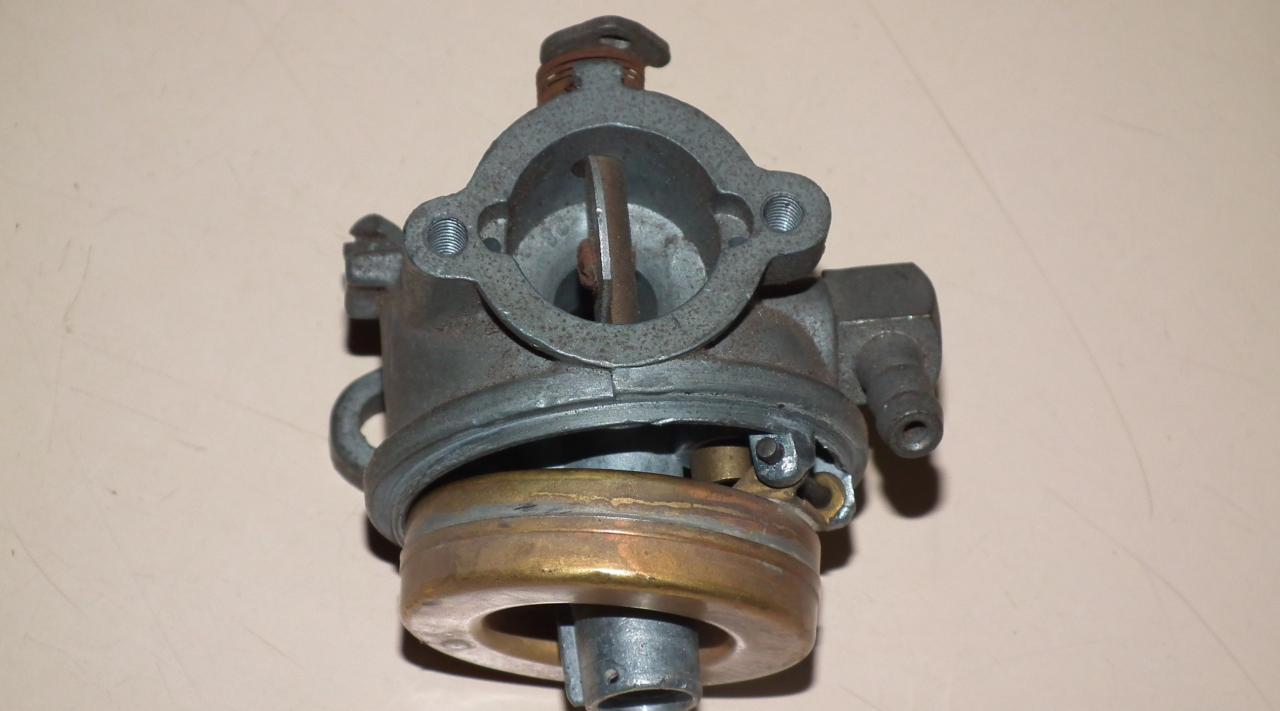

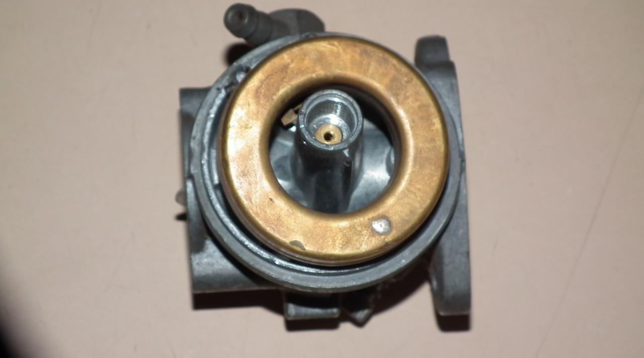

Hi, Does anyone have a carb that will fit this mower as the previous owner has striped out the internal thread for the bowl nut and main jet so now the bowl bolt wont catch carb is a Walbro 50 but Kirby Lauson made there engine under license from Tecumseh so maybe a Tecumseh carb will work. I have hunted high and low emailed every man and his dog in USA but no joy. So i was hoping that since its an Ozzy make engine maybe someone in this forum can tell me where i could buy one from in oz thanks Pete
Posts: 6,926 Likes: 10
I hope you get lucky with that Pete - I think it would have to come from a wrecked engine. Have you looked at the possibility of using a Helicoil to repair the old thread?

Can you post a picture of the carburetor, complete with air cleaner, Pete? Someone may have an old mower laying under four feet of pig manure in the back of the house-paddock, and not recognise the description, but that air cleaner is very distinctive - and I think the carburetor is the same for both horizontal and vertical crankshaft versions of the engine, if it's the one I'm thinking of.

Nice pictures as usual, Pete. That looks as if it is the standard carburetor used on all of the old Kirby-Lauson and Tecumseh engines fitted to so many mowers here in the late 1960s and 1970s. So, does anyone have a defunct Kirby-Lauson, or a carburetor for one, that they aren't planning to use again?

Id say the later Tecumseh 4 stroke carb would work pretty easy, right down to the air cleaner mount. Looking at the pictures they are dead ringers. Just need the one with the adjustable main jet.
Theres an early and a late TVS90 carb too. Most i get have had water or ethanol in them and the carbs need a clean out. Ive struck the two different sized holes for the carb bowls.
The linkages would go close to working too. Well linkage. Id say that the one closest the air cleaner in that carb is the choke.
I would assume that carb has a fixed hole jet/bowl bolt and the screw up the side is the mixture.
Having the rubber primer bulb on the side would ruin the look somewhat. But it could see it running while you are looking.

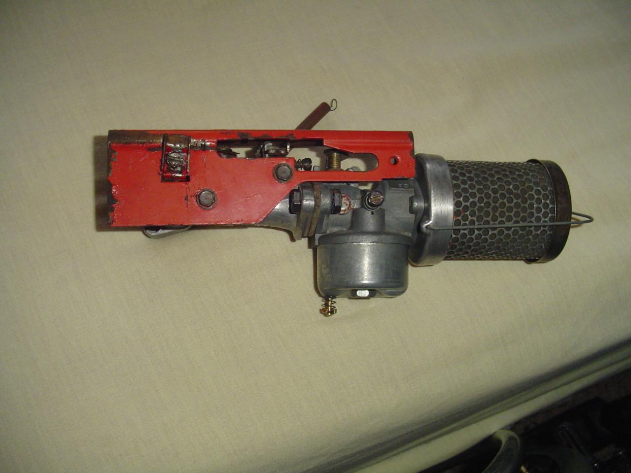

Hi Bob, Ive had a look at the TVS90 (632795A) carbs and none of them have a choke butterfly or linkage. Do your ones have a choke linkage ? Pete
Posts: 1,819 Likes: 6
Nah they dont have the choke, but with the button primer you do not need a choke. Keep an eye open, i will snap a pic or two and post them up.
Is the manifold on yours the same with the plate over the top of the carb coming off the inlet maniold?? its got the kill wire and a linkage on it that the cable goes too. Pulls on the srping and the rod from the govenor goes back to the butterfly shaft. Its got screws for the idle and what not. If its similar, just remove the choke relay rod and keep it aside for when you find a new carb.
Having now seenthe damage and knowing now that it has no jet in the retaining bolt i can offer another suggestion. Im sure you have a selection of drill bits. What size is the hole??? what fits in cleanly or what would fit in while removing stuff all. If youve got limited tooling to size it up accurately, i would suggest you take the carb body to a machine shop or engineering suppy place. To do it right id say you would need a flat bottom drill oreven a reamer. Go the next biggest drill bit that will clean the hole up enough to make it clean enough to tap out for another fine thread bolt. Theres enough meat there to take a thread, just not enough to take a helicoil and bring it back to the size thread it was. Because its just holding the bowl on a short bolt will do the job (you may have to get it relief cut up around the top thread near the head). You can get copper or fiber washers in any size you like.
What would the old size have been?? 3/8unf?? If you can tell me what the thread was i can go look on the chart out in the shed for the new thread going on what the possible diameter of the hole is now. IE what its at now should be good enough to be the drilling size for tapping it the next size over/up. Its not structural and does not need to be done up tight so if you do not quite have full depth of a thread cut in the meat of the carb body it will not stop it working.
I hope that makes sense. In short, for $40 is say you could buy a drill bit and a thread tap and take it the next size up, be it imperial or metric, and get the bowl back on there.

Hi Bob, Sorry for the late reply been out all day. Thanks for the pictures its very close to mine. Ive attached some pictures so you can see the cut off switch which is attached to the piece that attaches to the manifold. Also yes your right i do have the metal cover with the throttle piece sticking out for the control. The drill size for the hole is 8mm i dont have any imperial drill bits and none of my bits are flat. Is it necessary to drill it first ? can you not just retap 1 size up and that would get rid of any of the old thread ? My Dad had a tap and dye set i'll have to check with my mum to see if any of my brothers havent scored them after dad died and it would probably be a imperial set. the "meat" left is only 1mm so not a lot left for re-taping so if you can please chech your chart as the 8mm drill is snug in the hole 7.5mm is loose and see what size tap i need to use. Lastly would you believe it so far no one has any of those carbs, the price you pay for living in NZ is that you can get bugger all without having to get it in from overseas, but im still hunting for one. Thanks for your advice and help with this Bob. Cheers Pete ![[Linked Image]](https://www.outdoorking-forum.com.au/forum/uploads/usergals/2011/05/full-4284-1103-dsc00356.jpg) ![[Linked Image]](https://www.outdoorking-forum.com.au/forum/uploads/usergals/2011/05/full-4284-1104-dsc00357.jpg) ![[Linked Image]](https://www.outdoorking-forum.com.au/forum/uploads/usergals/2011/05/full-4284-1105-dsc00358.jpg) ![[Linked Image]](https://www.outdoorking-forum.com.au/forum/uploads/usergals/2011/05/full-4284-1106-dsc00359.jpg)
Looks similar to whats on the LV30/2 ive got here, just the carb is a bit different.
That looks to be a pretty similar linkage setup to the Tecumseh motor. Id say if you can find one it would be pretty easy to make it work.
A rusty Victa would be the mower to look out for.
3/8 unf is 8.5mm preffered drill size. alternate is 8.4 10x1.5mm is 8.6mm or 11/32 preffered drill size. alternate is 8.5 10x1.25mm is 8.9 which is probably too big.
Everthing else is well short of 8mm. And between the 8 and 8.5 its exotic.
Only apprehension i would have would be trying to thread the hole if there is still remanants of a formed thread still in it. When trying to cut in with the tap the tap may want to follow the old threads and pull sideways making a big mess.
Because its a blind hole i was thinking you may not be able to get right down in it with a standard pointed drill. Ditto with a starter thread tap.
Without having the carb in my hand i would say that the 3/8 unf could be a good option. Grind the point off a 8.5mm drill bit, not right the way flush or it wont do its job. Carefuly drill. A cordless drill perhaps (even one with a battery thats a bit flat), or even one of those old hand drills. You would need either a start or intermediate tap and a finishing tap, and use lubrication. A short 3/8 unf bolt could be bought from just about anywhere. They have them here at bunnings hardware stores in blister packs, they are zinc or cad plated or something which would be a better idea than a plain black bolt. Stainless steel is not reccomended to be in contact with aluminum.
