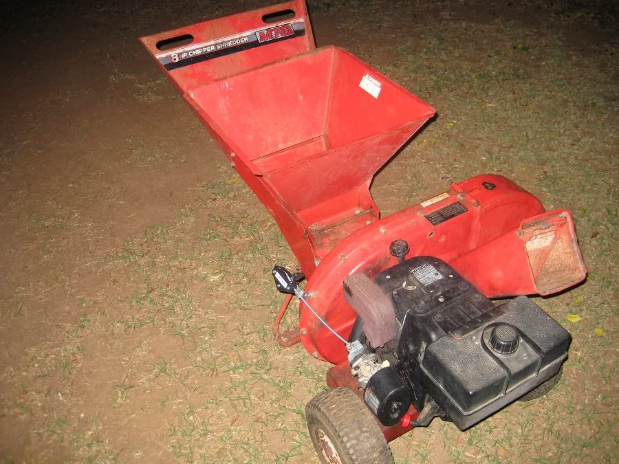

Here are some pics of the MTD unit I was having some carby issues with,

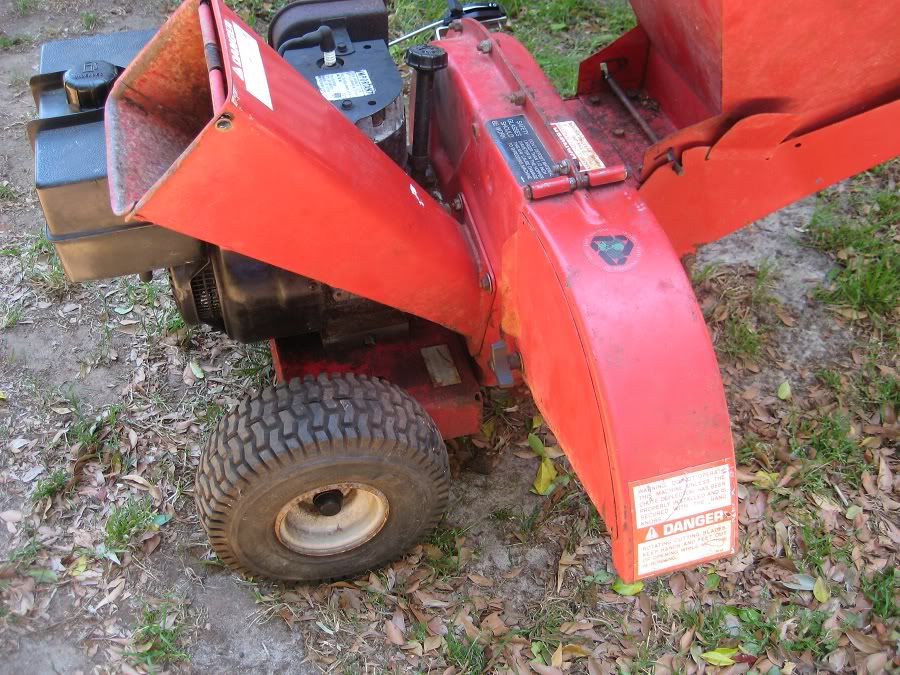

It's an American made MTD unit with a Tecumseh 8HP horizontal shaft engine. They still make a similar unit from what I have been able to see. It now has plastic shutes. This one seems reasonably well made for a domestic unit. The shutes are all steel, pneumatic tyres, wheel hubs have grease nipples. According to the stickers on the machine the branch shute at the front takes up to 2 inch branches and the main shute advises up to half inch.

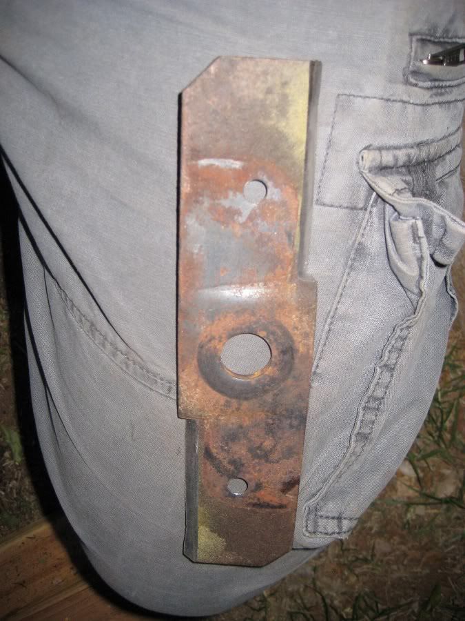

I removed the large shute blade today for a quick sharpen. The blades which chip branches are still quite sharp.
I I shoved a piece of 70 by 38 into the waste shute to lock the cutting disc so I could remove the blade. They were an absolute pain.
The model number is 242A648-000 I'm guessing it's about an early 90's model.
Al

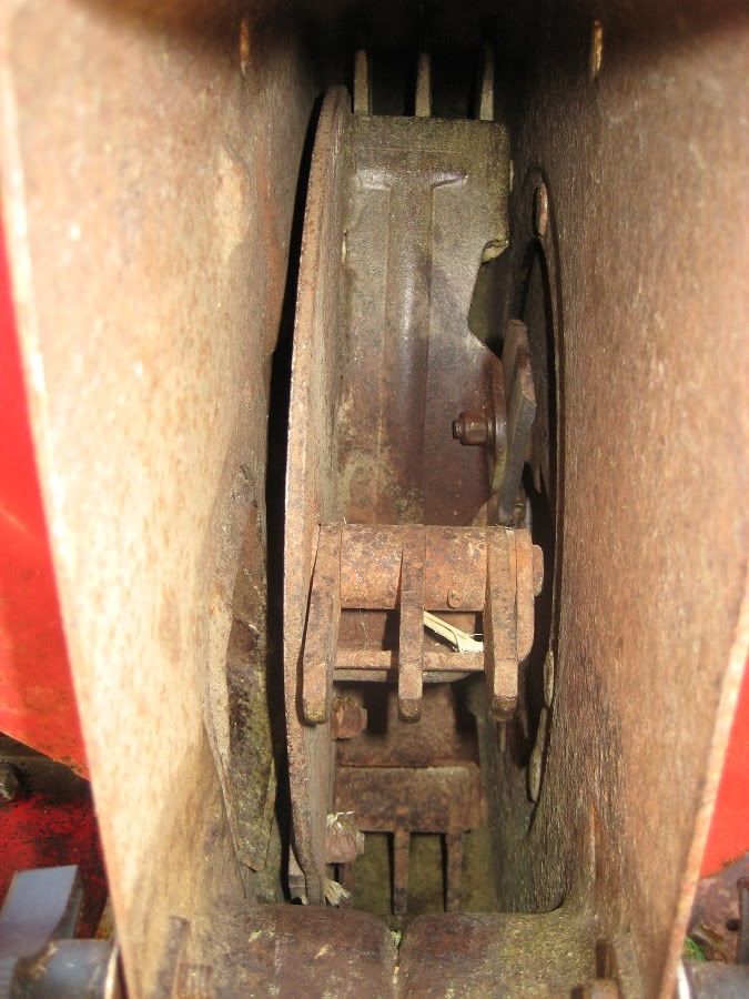

Would love to see pics of the chipping blades setup.
How thick is the housing.
That front blade is for braches, is that the only blade??? Then just the vane things on a flywheel type thing.

There is the blade I sharpened yesterday and then 12 of what I think they call floating hammers which you can see in the pic. The chipping shute has two 3 inch blades which you can see mounted to the other side of the disc
You can see the bolt which retains the blade I sharpened yesty.
and the chipping blades

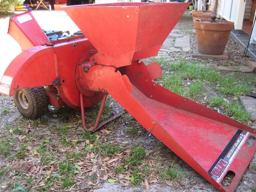

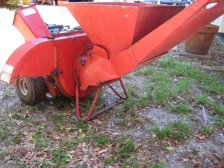

And the odd tilting shute for raking leaves and twigs directly into

Strange that there doesnt seem to be any sort of mandrel for the hammers. I assume that the blade on the face at the inlet chute is enough to get it all happening and the flail action of the hammers finishes it all off.
Is the disc meant to be kinked like that where the chipping blades are???
The housing does not look to be very thick.

I like that sweeep up off the ground idea, even if it probably doesnt work as well in practice and the theory would suggest. Do you put stuff on it then lift it up and let it fall in???

The metal of the housing is 2.5mm thick. There is a similar kink for the other chipping blade so I'm guessing it's meant to be there.
I haven't used the drop down shute but when I drop stuff in there it seems to get sucked in. The section just before the blades is flat so there is no continuous slope to the blade. So I think if you raked leaves up close enough to the hopper they would just get sucked in.
