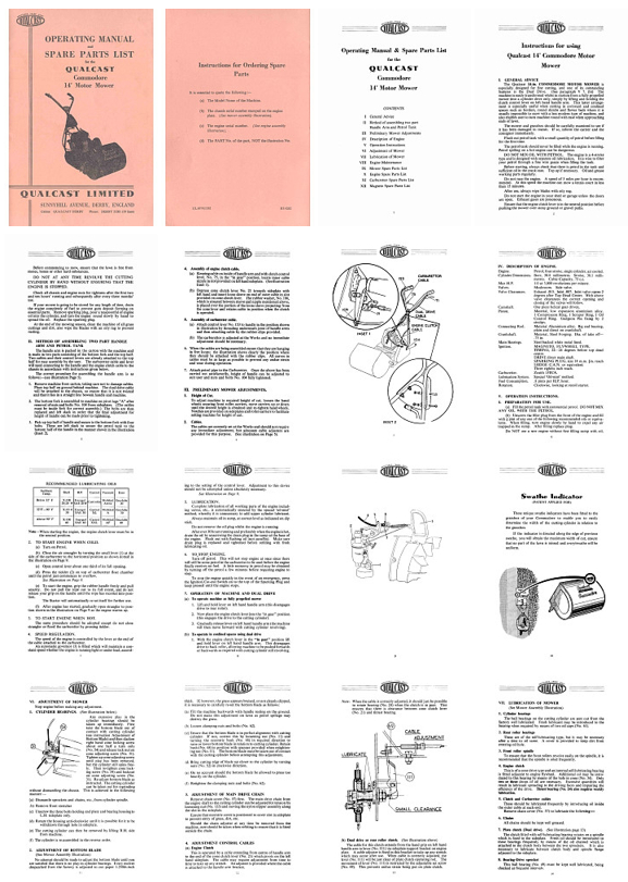

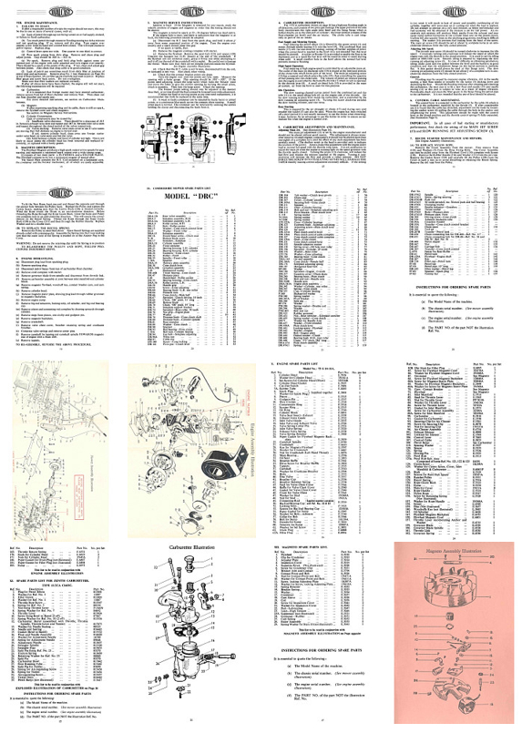

PART THREE - Manual
This manual comes courtesy of the Old Lawnmower Club.
It’s a large manual dating to about 1962, and covers operation,
maintenance and spare parts. Part 1 covers operating and
maintenance; Part 2 covers spare parts.
QUALCAST COMMODORE MANUAL PART 1
QUALCAST COMMODORE MANUAL PART 2
