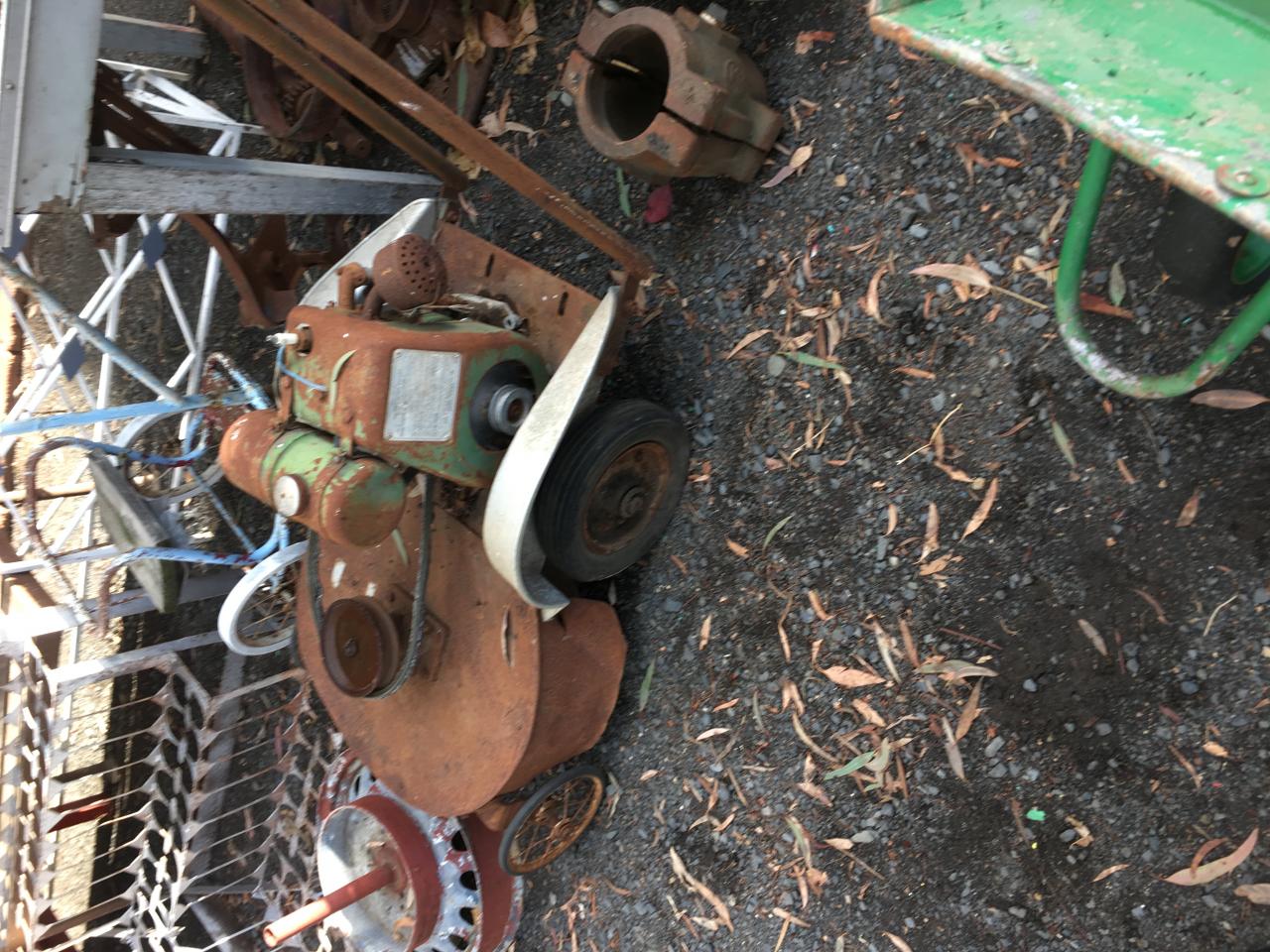

Picked this up from an oldwares store yesterday, has a villiers mk10 engine, not sure if this is the correct engine. Any help correctly identifying would be appreciated.
Likes: 308
Hello Lorenz
Welcome to these great forums.
This is a Whirlwind Rotary Scythe.
This one does not appear to be self-propelled - meaning
it's probably 20" or 24".
I would think the engine is original.
I note the PTO side is on the RH side on your machine.
That is entirely possible given these were sold over a
longer period of time - 1950s and 1960s.
Front wheels are not original.

Those front wheels are off a pram!!

Also the reason I thought the motor isn't correct is it's holes don't line up with the base, maybe it's missing an adapter plate or something ?
Hello Lorenz and Mowerfreak
I wish I knew the answer to that ...
There is evidence of a plate to mount the engine ...
It appears that it was designed to keep correct belt angles.
I have never seen a Whirlwind with a RH PTO.
Any ideas welcome.

Worked out why the PTO is on the other side someone has sat the engine on the wrong way. I'll make up an adapter plate to achieve similar angle for the belt as above.

Hello Lorenz
That is funny - but understandable.
I think you have solved it.
The original adaptor plate appears to have been cast. But who knows?
Perhaps it was two steel plates welded together to get height and angle.
I guess the ideal centre-line would be between the crankshaft and
the centre of the drive pulley.

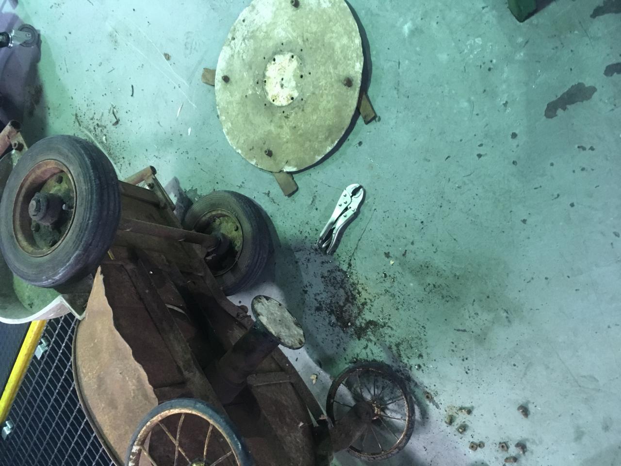

Got the old villiers engine fired up runs well now has plenty of compression and starts first time everytime. What material is the cutting disc on tte slasher you've been posting photos of? Mine has an alloy plate was wondering if it is original or not??

It is highly unlikely the blade holder is original.
I have not found an 'original' machine that did not have rigid 'sickle' blades.
The early set-up was bar holder with rigid triangular blades.
There was no need for swing-back blades, given shock protection was afforded
via the belt drive.

As CyberJack has said, that blade plate setup has been cobbled up by a 'previous tenant'.
The Whirlwind slashers all used sickle bar hay mower 'knife segments' for cutting blades AFAIK; the later models went to a triangular blade plate, with three knife segments bolted to the vertices - as mentioned in those ads Jack has posted.

Jack just another question I'm assuming the diameter of the cutting blades is 20" ? Just so I know when I fabricate a cutter for mine.
Thanks for all the great advice so far
These machines were made in 20" and 24".
The 26" machines were self-propelled.
The diameter will be the tip-to-tip measurement.
If you fabricate a bar holder, the tip-to-tip will include the blades,
as in the image above. The stepped down bar holder was designed to
protect wear on the holder bolt heads.
Triangular blades are still available.
However, I'm not sure whether the original holder on your machine
was a steel triangular job, with same triangular blades.
I see no problem with fabricating a bar holder for swing-back blades
of your choice - if you would prefer that.
