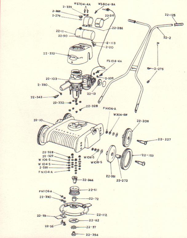

I note that my brochure shows a similar machine:

I can only say this is new territory, and put in my two cents' worth...
The photo you show is an amalgam of an ad and a separate maintenance
manual. The brochure suggests an above-holder spring clutch. The
maintenance manual photo suggests a below-holder clutch. A non-hex nut
is new to me. Is that a brass nut?
It may be that Ogden did change the blade holder design, taking into
account another source: the Ogden Story book (that you also have).
All sources suggest to me a conventional RH hex bolt.
In any case, the issue is, I guess, left or right hand threads?
My understanding of the clutch design is that this bolt does not,
and could not, connect directly to the crankshaft. The bolt screws
into the female-side of the clutch. The male side of the clutch is
secured by another bolt (or boss) to the crankshaft. The maintenance manual
does not hint at a LH thread.
Did other makers use this clutch system?
The answer is 'yes' - but with a twist (pardon pun).
I know that both Whirlwind (Sabre) and Pye-Tecnico (Automotion)
used a similar arrangement, but with a rigid bar blade, rather
than your rigid blade-on-disc system. Here is the Tecnico system,
with the spring clutch below the blade:-
I guess this doesn't really help, Paul.

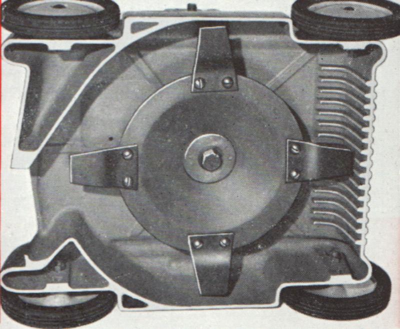

Paul, can you explain this to me ...
its the 'baffled ejector opening'.
Is it 'impossible' to injure your foot?
Posts: 988
Likes: 7
Sorry for the late reply Jack, a child probably could wedge their foot into the chute opening
Here is a pic of the full under-body.
Nice and clean under there, I don't think this machine did much work.
Hi Paul
It's in amazing condition!.
I now understand.
There is a stopper there not shown in the brochure.
