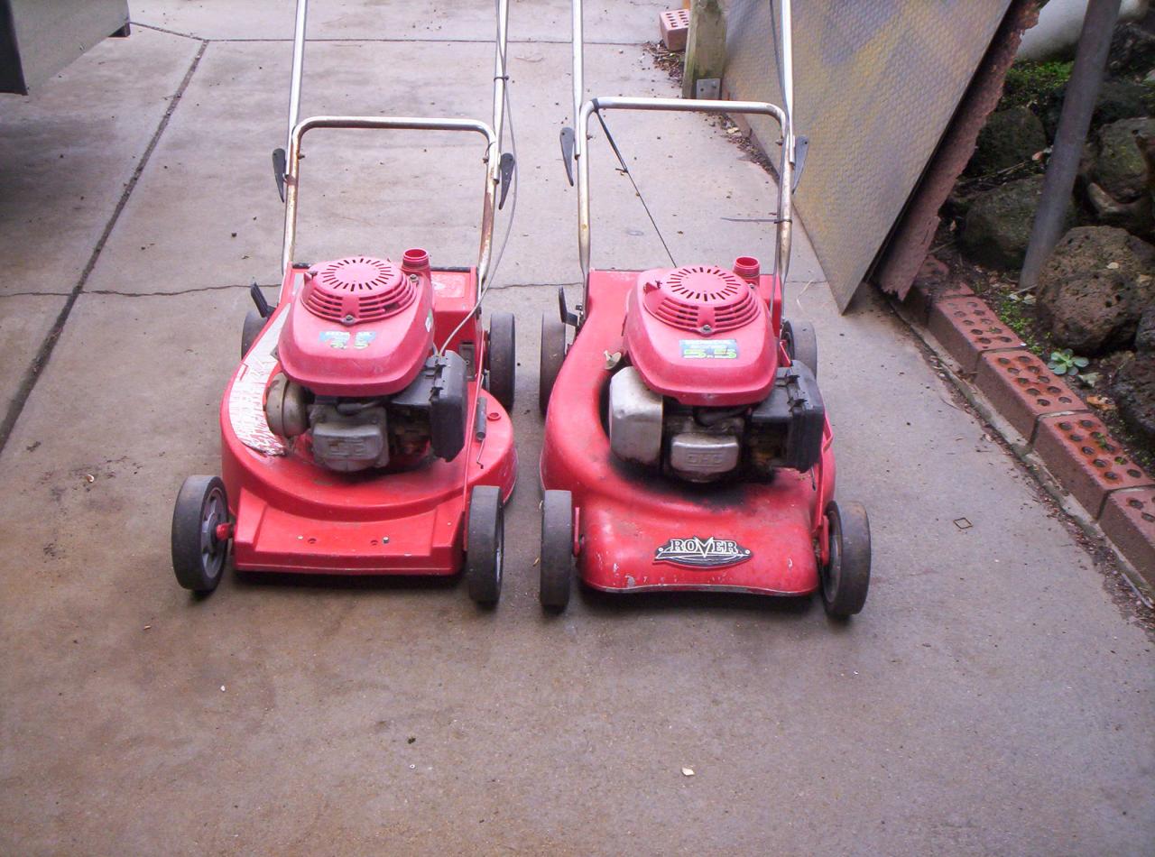

These are the 2 Hondas my mate picked up for me from an old mowing contractor who said they were just worn out. If I ever found a Briggs with oil in it this clean I would be stoked, so I'm not sure why the motors would be worn out
G'day Norm,
They are both GCV series OHC models, not the 'commercial duty' GXV pushrod OHV engines.
With belt drive to the camshaft, which is prone to jumping a tooth or two - and this of course tends to render them a bit gutless...

Your saying push rod is actually an advantage here?
Next you will tell us side valves will be the next big thing on mowers.
A friend was recently given a flash looking Victa with Honda and I was thinking wow, this one is ohc.
Maybe that's why he has done nothing with it and let it sit in the elements, while he uses his domestic Lawnkeeper by Victa V40 four stroke or his old banger Honda ohv mower to do people's lawns with.
Most definitely. Honda has designed the GCV's for the domestic market, and taken a few shortcuts to lower the price in the process.
Nah, but I was thinking about spruiking the 'F head' [i.e. overhead inlet, side exhaust valve] design, though... cool
AFAIK that one hasn't seen use in small industrial single engines, only multi-cylinder car engines.
Not at all unlikely, that.

Hi Gadge, is there any simple way to check it the cam timing has jumped a tooth, I'm not going to waste too much time on them if they are problematic
