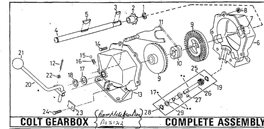

Hi new here. Has anyone any experience in repairing the rover colt gearbox. Its the very basic forward neutral reverse box with hand lever. Mine pops out of forward and can be held in gear but very annoying. I havent pulled it apart yet. Any help would be great.

Hello rudes,
Welcome to these forums.
There is a small ball and spring (15 & 16) that works on a detent in the gear lever.
This is sticking or lever (11) is worn out.
I will check to see whether these boxes are serviceable
and let you know.
Hope this helps

Thanks heaps Jack. I have the red rover colt 5 and the blue rover colt major. Both have the same gearbox. These gearboxes are an amazing design and for their age and hours of use I have always been impressed with the abuse they can take. The gearbox now bangs out of forward position even when I try to hold it in gear. I have seen part 10 in the second drawing somewhere for sale so it makes me think it might be the problem. Will know for sure when I get it apart.

Hello Rudes
Yes, I've seen that too, although I feel that slipping out
of gear could also be the selector fork being worn.
I have been doing a bit of searching on that, but with some
interesting results. This is the story so far:-
A site dedicated to Gilson Snowthrowers gave me some hints:
They identified the box as a Foote 35 Series. I know these
boxes were used on various types of machinery and are a very
good design.
The site said, "Foote is now part of DANA and they no longer support these.
But here's some good news, a company has bought rights to the Foote 35 design
and they are now available here."
The company is Powertow: who make aircraft tugs for small aircraft!
These are the relevant links:-
http://www.gilsonsnowblowers.com/snowparts2.html
http://www.powertow.com/Transmission-QuickSilver-3500-_p_93.html
