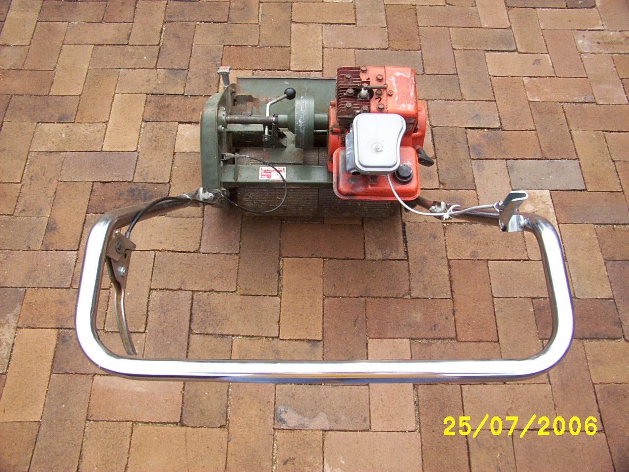

Just to throw a spanner into the works about handlebars, there was also this setup on the Scott Bonnar's. ![[Linked Image]](https://www.outdoorking-forum.com.au/forum/uploads/usergals/2014/11/full-1214-18294-802.jpg) The throttle setup isn't original as it was missing when I got the mower, however there are mounting holes for a similar setup.
Posts: 2,998 Likes: 16
Ahhhh,
Those good ol' Pram handle bars. I'm not so sure how they came about. I know all the Blue Lawn King 45's had them and my Father In Laws green model 45 had them as well. They could've simply been an option, I'm sure DeeJay would know more about them.

Joined: Oct 2005
Posts: 42 Likes: 1
Hi BB I'm not 100% sure if the handle bar setup in my picture was original fitment to that mower. It could of been off another model?? I still have the Model 17 Supercut, but now has a Briggs on it. The BSA engine on it in my avatar was just to heavy to use. It still gets used once every month or so. Not the easiest mower to turn around but still easier than the 30" Queens to use.
