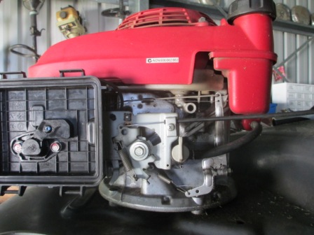

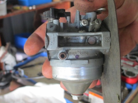

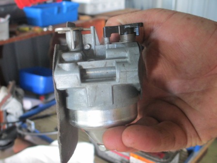

Hi Grumpy, yes that is what I was talking about when referring to the timing, checking that the two marks on the camshaft sprocket lined up with the cylinder head surface, all lined up. With the carby I stripped it completely apart and blew it out with an air compressor. I have sent a couple of photos of the carby as well, could you tell me if this is the right one for this mower as it seems back to front compared to other carbys I have played with on Hondas. The compression seems to be fine as I have been told if you spin the motor backwards it will kick forward on compression stroke, which it will. Again is this true or not.[Linked Image]
paul.foot #56667 25/06/14 06:38 AM

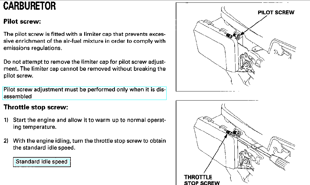

The correct carburetor for that engine is a Keihin BB62. I can see from your picture it is a Keihin BB, so I doubt it is the wrong one. The BB does have its idle channel, and its adjustments, on the opposite side compared with the BE used on the GXV (pushrod) engines. See illustration:
When you cleaned the carburetor, did you clean the idle jet? It is located below the vertical screw-in plug just forward from the idle mixture screw (which is locked to prevent adjustment)? It is not removable, so it is a bit tricky to clean. Even more importantly, did you remove the emulsifier, which is above the main jet? Both of those parts are very vulnerable to fouling on that carburetor, and moderately difficult to clean. The symptoms seem quite a good fit for a gummy emulsifier, and it cannot be cleaned in place, it has to be removed from the carburetor.

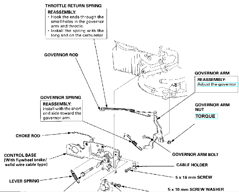

Sounds like we need to review the governor then, Paul. Can you post pictures of it please: the governor arm, top and bottom. The top view should show the link from the governor arm to the throttle, and the anti-surge spring around the outside of the link. The bottom view should show the governor spring, attaching both to the governor arm and the speed control lever.
grumpy #56688 26/06/14 04:13 AM
Joined: Jun 2013
Posts: 173

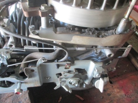

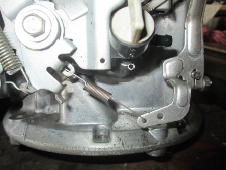

Hi Grumpy, tried to get a few photos for you but camera decided to go flat. Only got 1 at the moment but will get a few more for you as soon as I am able to tomorrow. [Linked Image]
paul.foot #56695 26/06/14 09:57 PM
Thanks Paul. As well as verifying that it is correctly assembled, I want to check that the linkage is not fouling against anything. Once in a while the top of the governor arm gets bent inward and rubs something, which damps the system response.

Hi Grumpy got two more photos for you to look at, hope they are what you are wanting. ( sorry, had to charge camera, as they say if it aint one thing its another). Read what you said in your last post, governor arm doesn't seem to touch any were on or near enough to motor to rub. Hope its okay but went ahead and took motor off base and started to strip it down. (getting carried away) [Linked Image]
paul.foot #56701 27/06/14 01:32 AM

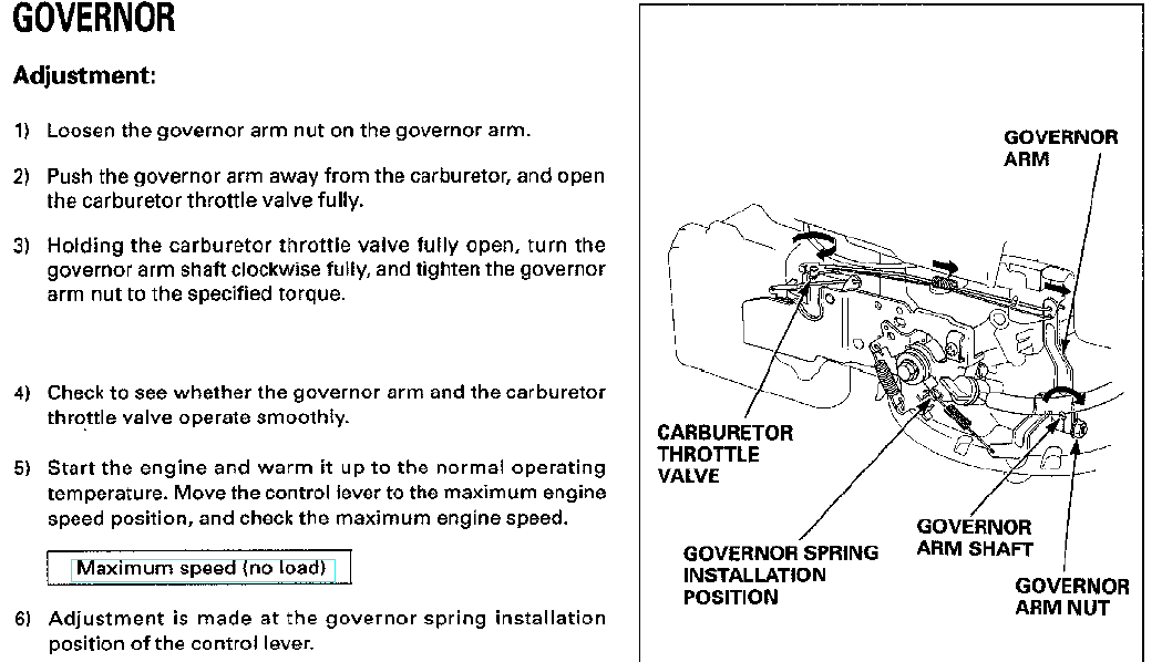

It isn't easy to see from the pictures. Here are the instruction illustrations:
If you follow the instructions there, and check what you have against the drawings, we should end up sure you have it right.

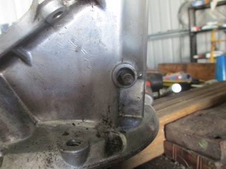

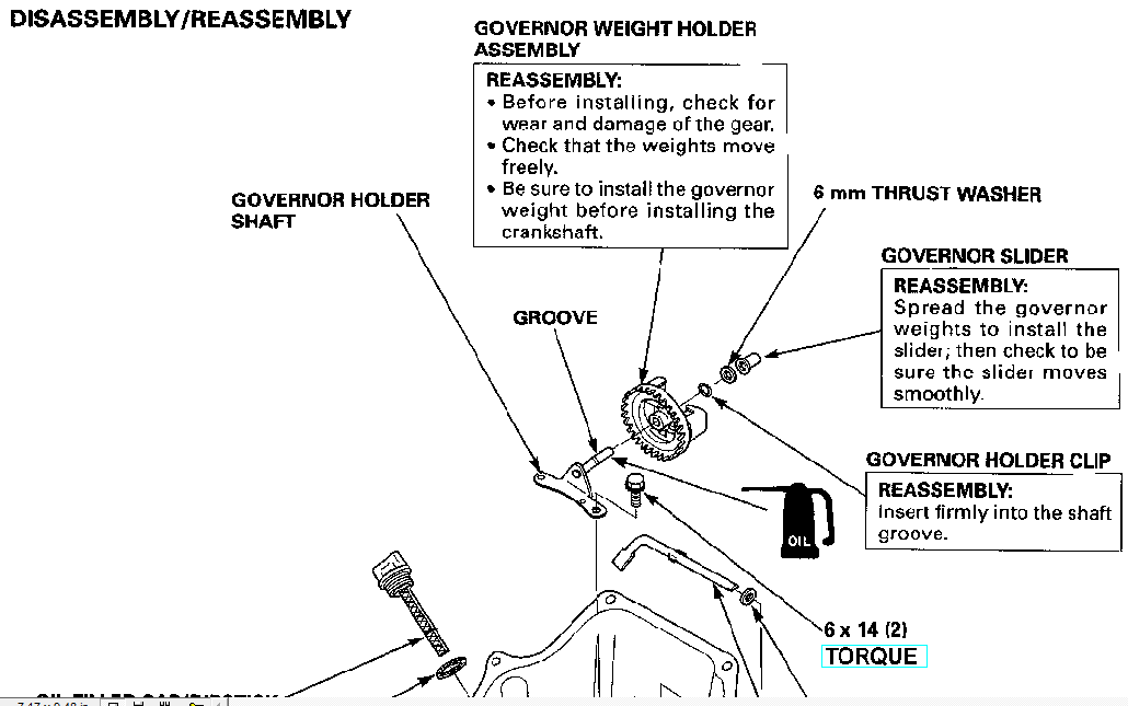

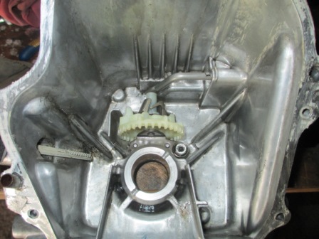

Hi Grumpy, have had a look at governor arm, spring etc.and it is all good. Have since pulled motor apart. I found a lot of gunk around the governor arm that goes through the crank case, could of this been a slight problem as to the governor not opening properly. Photo 1. I also found a small thin washer in the motor I know it comes from same governor arm (found them when I pulled a motor a part for spares). Without this washer could the lugs for this arm been slightly catching on crankcase and slowing governor for opening properly. No scraping or marks found though. I also found a lot of gunk around the shaft that drives the governor arm, the part that goes in and out, could of this also contributed to governor not opening properly. Photo2. [Linked Image]
paul.foot #56708 27/06/14 06:21 AM
Here is the assembly instruction for the governor inside the crankcase. Let's see if yours is correctly assembled, and where that washer should be. Also, while I think it isn't very likely the governor shaft could stick, I think the slider and centrifugal weights could do so fairly easily.
You should also go through the process for adjusting the rotational position of the governor lever on its shaft. To do this you loosen the clamp bolt, pull the top of the lever fully to the right (so the throttle is wide open), hold it there, and rotate the governor shaft clockwise as far as it will go. Hold everything in that position, and tighten the clamp bolt. Don't overtighten it.

Hi Grumpy, check the mower parts against the supplied picture, and its all good. Hoping I was right about the washer I found, and I was. Put it all back together, double checking as I went. Got motor completely back together, double checked governor arm as you suggested. Double checked everything again. Fresh oil, new spark plug and air filter, couple of soft pulls just to get a bit of oil every were. On the second actual pull kicked over, now running smoothly from idle up to full revs, even in the thick grass. Thanks heaps Grumpy for all your help (and patience).
