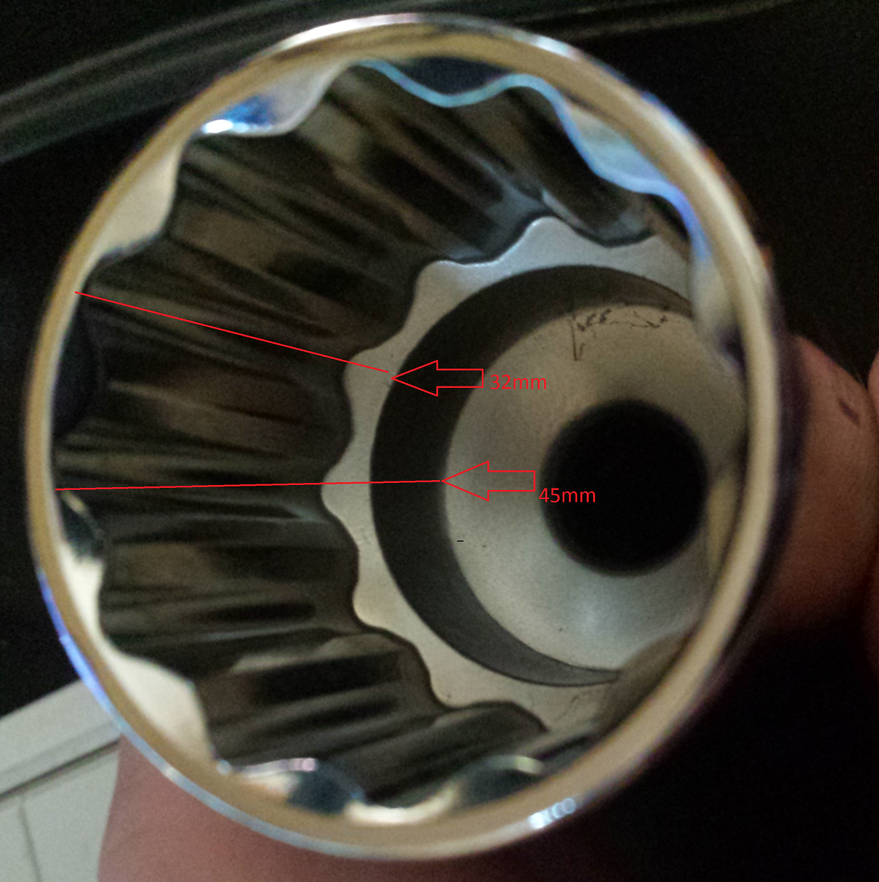

I got a 32mm deep socket would that do its 0.25 mm bigger than 1-1/4
Posts: 6,926 Likes: 10
Is it a 6 point socket, not a 12 point? Will it drop down over the ratchet teeth, so it fully engages the hexagonal part?
The 0.010" clearance due to it being 32mm instead of 1.25", in isolation, is not a fatal flaw, though it would mark the points of the hexagon slightly.
Joined: Feb 2014
Posts: 52
its a 12 point i,m not sure of the height on the dog nut so i don't know if it will clear until i get to the guys house unless someone who has one can measure it the socket i have got is 45mm deep
i was also thinking if it was i little bit loose try wrapping the dog nut with aluminum foil before putting the socket on just to tighten up the slack
thanks
Is that 45 mm deep before the step-down to the clearance hole for a long bolt or stud?
I agree that some shim (preferably hard-rolled brass, about 0.005" thick) would probably prevent the nut from being bruised.
You are doing all the right things and preparing properly, it's just that in your picture the thing looked brand new and it would be nice if it stayed that way. If it were just a run-of-the-mill one that has already been unscrewed with a Stillson half a dozen times, you'd be over-prepared, if anything.
Joined: Feb 2014
Posts: 52
this isn,t the one i,m getting it was just a pic i found as a description of what i was getting the one i,m getting looks like the mower has sat outside for a wile and it,s about 32mm before the stepdown and 45 to the back of the socket
It looks to me as if you'll need all of that 32mm at least. It would be good to have a heavy 1.25" ring spanner in your back pocket just in case. Having said that, I'd be in your situation: the biggest ring I have is only 1.125" from memory, and I tend to handle larger nuts than that rarely. When I do have to, I drag out a heavy old Dowidat 24" adjustable, and adjust it up very closely onto the hex. However back in the days when I had a tractor I found that just wasn't adequate to deliver the torque required, and I had to borrow whatever 3/4" drive socket I needed, for use with a giant breaker bar. You aren't in that situation here: I don't think you'll need a whole lot of torque. If it doesn't come off easily you will need to apply some Penetrene and wait a few minutes, rather than just try harder.
I suggest you take some Penetrene with you.
