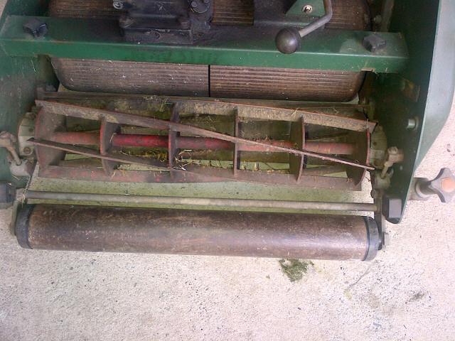

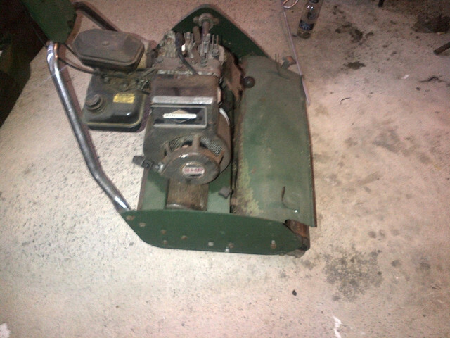

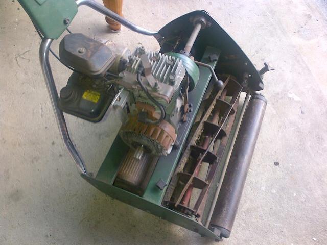

Great forum. I've uploaded a couple of pics of my Scotty. Bought the mower about 5 years ago for $150, it had been sitting outside for years, and was in pretty bad condition, the catcher was completely rotten and is beyond repair. Remarkably I gave it a service, bit of a paint job and she started and has been my mower ever since. Clutch housing has just cracked and the reels need replacing so i've decided to go for a full rebuild as I seem to have an odd attachment to the machine and cant part with it smile.
Id love to know how old the mower is and any advice given for restoration would be greatly appreciated.

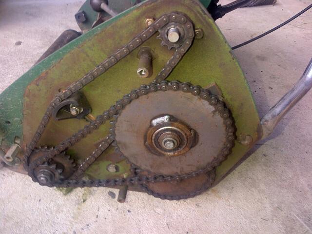

To enable us to help you, we need some more pics of your machine from different angles, particularly the cylinder reel and inside the chain case, to assess the condition of the chains and sprockets.
Is that the original Briggs on the machine?....If so can you please post the complete Model, Type and Code numbers stamped into the metal air cowling that you have removed from the engine...They may be hard to see, but will be adjacent to where the carby intake manifold would be.You probably have painted over them.
These numbers will give us the manufacturing date of the engine. wink
We will also need a pic of the cracked clutch housing.
For now, I can tell you it is a Series 2, twin rail Scotty 45, made after 1975-early 1976 and is a 20" cut. If that is the original engine, with the numbers, we can give you a better idea of the approximate date. wink

The chains and sprockets look pretty good considering the machine was out in the elements for so long,all i've done is kept everything oiled, the drum sprocket is pretty rusty as is the intern sprocket bearing.

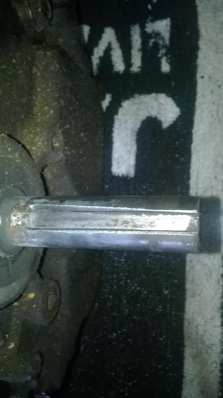

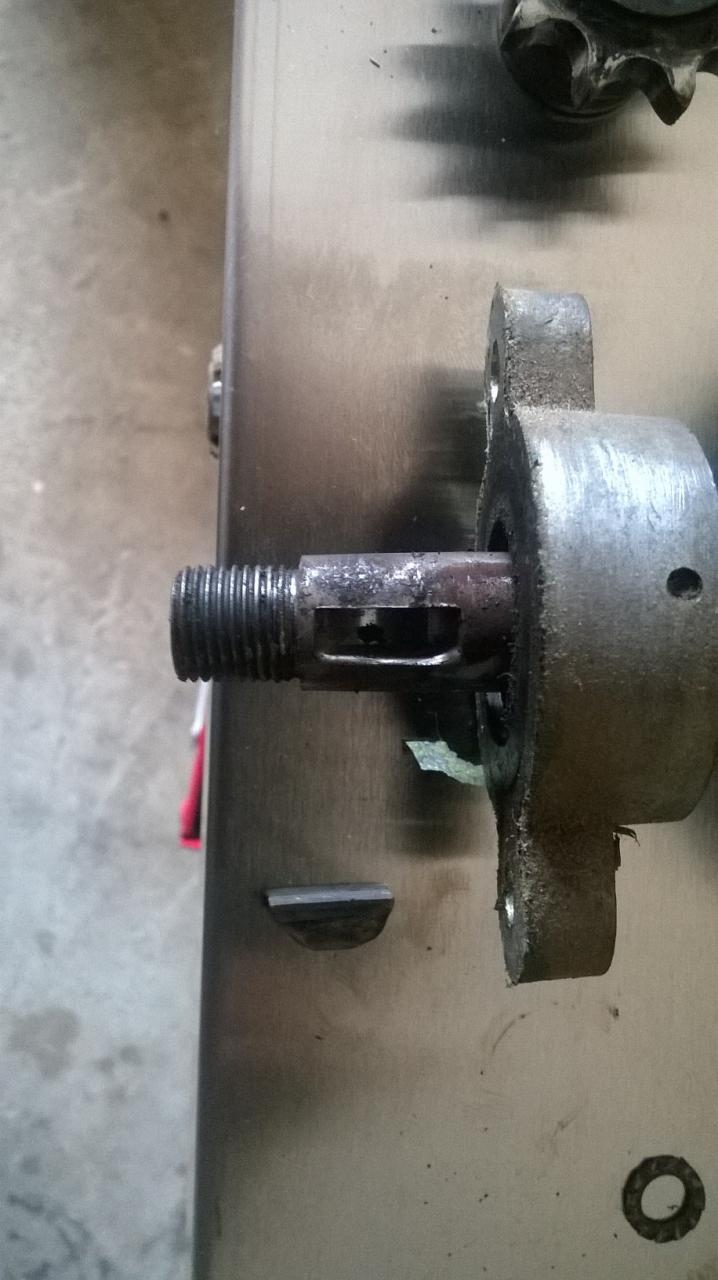

Stripped the Scotty down today.
As feared there is a fair amount of wear on the Briggs Shaft from the bolt in the cracked clutch housing, the engine shaft is pretty bad as well.

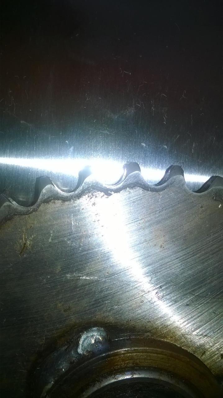

On inspection the sprockets are worn badly and the chains are not that flash.
The bearings need replacing throughout.

I have attached all the pics so far including a pic of everything I need to replace.

Wow, you certainly have your work cut out for you mate, and looking at the parts on the table that you have deemed 'beyond repair' would amount to considerable $$$ to replace, and of course the engine probs...
Just remember, do not throw anything out, you may need some part if one is not available. wink
I have grave concerns regarding the chassis frame alignment, which, for a cylinder mower, is a very important feature, because if the alignment is not correct, the mowing quality will be affected.
If all the spare parts are available that you require, and the frame can be satisfactorily aligned, then this project will reach a good conclusion....once you decide what to do about the engine....repair or replace.... wink
