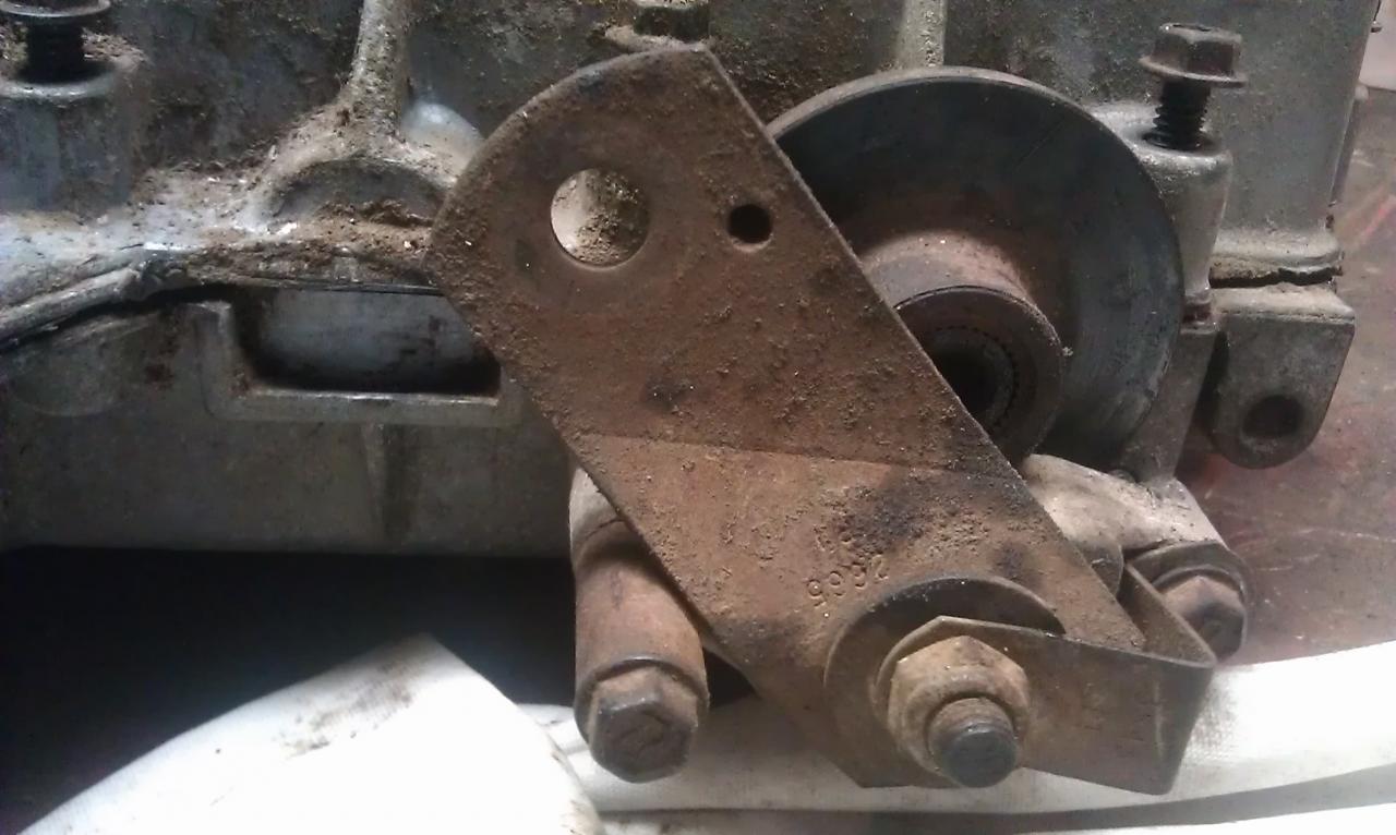

Joined: Oct 2007
Posts: 20
Bruce,
No luck on the model number.
I may have been there at some stage..but not there now... See pic below:

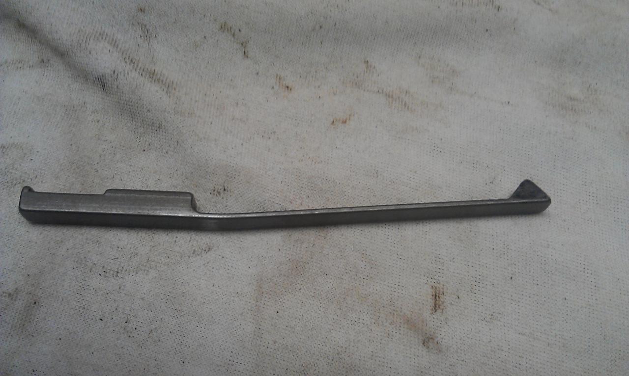

From the repair manual, the keys look like the 792123A. See piture below.
I am less confident that this is the issue now as:
KEY SPRING HEIGHT
To check shifting keys for loss of spring height, place the short flat portion of a key on a flat surface as shown,
measure the distance from the surface to the key tip. The measurement should be from .400" to .460" (10.2-
11.7 mm); if the measurement is below .400" (10.2 mm) the key should be replaced.
In my case they are above the 10.2...
What else could it be???
