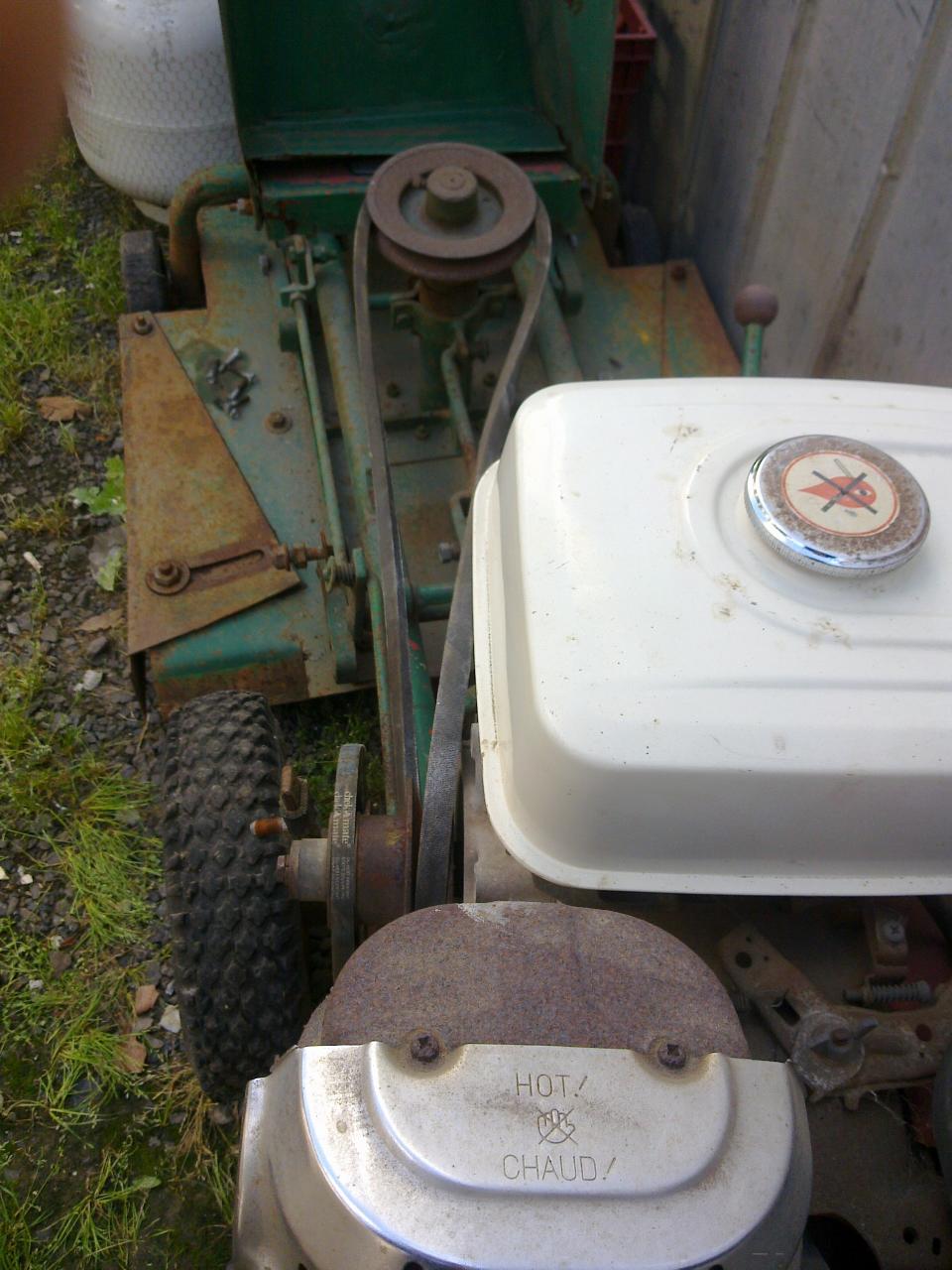

Howdy, I picked up this deck at the local recycling centre for $30. Too good to miss.
It's a 48 inch cut with triple spindles. The left and centre spindles spin clockwise, and the right spins anti clockwise, with centre discharge at the rear. The drive from an engine goes to the left spindle. The belt is a double sided vee belt, (like a hexagon section), so I'd say it's fairly industrial.
Cheers.
The two clockwise spindles are using one side of the belt, and the anticlockwise one uses the other side, so both sides are being used. I've never seen a double sided V belt, though that doesn't mean they are rare. Hope you can get replacements here though, or it would be best not to spend a lot of time finding a use for that deck. Since they only have half as much surface area as a single sided belt, they probably won't last all that long. Note the extreme measures taken in the design to maximise the wrap angles the belt has around the three cutter spindles: this is to try to minimise slip and therefore wear on belt and pulleys.

The red colour, the Agricultural look and the way the cutter system is set out sort of indicates to me that it could be off a sixties Wheelhorse or Simplicity tractor. The decks on these units came seperately as an accessory. Most of these decks had a heavy guage cover plate over the pullies, does it look like it used have one but is missing? The reason the pullies were protected was because you drive the tractor over the deck to fit and remove it. Hope this helps.
Cheers Keith.

There is evidence of there once being a cover over the pulley's, but I'd say that the deck hasn't been driven over to fit, as there is no evdience of tyre marks.
My estimation of age would be approximately 10 to 15 years old, and the guage wheels are plastic.
I take some more pics and post them later, I'll also see if I can get info off the belt.

Here's a pic of the underside. Each cutting diameter is 17 inch.
And here's the belt. Its a GATES HIPOWER 2 DUBL-V BELT, 88136, MADE IN USA, 9ASS, 50.
The rear side of the belt has the same profile, and it would be in between a B and C section belt in width.
Thats a fair overlap its got.

hahaha, I find chinese hunks of junk aren't too bad if the maintenance schedule is more regular. I take your point with the hori engine, I've just got a few verts here that's all.
Yeah, it came as is. Checking it out, it would take the disc's of Rover mowers. I'd just have to make a set of reverse blades. I've got some pretty nice spring steel here that would do the trick.
