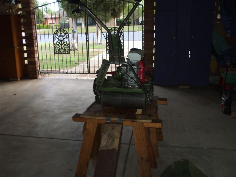

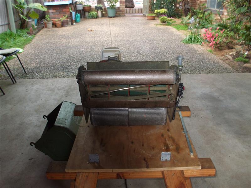

The time has come to do some routine maintenance on my Scotty 45. I needed a raised work area to put my mower on, to make it easier to work on,
so I fabricated one quickly using 2 saw horses with a suitable piece of 5 ply fastened with screws to the horses.
I made a ramp from a piece of timber to get the Scotty on top of my new "table" and, as I couldn't lift it up...I drove it up the ramp under its own power. I used a couple of old right-angle brackets screwed to the front edge of the "table" to stop the machine rolling forward and a wooden wedge under the rear roller to stop it rolling backwards.
Here's a pic...

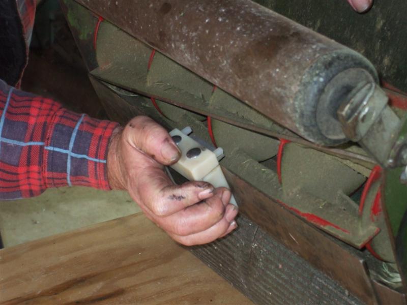

Whilst it is laying backwards it is easy to check the alignment of the bedknife and soleplate with the rear and front rollers using the alignment tool....Here's a pic of the machine laying back exposing the bedknife easily...
Here's one checking alignment ...

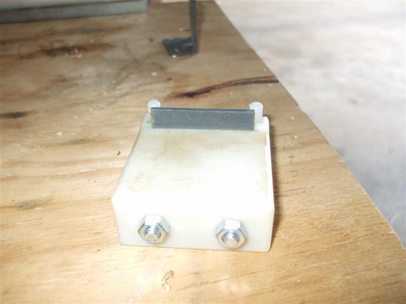

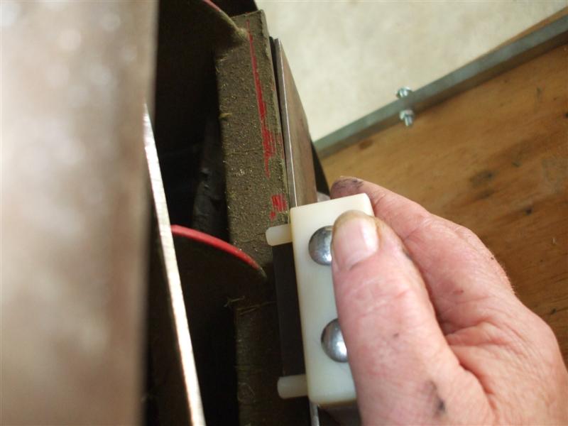

Here's a couple of pics using the "Bed knife buddy"and the tool itself....

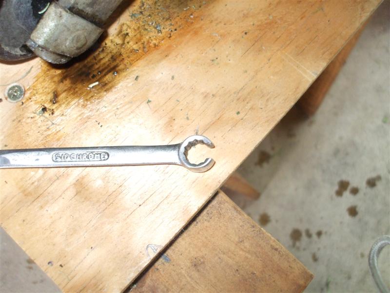

For this I have made a handy tool...grab an old 7/16" ring spanner and grind a slot in the top edge carefully with the spanner secured in a vice using an angle grinder to do the job. Don't forget your safety glasses. wink This makes an open end ring spanner that can fit over the screw threads of the cylinder reel adjusters and the clutch lever adjustment lock nut which is located inside the lever actuating arm. Please see pics...
