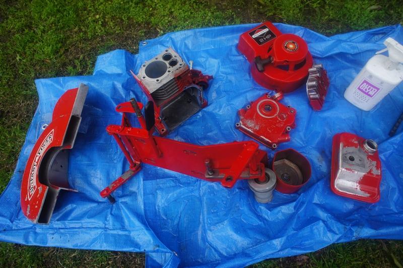

Hi,
I am rebuilding a 1987 Briggs and Stratton engine (on an Edger). The engine was covered in oil and dirt when I took possession of it, as it hadn't been used for about 10 years. I have cleaned the majority of the parts using some Autoglym degreaser, but I am not sure if I should be doing anything else before painting.
Does anyone have any recommendations on the best way for degreasing and preparing the surface for painting?
Thanks,
Cain
