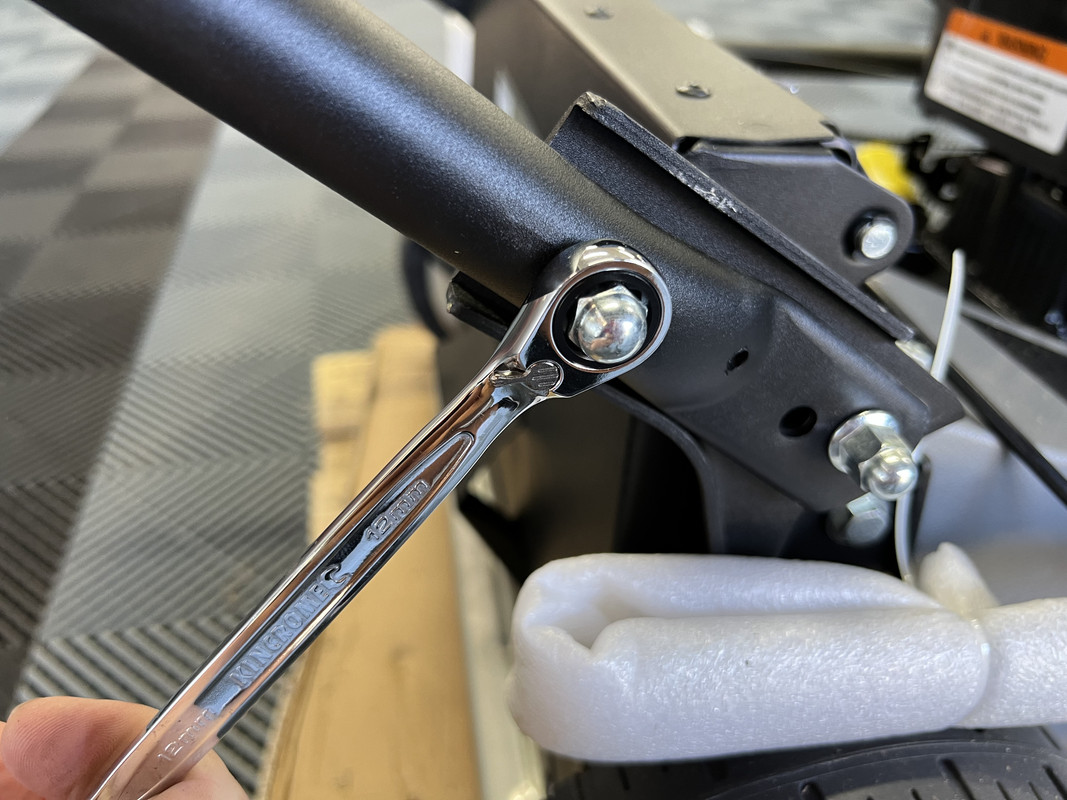

First step after opening and unpacking the box is to install the lower handle, angled side pointing up...........ask me how I know this............ rolleyes
[Linked Image from i.postimg.cc]

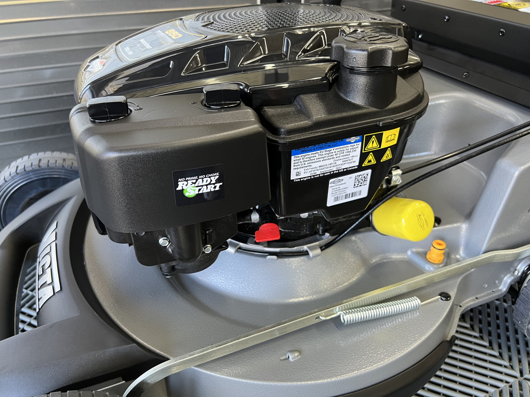

US-made Briggs & Stratton engine, 190cc, cast iron bore, automatic choke, spin-on oil filter and 11.5 Nm of torque -

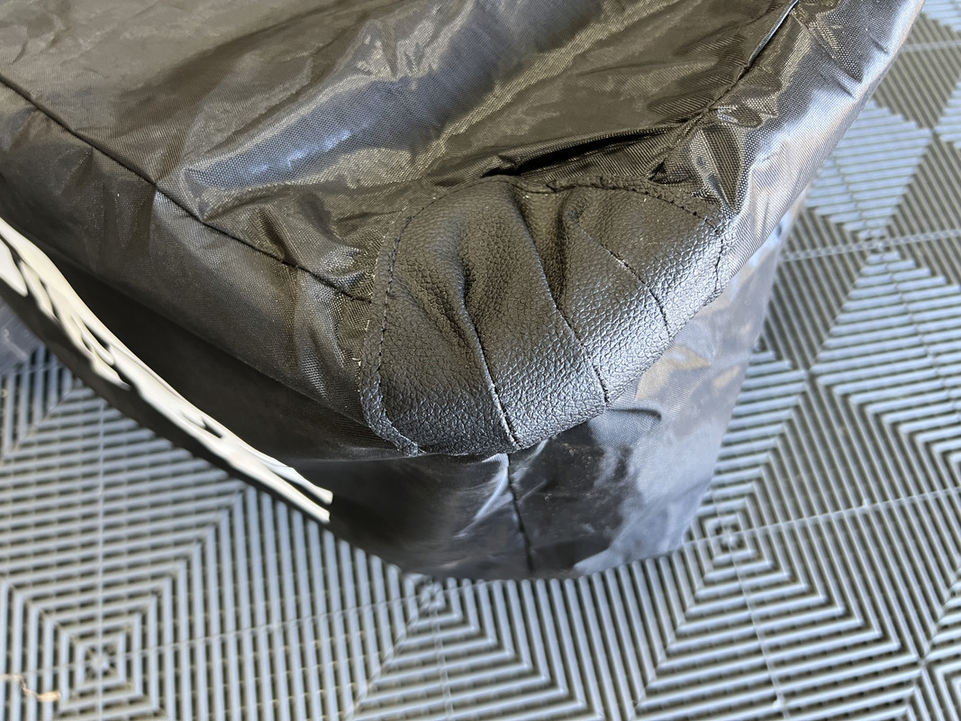

50L fabric grass bagger with heavy duty steel frame, double layer dust deflector and leather wear points on rear corners -

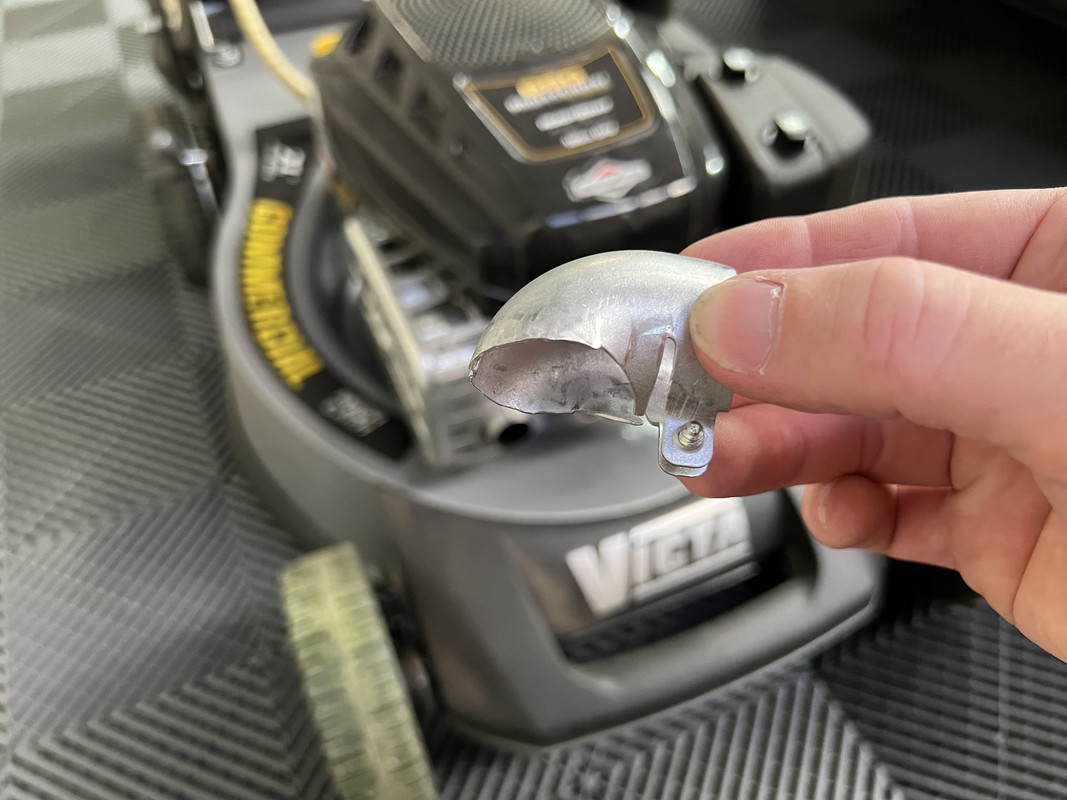

Missing from the spec list is a zone starter mounting, which I remedied with a clip I had in stock. Compared to Honda engines, the Briggs has a long enough rope to make this possible -

As I did with my Mulchmaster, I decided to wrap the handles, the same stuff used on road bikes. In this case, the wrap is protecting the paint on the handle as well as providing a softer grip to grab onto. This stuff is readily available from bike shops or online, mine was from Amazon. I typically get a couple of years out this type of wrap tape, but its easily applied and removed.
https://www.amazon.com.au/dp/B07B21JF1R?ref=ppx_yo2ov_dt_b_fed_asin_title&th=1

Just like the ceramic coating, the next "modification" is completely pointless, but oh so necessary for my enjoyment. grin
Yes, that's a muffler exhaust tip! Briggs and Stratton fit these depending on what the customer is asking for. For example, a lot of Masport's with the earlier version of the 850 came with one as standard.
The one on my Mulchmaster has been on a few mowers now, I grabbed it off a Masport before I traded it in.
Briggs and Stratton also sell these as a spare part. There are now two versions of this tip, the earlier example above has a smaller diameter outlet, the latest is much bigger and fits the newer engines. This larger version will also fit the domestic engines with the QPT muffler, mostly the 163cc variants.
Briggs & Stratton Part Number - 594563

When I first took delivery of the Victa Commercial 21-inch, I filled the engine with the recommended SAE-30 mineral oil.
Having outlined the "No Oil Change Required" above, that actually doesn’t apply to the 850-series engine. I would suspect that relates to these engines being primarily for commercial users, meaning they are being used far beyond the average domestic lawn mower engine. As such, Briggs recommend the first oil change on the 850-series be at 5 hours of use, then every 50 hours or annually going forward. The oil filter replacement is also at 50 hours.
After the first oil change at 5 hours, I go a bit more conservative in doing oil changes at 25 instead of 50 hours. I would normally switch to 10w-30 semi-synthetic at the first change, but I've decided to run SAE-30 mineral for another set.
For oil filters, I do them every second oil change for a couple of reasons. Firstly, the filters are $20 each, which is quite expensive for such a small filter. Secondly, I just don't see the need considering the frequency of oil changes.
Engine Oil Capacity – 540 to 590 ml (wet fill)
Oil Filter P/N - 795 990
These engines can be drained from above or below, but I have always drained them from the dipstick tube to avoid taking off the blade carrier. I've recently invested in an oil extractor to hopefully make oil changes quicker and easier.
Either way, make sure to clean around the dipstick tube beforehand, which you should be doing anyway when checking oil levels. All waste oil is put in an empty bottle and disposed of at the council collection point. I actually rinsed the mower down prior to the oil change, the ceramic coating easily shed the dust debris that was clinging to the deck. See, there was method in my madness! grin
Once drained, the mower is flipped back up and the new oil added, reserving about 100ml. I then check the dipstick, adding the final 100ml in steps to the correct level is achieved. If the oil filter is changed, make sure to check the oil after a quick test run and add more oil if needed.
As a way of keeping track, I put the date on the oil filter to indicate when the last oil change was.
Something I only just now realized, the 850 engines fitted with an oil filter actually have Pressure Lubrication with an oil pump instead of the splash type lubrication on the rest of the Briggs push mower engine lineup. I've had a few 850's over the years, some have come without the oil filter, some have, including this Victa and also my Mulchmaster. I thought I knew everything about these engines, clearly not.

Despite appearances, the above and below image is before I started cutting. The technique I use is to blow all of the leaves from the gutter and paths onto the lawn, in the process clearing a path around the perimeter to avoid the mower blowing leaves back onto the pavement. I then get to it...............
The machine has no problem packing the catcher full. I have found this particular fabric catcher to be harder to empty than Bushranger's similar arrangement, the opening isn't as wide and requires quite forceful shaking to empty. The lack of a rear handle really hampers your progress here.
