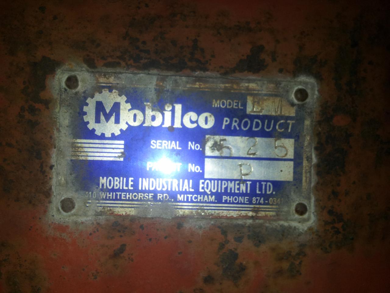

Hi greg first all before i throw some fuel on the fire. i would like to say thankyou for all the info and pics u have gathered and listed here as it has made me become a member. Because like u i have been trying to find info on this ride on that i required a couple of years ago.
Well here comes the fuel for the fire. I seem to have according to the stamped serial number 525 model EM in orange with a Tecumseh engine? Which i am guessing is the next one of the line after yours.I will see if i can see a date on the tyres tomorrow. But i was wondering do u know how much this would be worth restorted? It is missing the mowing deck due the person i got it off took it off because his kids used it ride around the yard at there holiday house.
