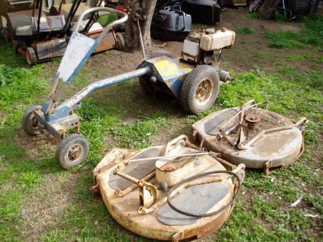

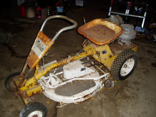

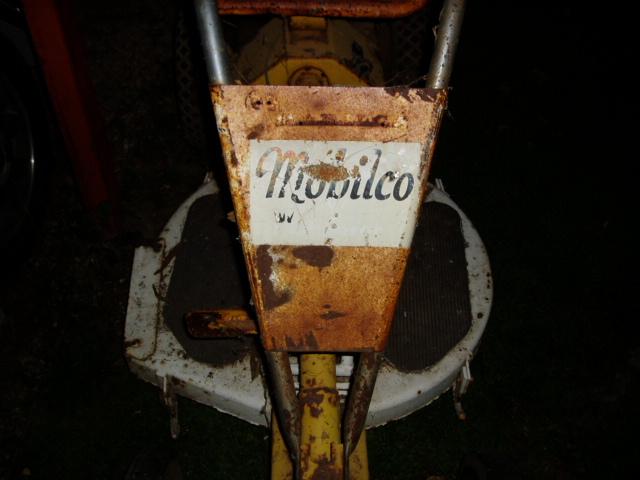

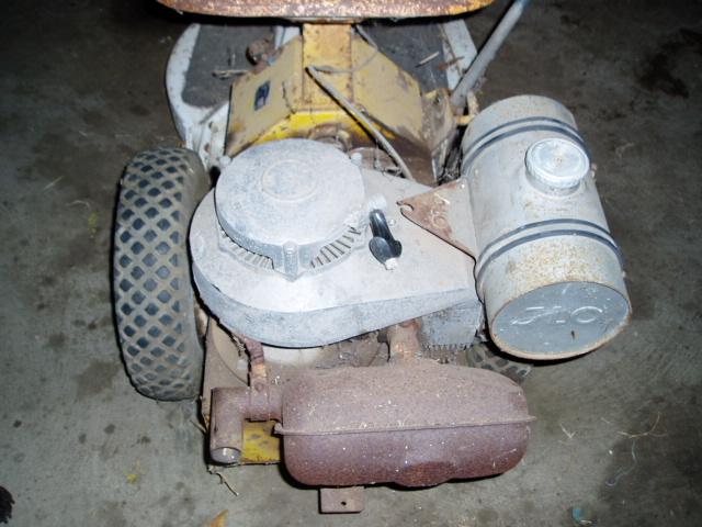

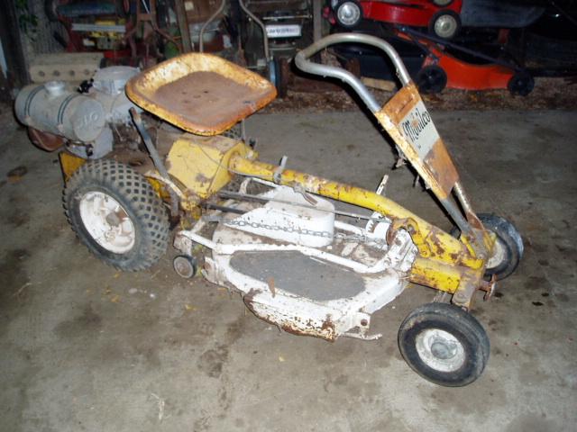

Hi, this is my first post here. Been buying stuff from Outdoor King for a while. I must say, Great Service.
I need some help here. Not so long back, I bought a ride on to restore to it's former glory, but I haven't been able to locate any info on it. It's a Mobilco 'Emperor', 24 inch cut, and it has a JLO, (German), 2 stroke engine. I'm actually in the process of restoration now, but would love to talk to someone who knows something about it. I've also managed to get hold of a second one, in pieces.
I've attached some pics of it.

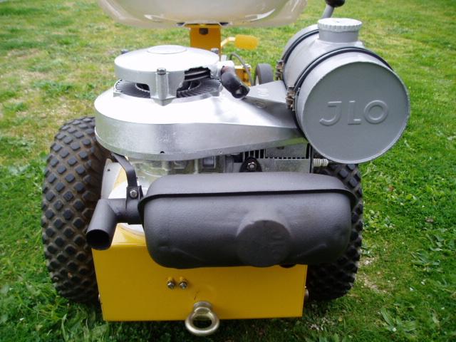

The engine, the "JLO", which is actually "ILO", (JLO is a stylised script), was manufactured in Germany in 1965, (engine is date stamped). It is a L197L engine, with a 198cc capacity that produces 7kw, (9.5 hp), at 4000 rpm. It appears that this engine is what was originally fitted to this machine, as the adaptor plate has been professionally made and incorporates additional threaded holes that allow the engine belt guide to be bolted through the punched holes of the chassis into the plate. Another reason that supports this, is that the Ariens drive plate and pully, require a specific design of the crankshaft, which this engine has. My research to date has revealed that Ariens are the only company that provided modified crankshafts for their machines, and modified crankshafts were not produced by the engine manufacturers.
ILO motuerwerken Germany, was purchased by North American Rockwell in 1959, and traded as ILO Rockwell until 1969. It was then that all reference to ILO was dropped. These engines were predominately used in snowmobiles, etc. Hence the availability of this engine in North America. New parts are no longer available for this engine, and there are only limited sources of second hand parts.

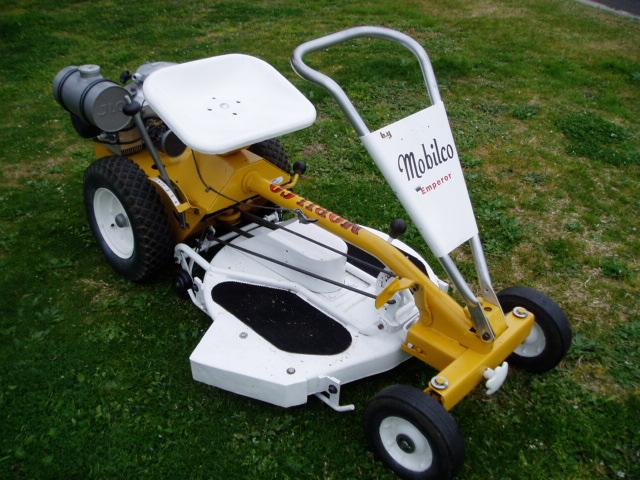

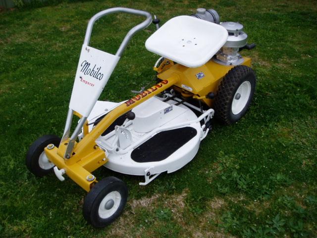

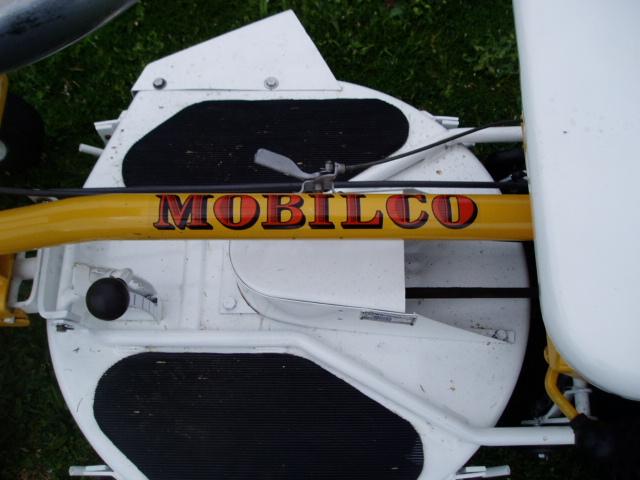

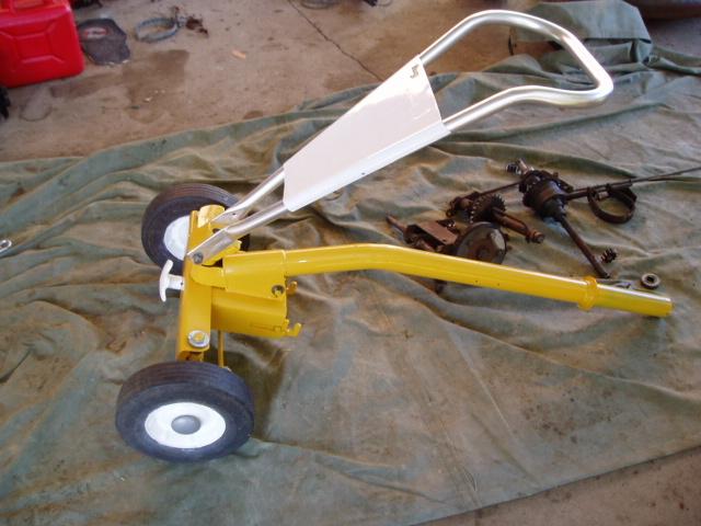

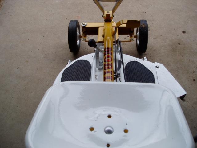

Here's the first installment of photo's now it's finished. In the photo showing the front of the handle bar, you can see a small, copper coloured badge saying 'by', just below that there are holes for another badge. Before restoration, you can just make out the letters, _,_,B,I,L,C,_. So there was obviously a diecast metal badge saying MOBILCO.
The new MOBILCO decals I had reproduced from detailed photo's of the old. It is worth noting that the 'Emperor with crown' symbol is identical to that used on the Ariens Ridline Mower.
Most impressive, Greg. The only point that caught my eye was the housing of the recoil starter, which seems to have a chunk out of it. I don't know where you got the bits to make the whole machine look so original, but you've kept its proper look of simplicity - it takes me back to the good old days. Not a hint of a Carmen Miranda fruit-covered hat on the whole machine.

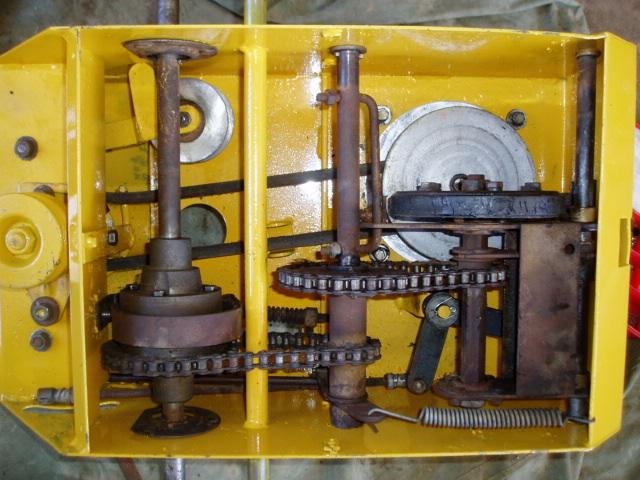

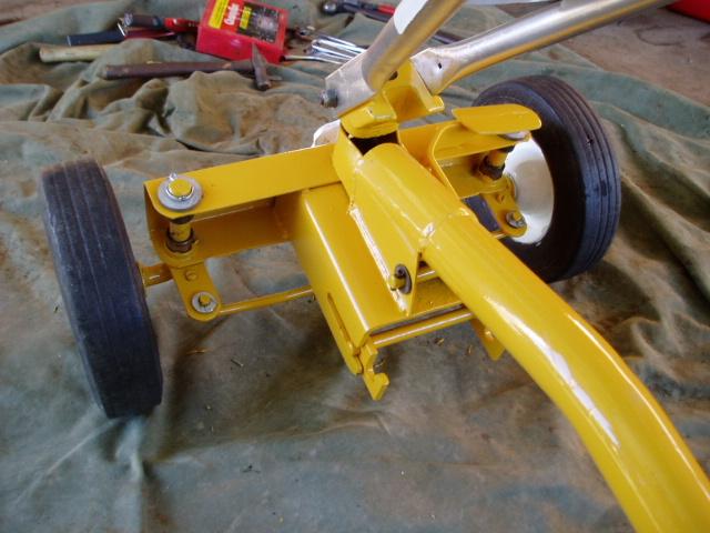

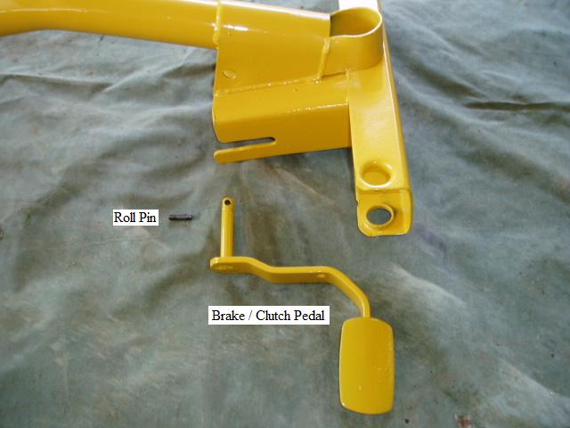

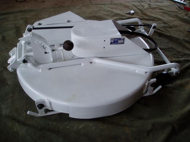

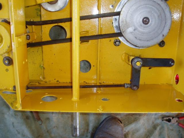

Okay, now in breakdown form.
The first two photo's are the steering components, in exploded and assembled form.
Then the photo showing the method of adjusting the second belt for the cutting deck. The disengaging of the cutting deck is via the first belt. Shown later.
The next photo is the clutch/ brake pedal. The first half of travel disengages the friction wheel, and further travel operates the brake.

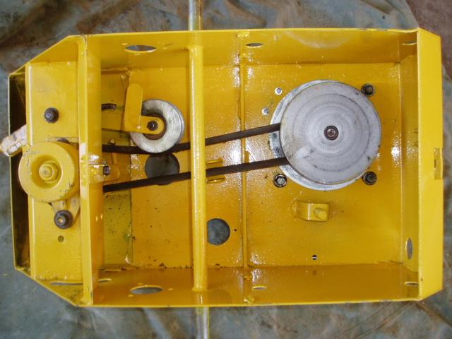

Following, is the views of the business end, disassembled. The views are as if you had the machine turned upside down and looking down on them.
Joined: Apr 2011
Posts: 346
Likes: 3

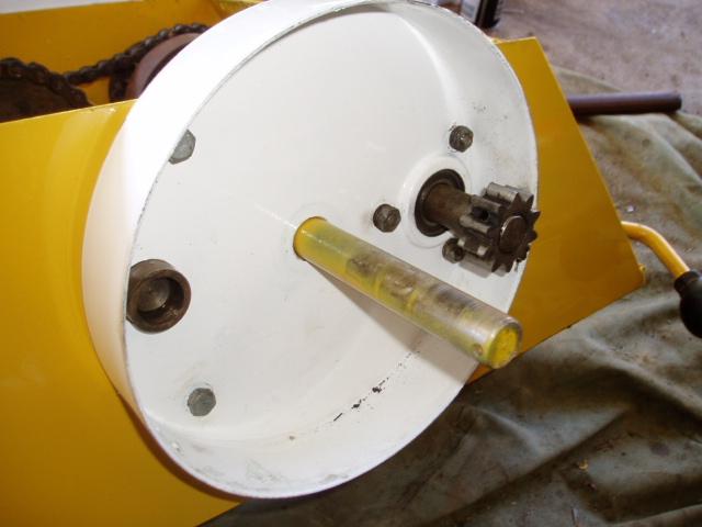

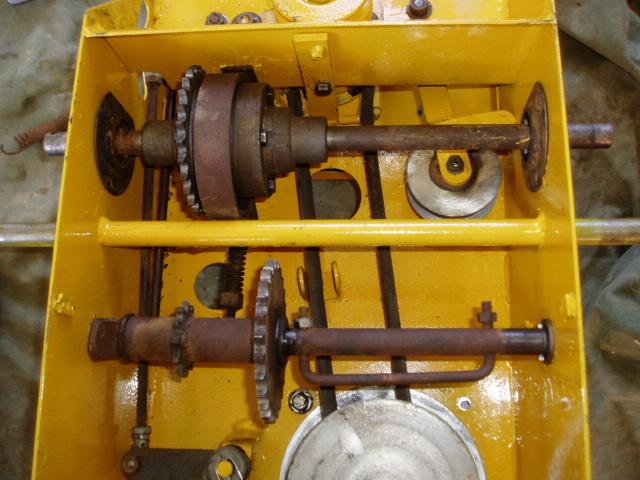

Assembly of the drive into the chassis.

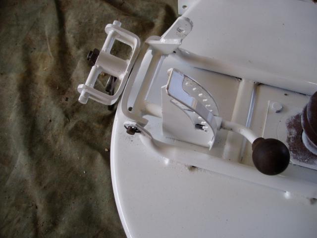

Shown is the components of the cutting deck disengagement. A single pivot assembly, that has an over centre operation in both directions.
The following photo's are in order of assembly.
1. Assemble the engine, belt, intermediate pully assembly, and the disengage lever into the body.
2. Install the gearshift in place.
3. Install the intermediate shaft, then the final drive shaft.
4. Install the primary shaft, ensuring the rose joint is connected to the sliding assembly, then the brake band, drive chains, etc.
5. Fit the hub drive covers and drive gears. Note, the wheels are shimmed to provide clearance for the drive gears.
6. The inside of the drive wheels showing the 58 tooth hub.
7. Drive ratios shown in schematic form.
Joined: Apr 2011
Posts: 346
Likes: 3

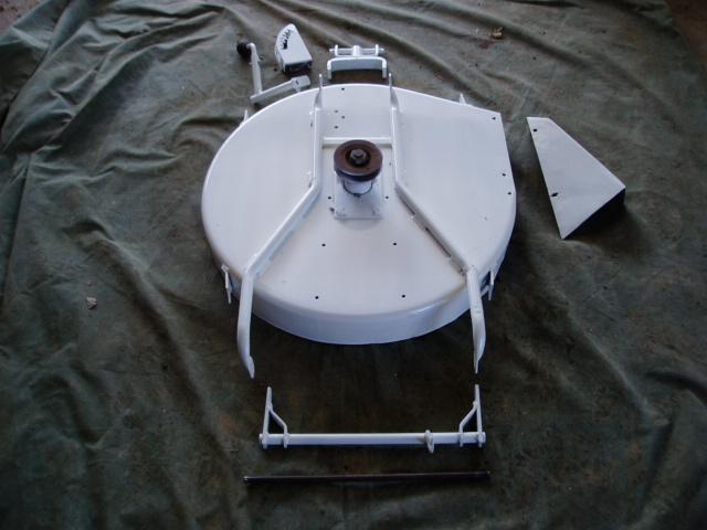

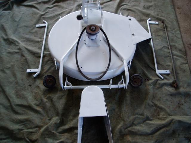

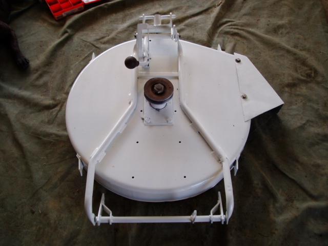

The Cutting Deck.
This series of photo's shows assembly of the cutting deck. Too many parts to lay out and fit in one go.
The final photo is of the deck ready to fit to the mower chassis.
Joined: Apr 2011
Posts: 346
Likes: 3

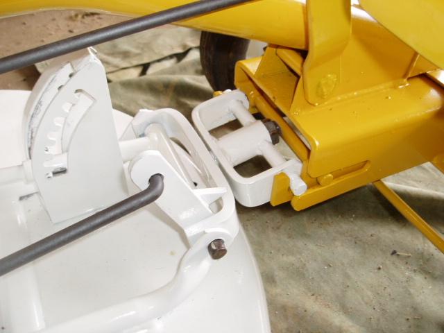

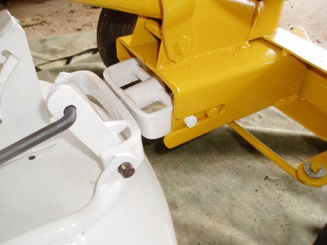

Now, putting it all back together.
Slide the front end assembly into the rear and locate in place with the collar and pin.
Then working at the forward end of the cutting deck, locate the front pivot assembly into the carrier.
Adjust the carrier to eliminate the deck being able to lift out.
The final photo shows the intermediate pulley assembly, with the primary (top) and secondary (bottom) belts fitted. The belts only drive the cutting deck.

The piece that is missing from the starter is the part the starter rope should come through. This starter cover is reversible so that the engine can run in reverse. It's one of those pieces that I will endevour to obtain. At the moment it is extremely easy to brake the rope. That's experience talking, 4 times in 2 days!!
As for the rest of the parts, I was lucky in that the machine was complete, and as I disassemble with care, there was only one bolt that sheared off. It may sound drastic, but I also make use of an oxy/accetylene set to dismantle old equipment. Not to cut, just to break the rust.
With my trade being a Fitter/ Machinist with small engine qualifications, I have performed many restorations over 35 years, of all types of items, and have many techniques that help the job along. I do all the work myself, and have almost all tools and equipment that are needed to complete the task.

Thanks. To be honest, I didn't disassemble the engine for a couple of reasons. Firstly, because of the extreme dificulty of obtaining replacement parts, and secondly, because the engine turned over nicely with a quite large amount of compression.
I have purchased a parts/ workshop manual for this particular engine from the US, printed in 1968, and I am waiting for delivery. Once it arrives, I can then provide more details.

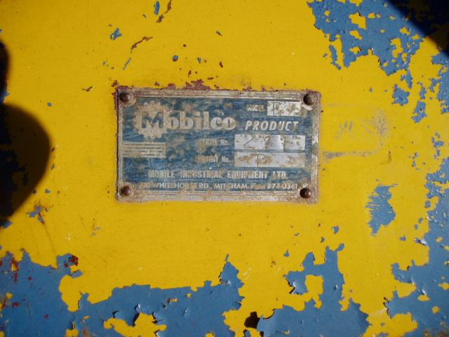

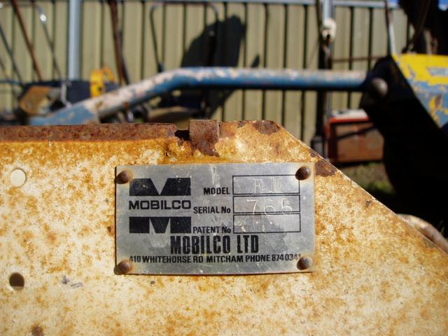

Here's some pics showing my other one, third cutting deck, and ID plates. The third cutting deck is a slightly later model with a different style ID plate and larger wheels. The diferent style ID plate may be able to give an indication of the age. It also has a disc with 4 blades, where the one still to be restored has a single piece slasher blade, and the restored one has a two piece slasher blade.
The serial numbers are:
The unrestored mower- 271
The restored mower- 524
The third cutting deck- 765

Ok, below is an email I recieved back from Ariens in America. I sent them the link to the post. Ummmmm..........
Greg
We have no records of our Emperor mower being relabeled under the Mobilco brand name.
It does look like an Ariens machine which we did make. All product from Ariens Company brought into the export market always had the Ariens name on it and not completely removed. We in the past did not sell our product under other names.
Daniel C. Haese
