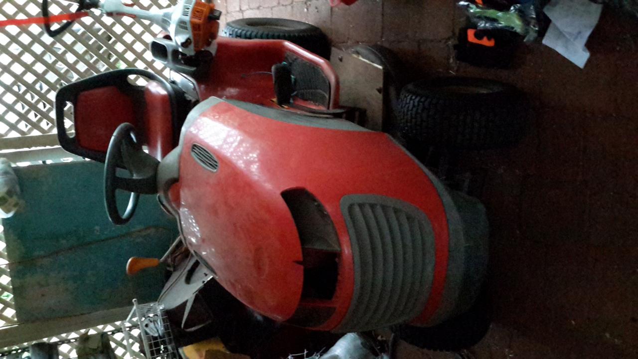

Hello everyone.
Just got a new mower today and I need to identified her.
Cox stockman 15hp b&s how can I found the exact model for part please.

Cone clutch
Side discharge.

Try looking under the seat for the model number. Once you find that we can help with parts list etc. cheers2

Cheers but I cannot found any info under the seat.
I believe it's a cox stockman 15hp and 32" deck.
Owner manuals which include parts lists can be downloaded from the Cox Mowers website; http://www.coxmowers.com.au/operation-manuals/
The Series 1 Stockman models are covered by several of those manuals designated by model number only, but yours is later.
You will probably have to try looking at a few of the different Stockman manuals, to see which one matches your machine. The 'New Era Stockman' and 'Stockman Pro' series look to have the same bonnet as your machine.
The transmission it has, will help to determine the model number; i.e. 'live drive' friction disc/cone, as you mention. The alternatives are hydrostatic, or transaxle.

Hi Jeromeo,
If you are still trying to identify this machine, I can help.
It's a Stockman New Era, so have a look for the ID sticker near the steering column (open the bonnet and look around on the metal structure that holds the steering wheel).
You're looking for a red/pink and silver sticker.
If you don't find anything there, lift up the seat and take a photo looking down on the area under the seat, then post it here. I should be able to narrow down the model from that.
