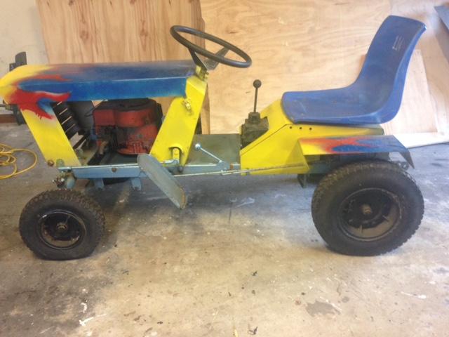

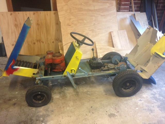

Bought this off Gumtree not knowing what it was and simply because I liked its lines.(paint job not so much) I did notice the rear fenders and steering wheel bare remarkable similarities to my rover colt. A 5 minute google search lead me back to this forum https://www.outdoorking-forum.com.au/forum/ubbthreads.php?ubb=showflat&Number=17178
And so I believe it is a Rover Rancher (feel free to correct me) however the rancher 2 being talked about in that thread has a 5 speed, mine is the earlier 3 speed. Im not sure if this motor is original either, looks a tad small. Havent had a good chance to go over everything closely yet. Compression seems decent, owner said it lost spark but we shall see
Likes: 310
Hello TLR
That is a Rancher.
But the motor is hilarious!
I do not believe any manufacturer would put a 3.5 hp engine on a ride-on.
The smallest I have seen has been a 4hp 11 Series - on any ride-on.
These early Ranchers had 7hp and 8hp engines.
The three speed boxes were Foote boxes - I think.
Is there a name on the box?
Let's not mention the paint scheme or that seat!

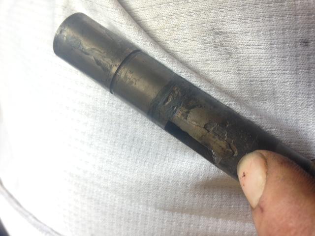

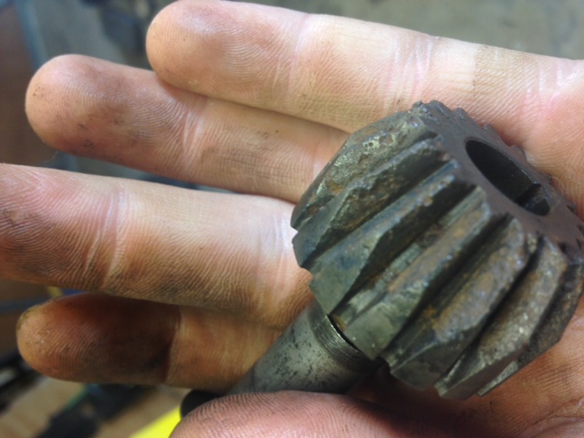

Stripped my one down and found a few issues.
The pinion gear being at the bottom of the box suffered the brunt of the corrosion. Word of warning to anyone dissembling these. Be prepared to catch a lot of needle roller bearings when you remove the pinion shaft!
Secondly the Bevel gear is missing 1/2 tooth and finally the drive shaft has 2 cracks in 2 of the keyways.
I think this box might be too far gone guys.
(dont know why pics are being rotated when using the forums uploader)
Likes: 310
G'day TLR
A big Thank You for the photos and story.
These Foote boxes have not been well documented.
This is a great example of the need to maintain them.
This one looks a write-off to me.
What's Plan B?
p.s. Image rotation issues:- Image Rotation
