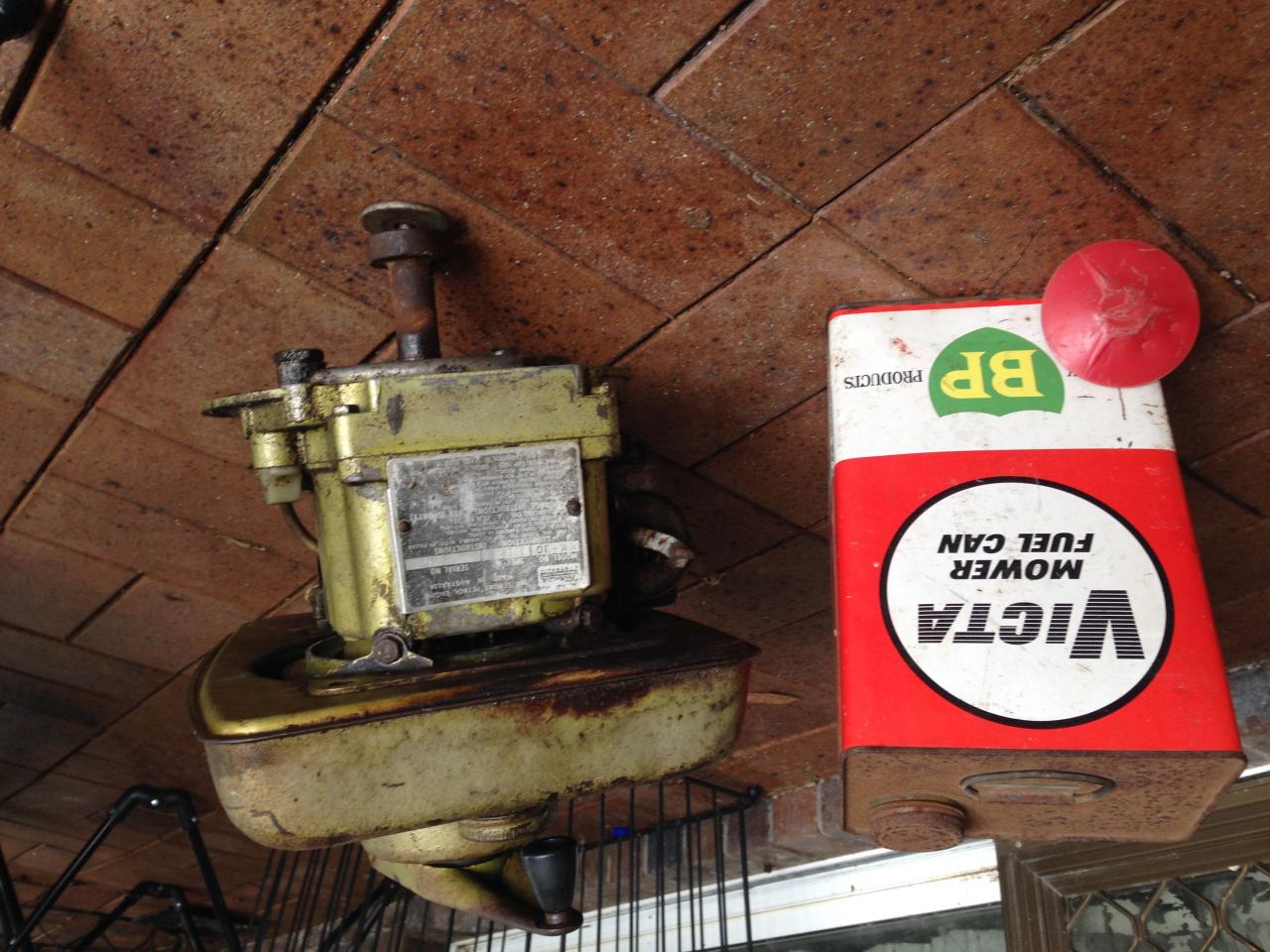

Hello Patrick & Kye
Thanks Patrick for offering to help here.
I downloaded Kye's image, inverted it and re-named it.
I feel the issue arises with the OS and device the member uses.
Kye, what device are you using to upload your images?
That your image was uploaded in another rotation this time is significant.
I feel the image is being written with data from your OS that
our image up-loader cannot correct.

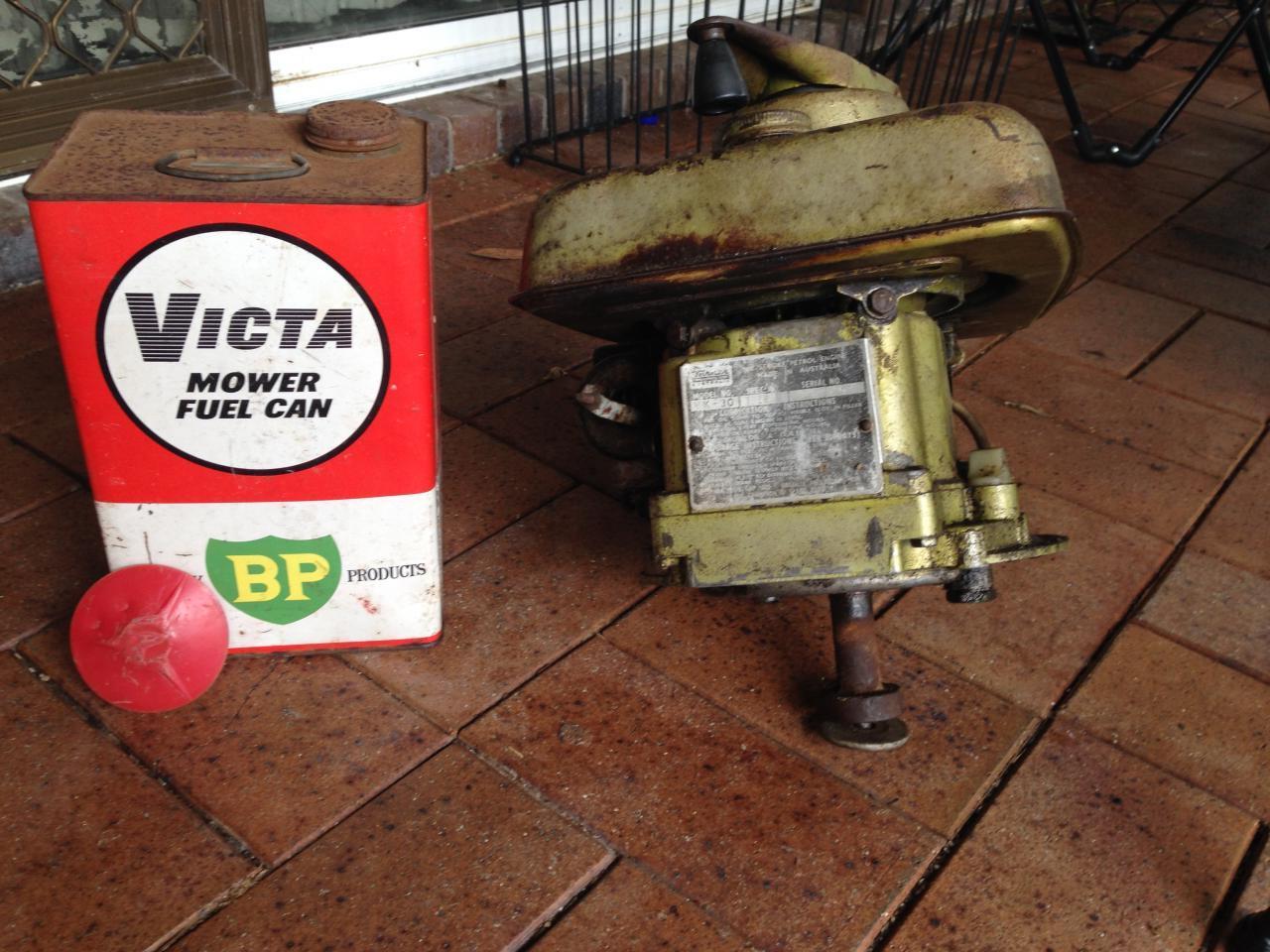

Kye, too easy, put the motor and the fuel can upside down and then take your photo
Joined: Nov 2015
Posts: 637
knowing my luck it would be the one time it ends up the right way!

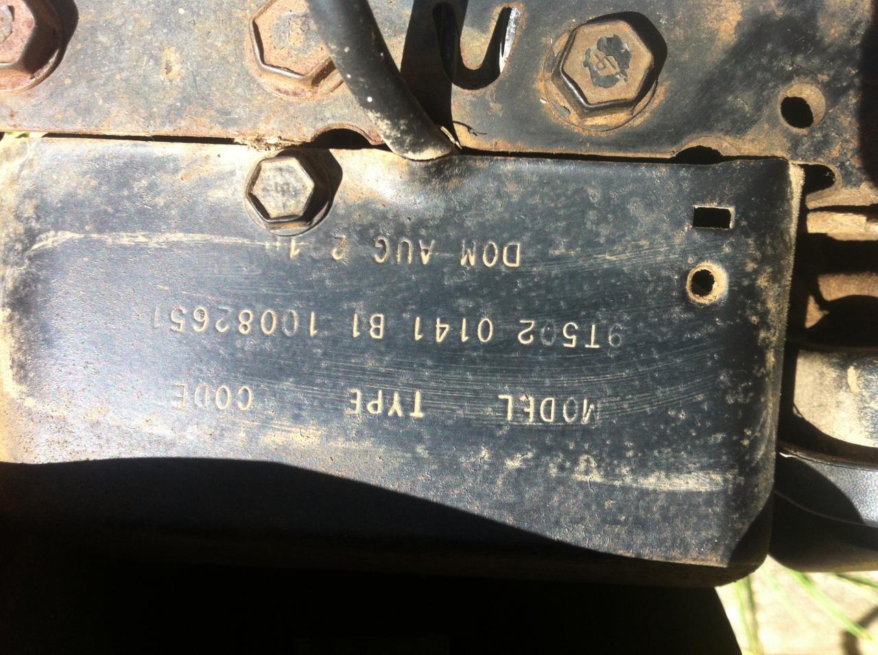

I uploaded this into a post the other day and it showed upside down, but is right way up on my Windows 10 desktop.
As you can see, again, it comes into the post upside down, so it is something weird that may be related to Windows 10.
Hope this is of some assistance.

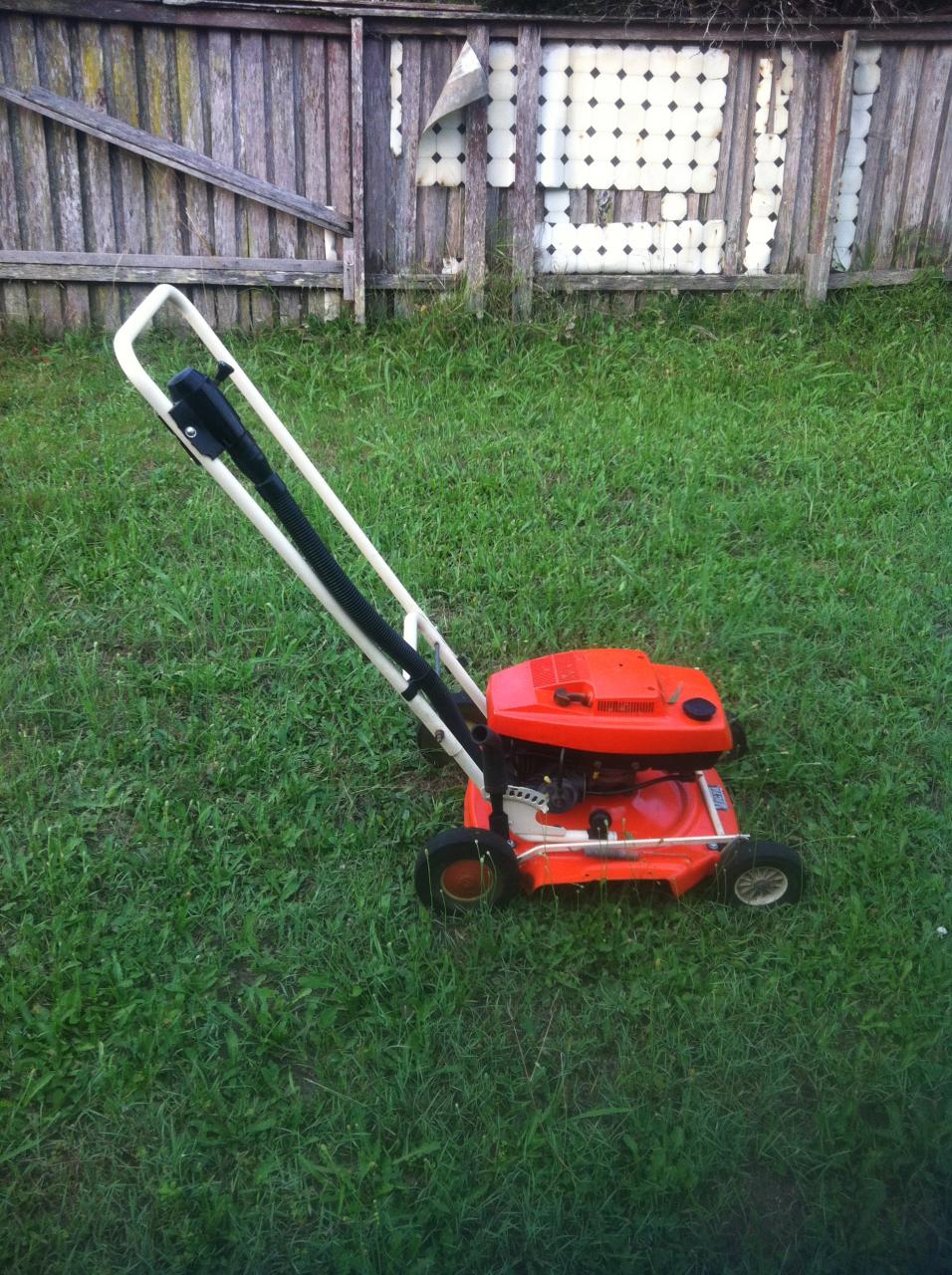

Now I am curious if it is just this photo, so here are three of a mower I have been working on: -
These imported correctly, so now, wondering if it could be something to do with the photo aspect when cropped, with the above being full Portrait style compared to my engine that is almost Square, I uploaded one below I thought was square(ish), but it imported okay as well.
So much for that theory. Why????

Hi Jack,
I've heard of rear view cameras but that (pic in your last post) is ridiculous! grin
Patrick

Patrick, I took your comment on board and upgraded to a front-facer.
No longer the laughing stock, this baby has a shutter speed measured in mph!
Posts: 8,216
Jack and I always believed the in car camera was developed for Bathurst
