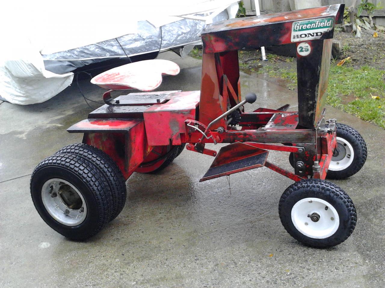

i just scored this,have i bit off more than i can chew or are parts still around ?. pick it up 2moz
Joined: Mar 2015
Posts: 567
prd Offline
MOD & GREENFIELD TECHNICIAN
G'day gml,
Yes, that's worth the effort. Will be some effort, but worth it!
I say this based on some research and assumptions that I've not yet shared on these pages. In a nutshell I believe that's the FIRST model greenfield!! Note the straight thru chassis rails, the piano style hinge on the cowl, the front axle pivot is made of box section and under the STP sticker will be (or was) a round style gear motif and 'G' sticker. Also, the transmission cover under the seat is different, thicker drive chain etc.
I've only seen two others. One is a photo of a restored one that lurkes on these pages the other.......I bought in very serendipitous circumstances a few weeks ago!! Astute readers will recall me discussing having to unsieze a couple of flood damaged engines in another thread. One of them is on this machine.
I'm at work and should get back. I'm keen to discuss this one further! Especially interested in the green paint on the cowl. Mine has green on it also but is certainly a brush job done later in its life and had assumed it should be all over red - but I'm beginning to wonder........
Mine has a G40 (or is it a G45?). I'll check when I get home. I'll also try a get some photos happening. It's a pest for me trying to get photos to this forum. My iPad doesn't like it so will need to use my daughters laptop.
Excellent find!

Ok, so it's a G40. The other machine I have which is slightly newer is a G50.
Also, is that paint or mould? smile Either way, I just had a good scratch round and there is red under the green.
I've not yet found any serial number on either of these two early machines and am now guessing that they didn't serialise in the very early days

g'day prd thank's for the info,i am picking it up in the morning and will go over it for id numbers and what ever i can find,will post more pics also,i believe there is a box of parts with it as well..i bought it on a whim. but am happy i did!! more soon..cheers
Joined: Mar 2015
Posts: 567
prd Offline
Here's hoping the engine and the drive pulley are in the box of bits. Would be nice iif they were.
Either way the machine is in good nick! Better than mine

Yes, it's my contention that this is an example of the first greenfield. I've been personally pursuing a desire to own an example of the first model ever built. I'd assumed for a long time that all red greenies were the same and that was the end of the matter. Interest was raised based on a comment by Gadge (I think) in another thread that the very earliest machines were 'slightly different'.
An insomniac has much quiet time to trawl gumtree, this forum and other places looking at photos trying to pick slight differences in what appear to be similar machines. This I did.
All of a sudden, an ad appeared that advertised an old Greenie that I felt I had to get. When I arrived (5 and a half hour one way trip) the eccentric chap selling it said he had another but it was in poor shape. Bingo! I felt I'd hit the jackpot. Another trip and that's where we are now.
I've been meaning to put together a bit of a thing for these pages on the find but hadn't got to it yet.
Let me get some photos over the weekend and I'll put together my thesis with the hope that it's of some use to y'all.
In response to your initial questions Jack:
yes 25" cut. Was there anything else available when the very first ones were built? My guess is no - but that's not proven by any stretch.
I've stepped away from the idea of a green Greenie:) Options were red or red, I think.
Model number? Again, I'm working on the theory that there wasn't one because ther was only one model!:)
Research has been purely physical and no written documents have been referred to. I've tried to find written information but can't. I'd love to get a hold of sales material, an IPC for these earliest machines and even newspaper ads etc. ( we've discussed before the lack of Trove post 1954). Written data would be wonderful but alas, I've got none.
What I have done is constantly tried to imagine "What would a bloke who is starting a business from scratch, with a new product (also from scratch) do? How would he develop the business and the product? How would the product evolve in this situation.
More to come.

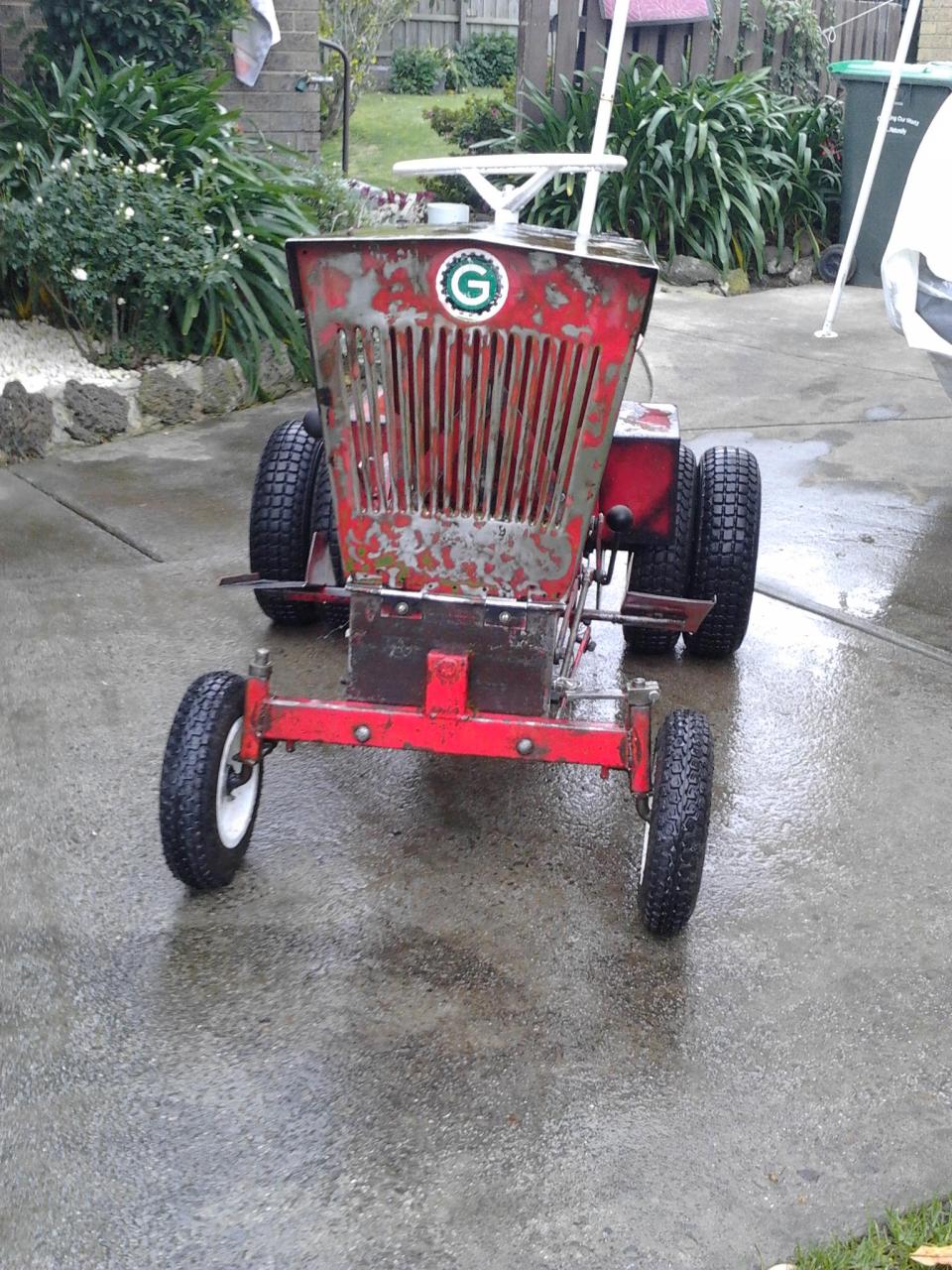

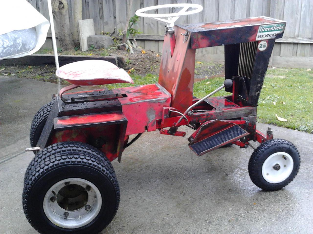

g'day fella's i will just jump in if that's ok, more pic's seems the front was hand painted and the rest look's original red, [Linked Image]
Joined: Mar 2015
Posts: 567
prd Offline
Damnation gml! That is a beautifully original lookin Machine!! Yep, red is the original colour for sure but I'm still 'green' with envy. smile Mine ain't that straight. Good you got the drive clutch/ gear, shame you didn't get the engine.
Well done, sir!

thank's prd' the p o was gunna turn it into a "planter box",do you think the carb in the pic would belong to it? also where would i get front tyre's for it? they are rs. i intend to pull it apart and clean it repaint it if i can find orig paint colour..cheer's
Joined: Mar 2015
Posts: 567
prd Offline
A planter box?! Some people have no clue!
Yup, I'd say the carb is off it. Certainly looks like it. Also the flywheel assembly looks like it would have come off it too.
The front tyres would have been solid rubber. Don't know how you would go trying to get solid rubber tyres for it now but you should be able to get pneumatics to replace the ones you have.
With a machine that straight I'd be going for a very sympathetic, minimalist restoration - but having said that this stuff is very much personal choice. Just thank the stars it's not going to have geraniums sprouting out of every orifice smile

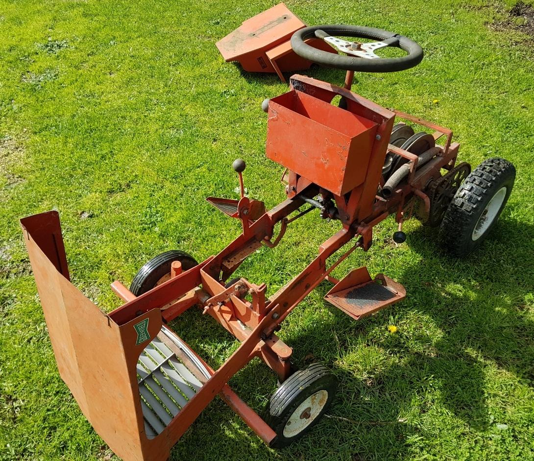

Photos of straight through rail with a G65 and one which is 'dropped'.
Note the way the one with the straight rails has the steering wheel and bonnet top sitting in an ungainly and high position. Comparison can be made by noting the relative positions of the steering shaft cutout in the panel.
Photos of another straight rail that better shows the position of the steering shaft through the panel. Note also the G style logo, the bonnet pivot position and the axle pivot style. I'll come back to those but I'm suggesting this is a very early G65 machine.
I've jumped forward a bit. Working on the basis that the G30,G40 or G50 engines were the first ones used explains what happened. These engines are physically smaller in height than the G65 and sat nicely on the straight rails. Shortly after, the G65 was used and sat the bonnet and steering wheel too high. The chassis modification is in response to this and was used all the way up to the end of the HD8's in this style. Evolution of an existing design to fit a product development.
What was the first engine used? As already mentioned above, the obituary article gives that it was a '4.5hp G30 engine'. Mine is 4.5hp but is a G40 so a discrepancy there. I'm happy to run with the idea that there is a typo in the article and should read G40 but this is one of the many things that needs to be looked into fully.
Below is a photo of the other straight rail I have. It's G50 powered. Note the bonnet style (slotted, not meshed) and it has the pivots at the side off the cutter height adjust arm as do all machines except the earliest machines. Also note the front axle pivot style. I'll come back to that.
Were the small horsepower machines with the straight rail chassis continued in production for a while once the G65's and the dropped chassis came along? Dunno. It's one of the things I'd like to know the answer to and to that end the age of that g50 machine and its position in the story is a bit of a mystery to me.
To be continued...... [Linked Image]

First one is a detail of the drop on a later G65 chassis
Next out of sequence is a straight chassis with the high steering wheel.
Next a photo of a straight rail which doesn't show the rails very well. Below is a better example. Note the G Gadge
Next, detail of a dropped chassis machine showing that the steering shaft comes through much higher up. Well not really, optical illusion because the vertical panel is lower.
Last, straight rail G 50 machine. A bit of an enigma for the moment

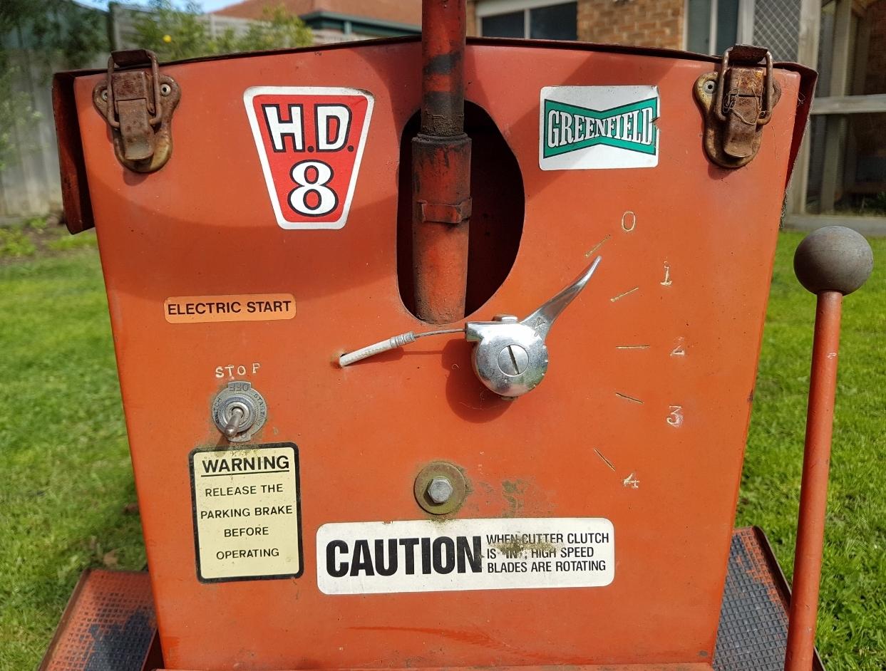

Transmission Cover: Again, all Reds and HD8s have the one piece cover that's tapered in plan towards the bonnet. These earlier machines have a two piece cover that leaves the drive chain exposed (how very un-OH&S!) and allows access to the drive belt tensioner. Again, we can assume an earlier design. Also, it can well be imagined that when the design was first created the need for easy access to the tensioner was envisaged with hindsight demonstrating this wasn't necessary and was removed from later variants.
