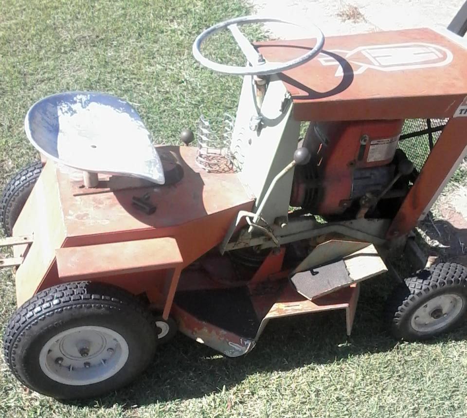

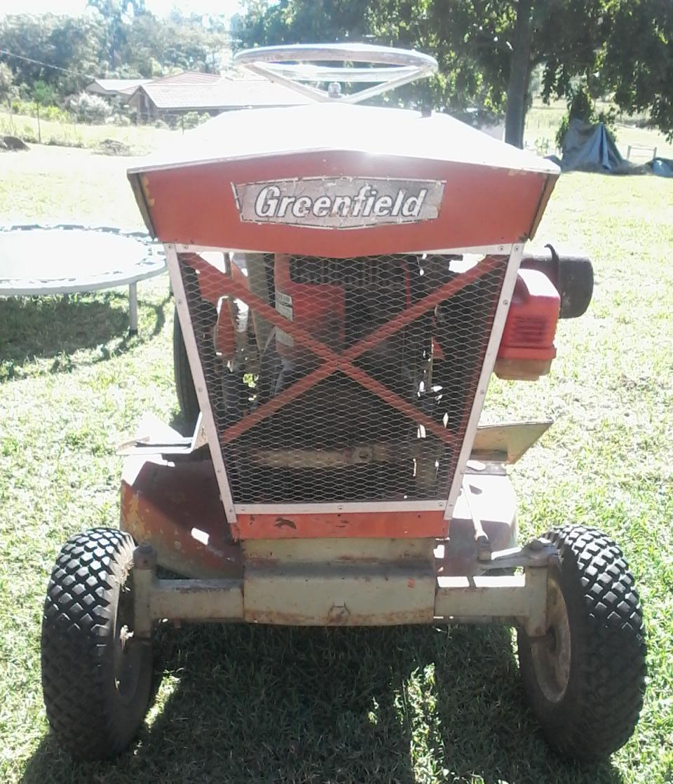

Joined: May 2015
Posts: 15
You're welcome, Grannic.
As I've mentioned in one of those older threads, there was only one readily visible change to the chassis, during the HD-8 model run.
That's the front axle mounting, and yours is the later type.
The bonnet mods are a bit harder to fit into a definite sequence, e.g. the louvres used on some examples.
But I can say that the fuel tank cutout is engine-specific, not related to year of manufacture. It's only found on the G65-engined HD-8 examples, as the Fuji Robin EY25D engine [which was fitted to HD-6's IIRC, as it was 'nominally' 6hp] had a lower profile, and didn't require the cutout.
Your machine does look to be in very original condition, allowing for its age; very few dings - the leading edges of the rear guards and bonnet usually cop a few on these machines. The engine looks very original too, except for the muffler. Which is no surprise; even though the originals were made of corrosion-resistant aluminised steel, the leaded fuel of those days made for short muffler life.
Edit: And genuine replacements were always pricy - we Honda dealers used to put them on the 'monthly stock order', which had a higher discount off list price than routine parts orders.
The original rear tyres had a much 'squarer' profile, though.

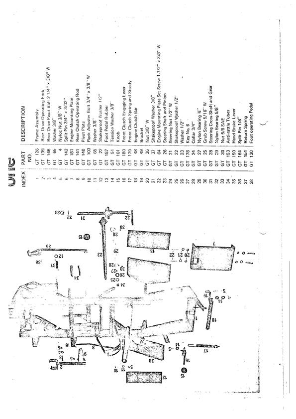

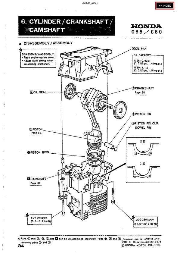

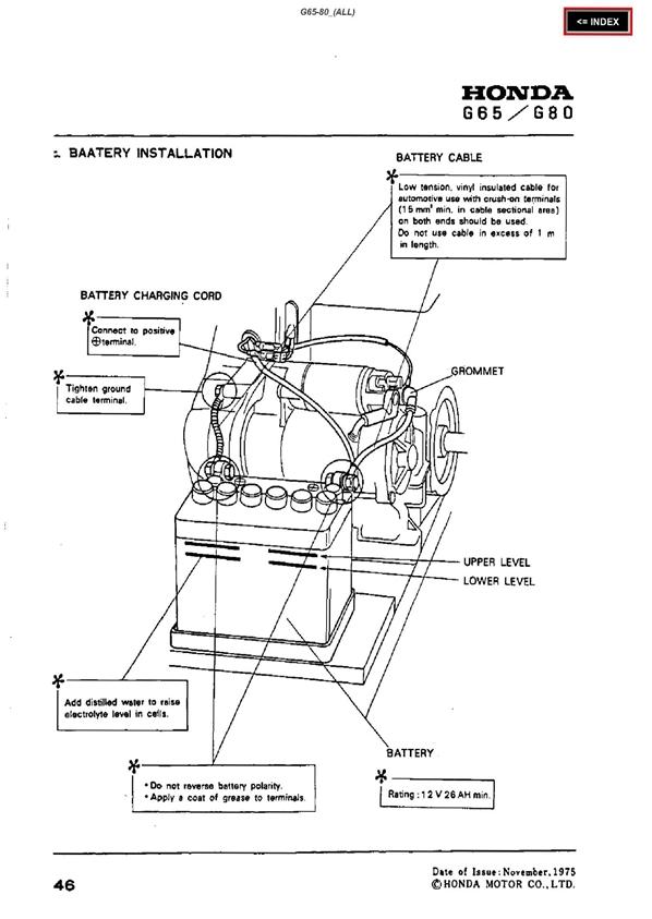

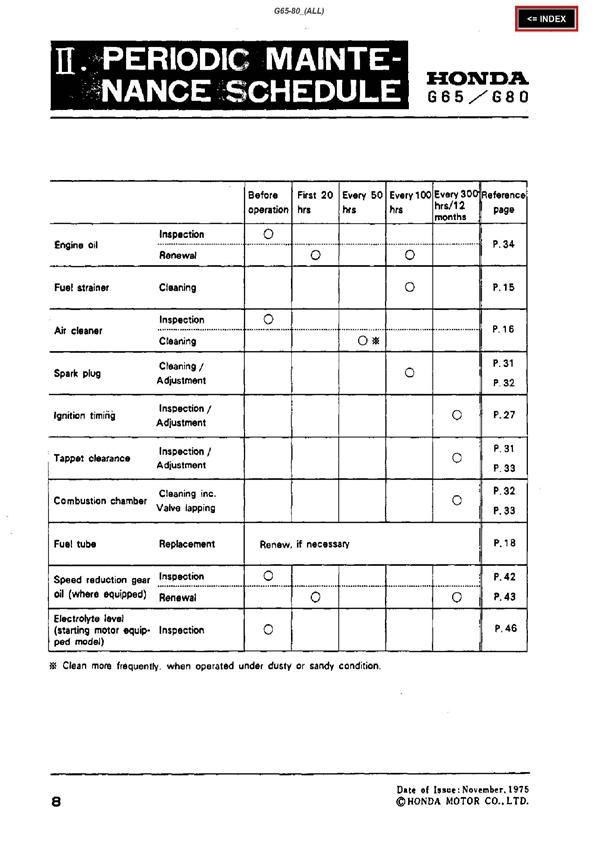

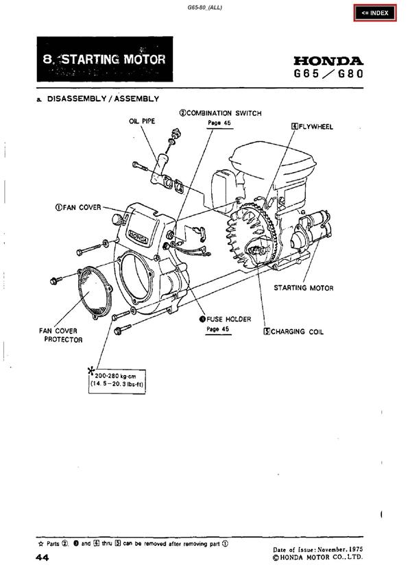

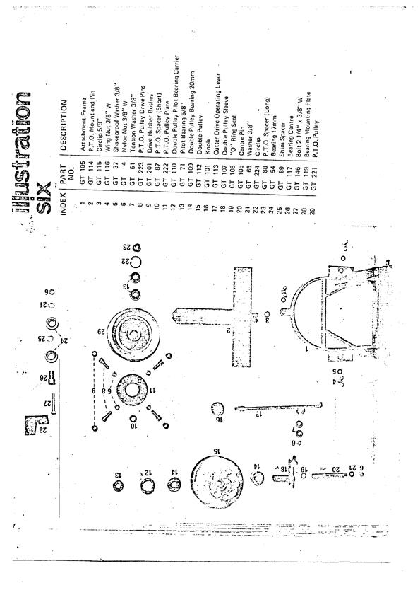

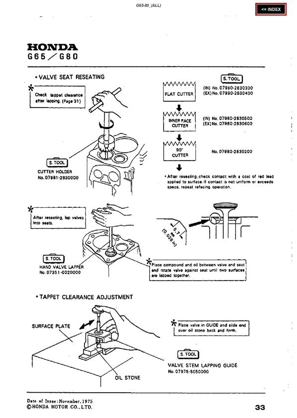

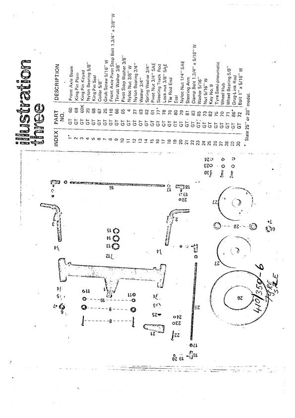

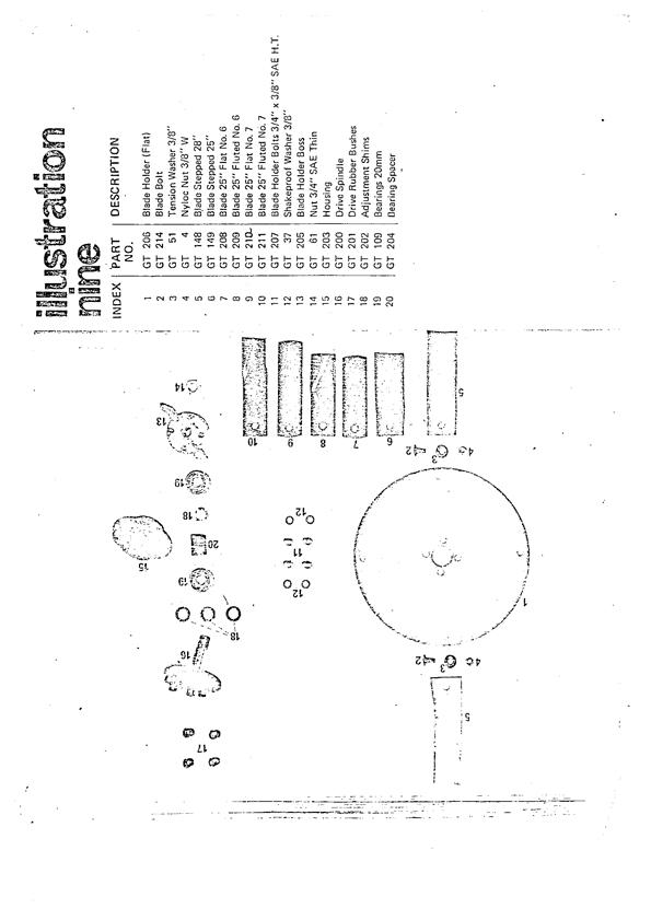

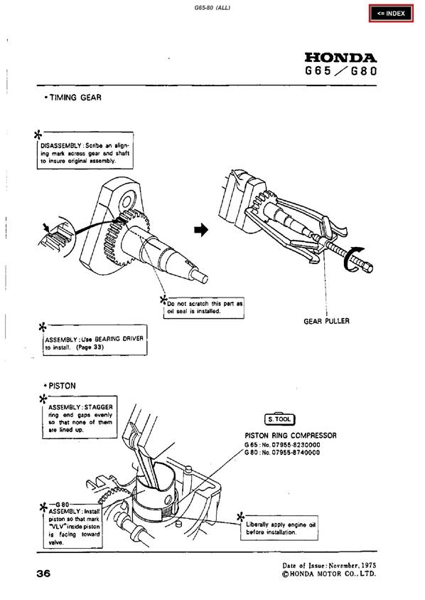

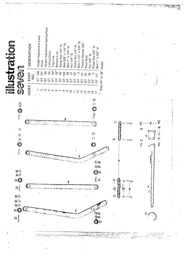

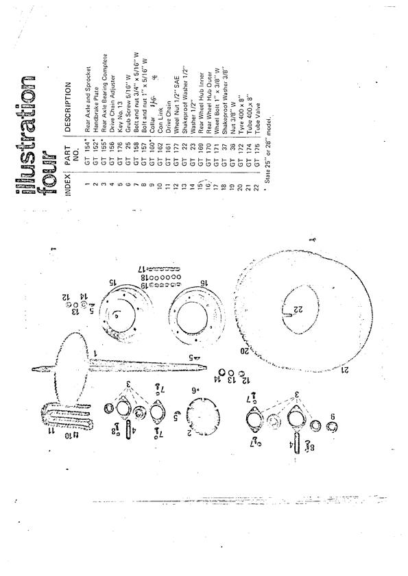

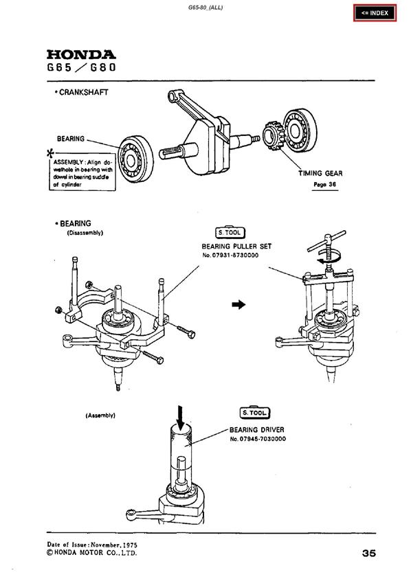

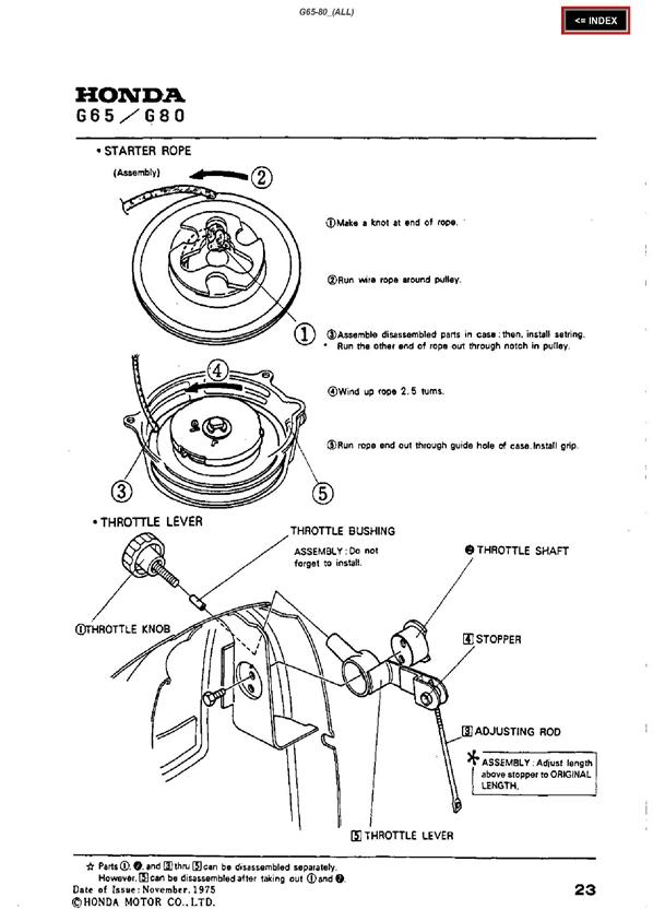

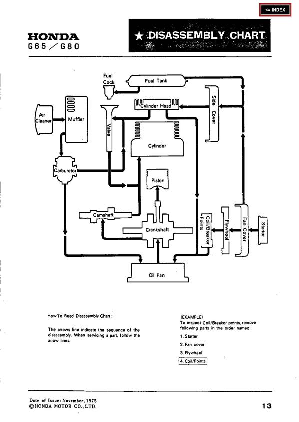

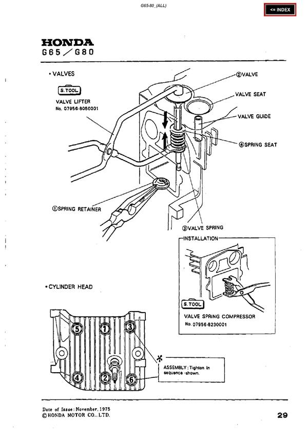

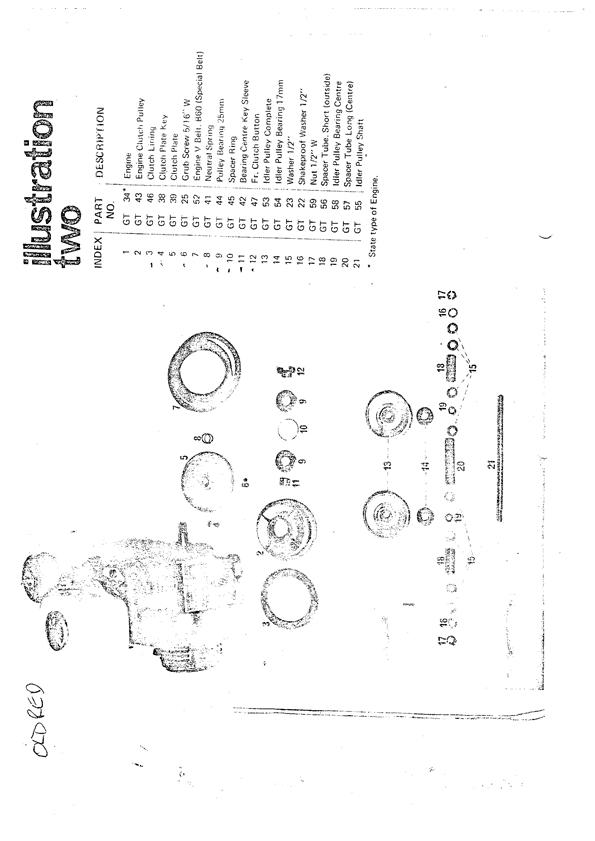

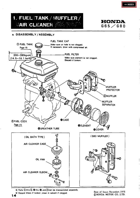

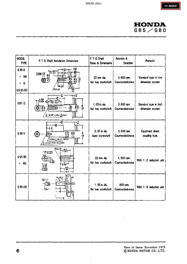

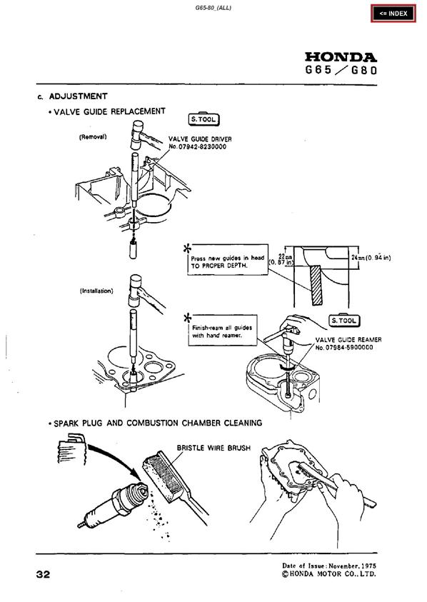

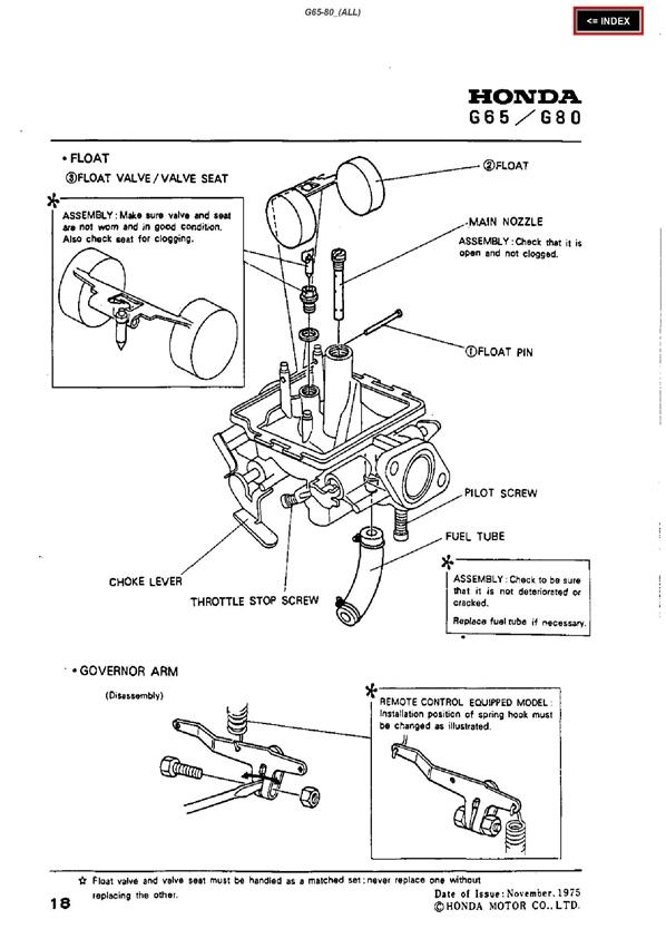

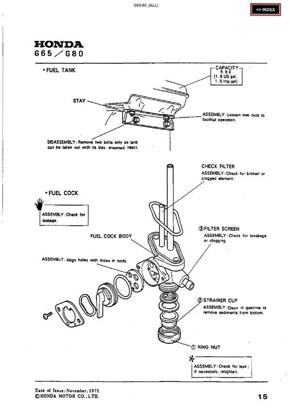

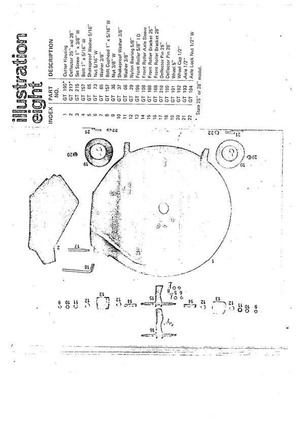

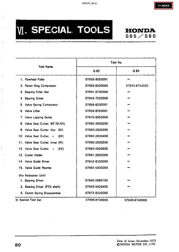

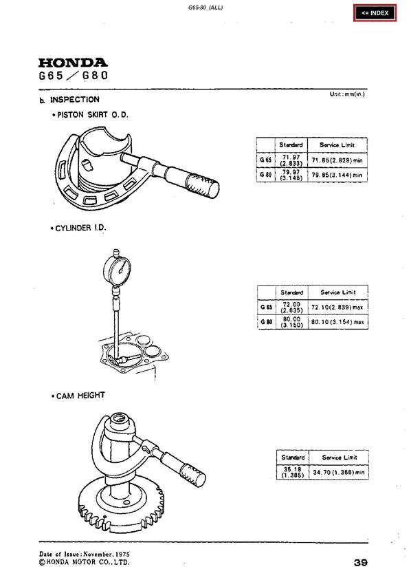

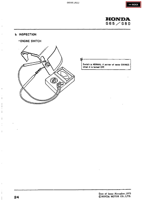

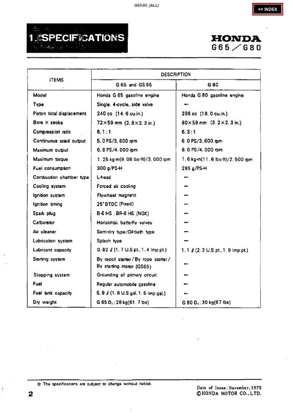

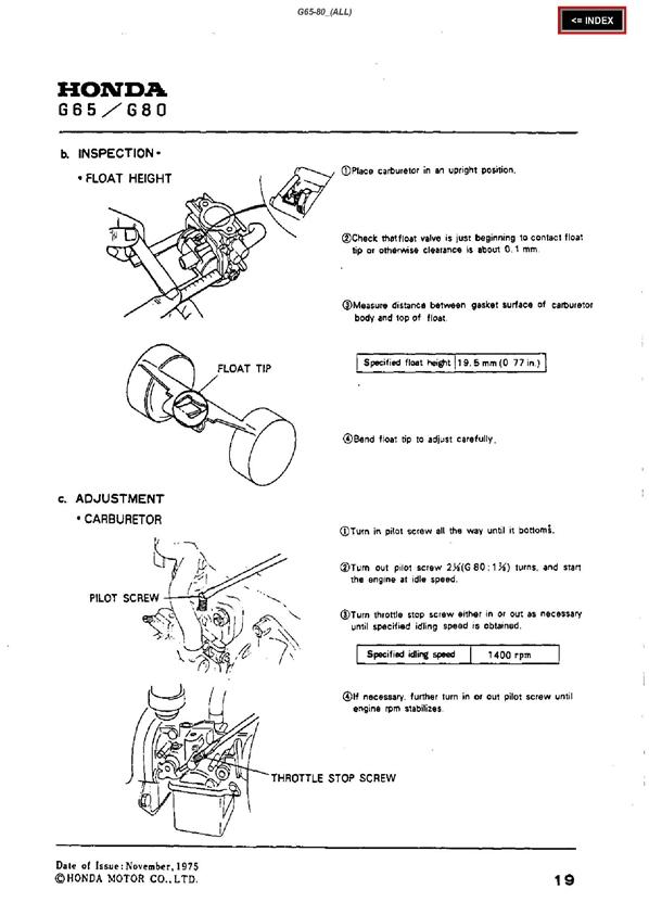

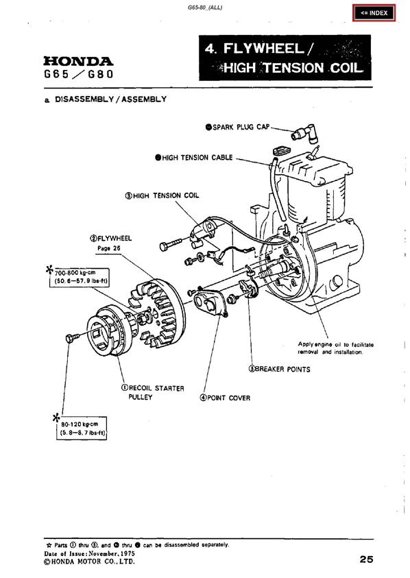

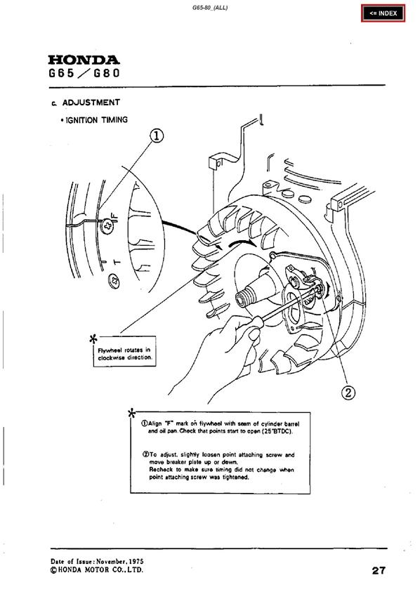

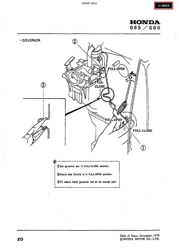

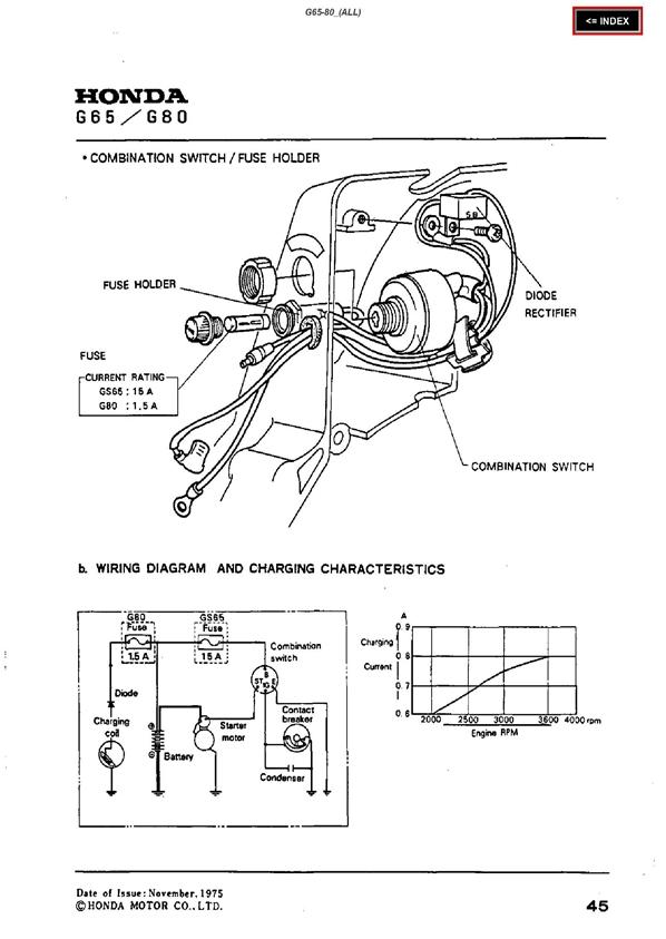

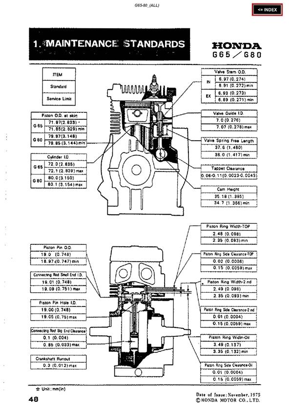

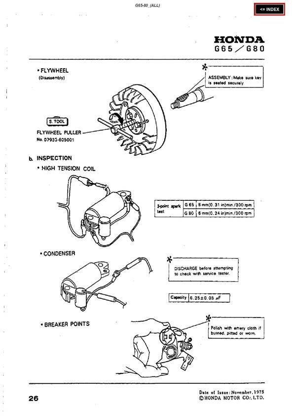

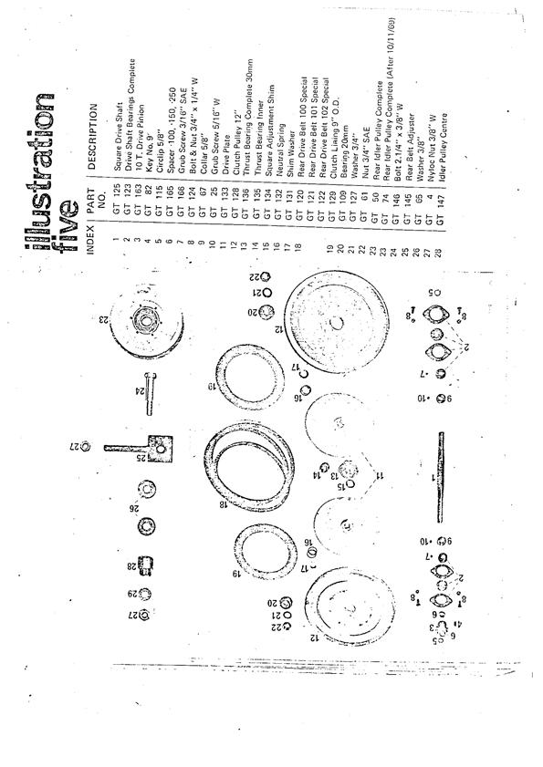

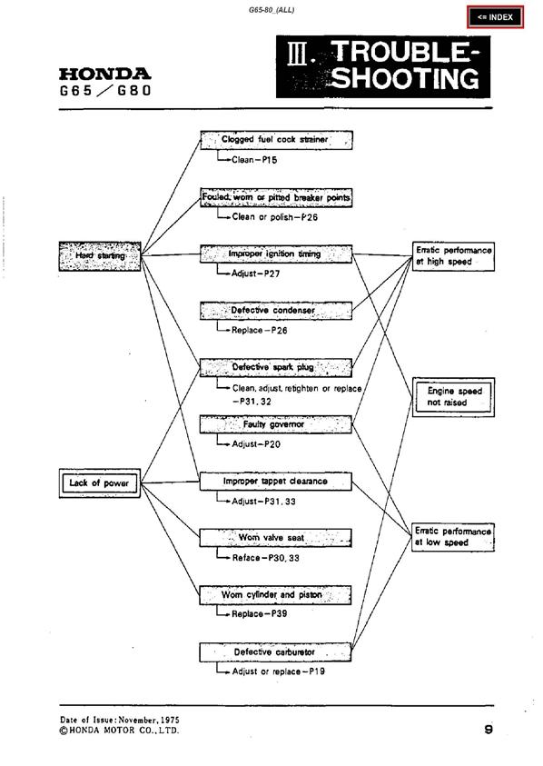

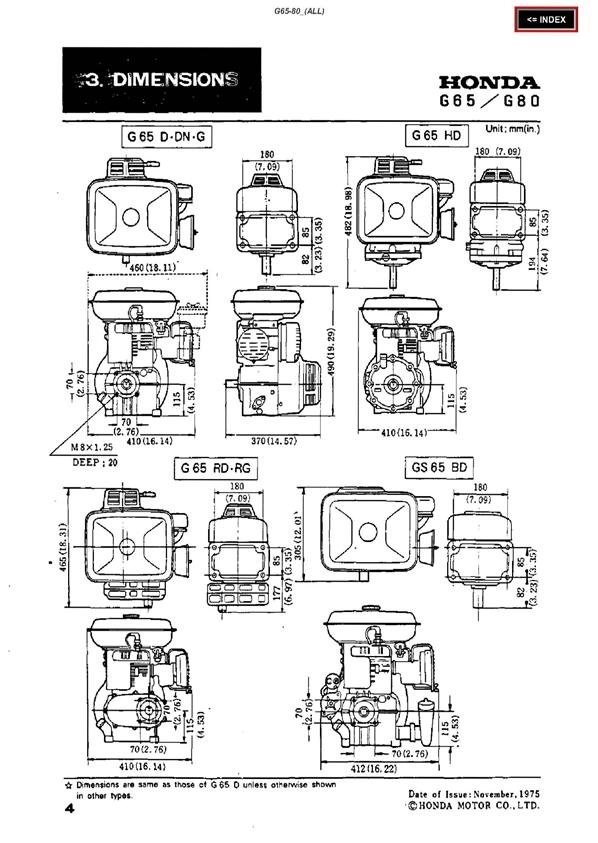

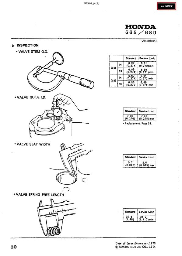

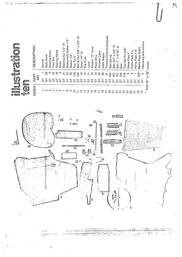

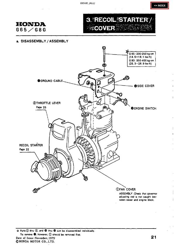

Hi all, not sure if this is the right area to load what I have for the HD 8 HONDA G65. Anyway, [Linked Image]
some copies are good and some not so good.

bigshock
I hope the above manuals are helpful. Should be able to find notable differences between The first Greenfield....Old Red and the 2nd type Yellow.
If any pages are missing please let me know
Cheers.
Thanks for that Grannic. The HD-8 Illustrated Parts List, in particular, is a considerably better copy than I have seen before, and should be useful to users, collectors and restorers. You have collected more HD-8 information than I have ever seen before, into one place. Well done.

Considering restoring Greenfield HD-8 ride on mower. Have Frame & G65 Honda motor but no clutch pulley. Does anyone know how to obtain pulley & clutch?

I'm assuming you need the pulley/clutch arrangement that goes on the engine PTO. The first question is, is your machine a 'red' or a 'yellow'? The first Greenies were red in colour and had a single belt from the engine. The next generation were yellow and had two belts (drive belt and a cutter belt) at the engine.

In this thread there is a copy of the cat-alogue ( smile re: the 'other' thread) for the 'red'. It gives that the belt is a B60 (the poor copy makes it look like an 'H' but it's a 'B'. This is confirmed by a belt bought for one of mine which was measured from the old one.
There has been a bit of discussion about the belt material best suited for applications like this where the belt does a fair bit of twisting and turning. I'm no expert but I believe Kevlar belts are the go.
Belt can be sourced from a bearing shop or the like.

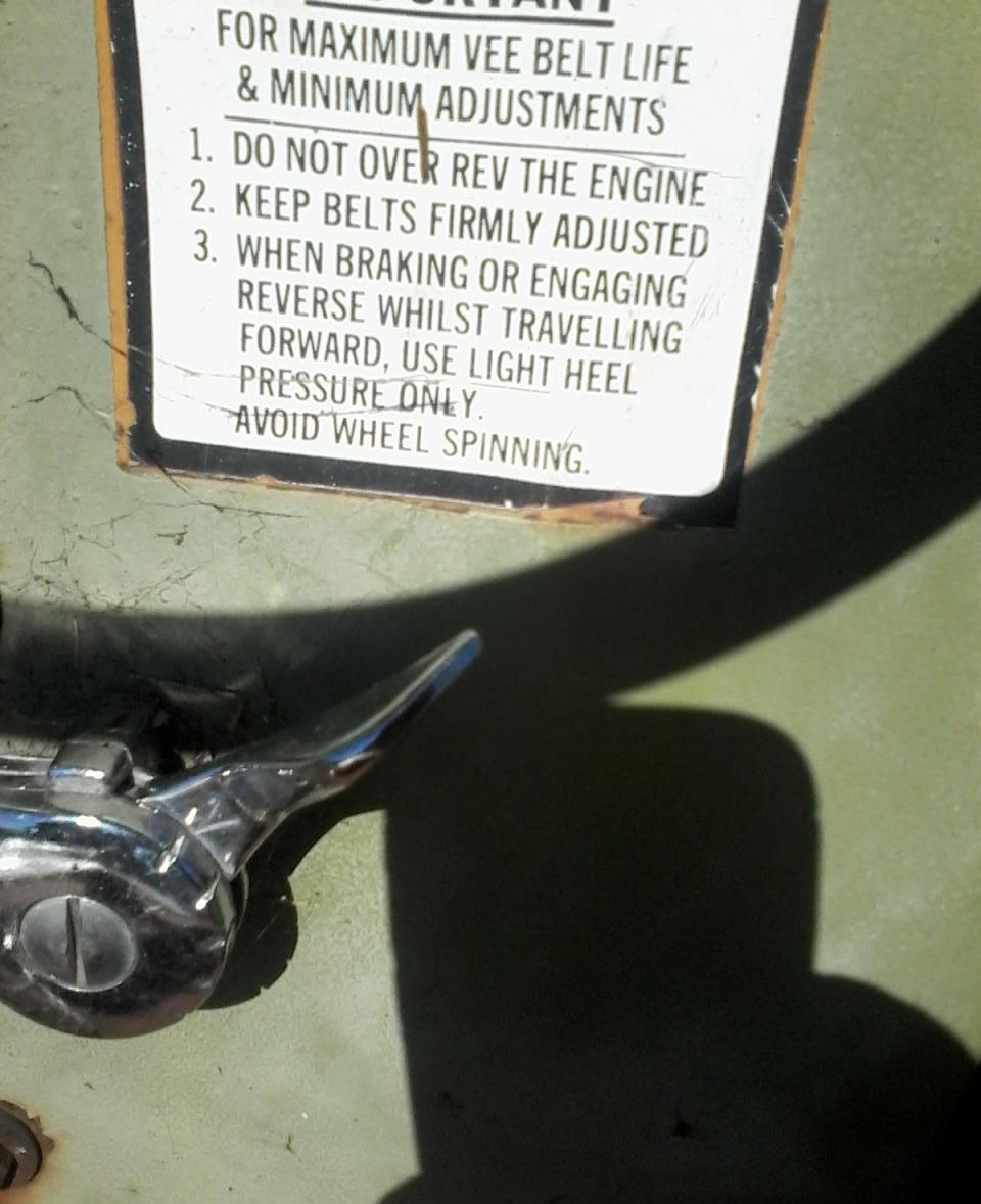

I tried loading 2 photos so I hope they are on this message
