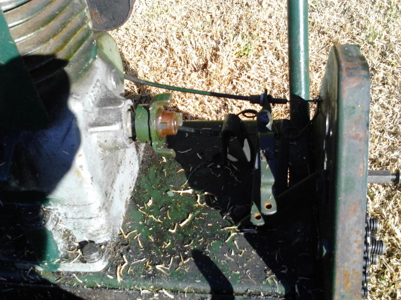

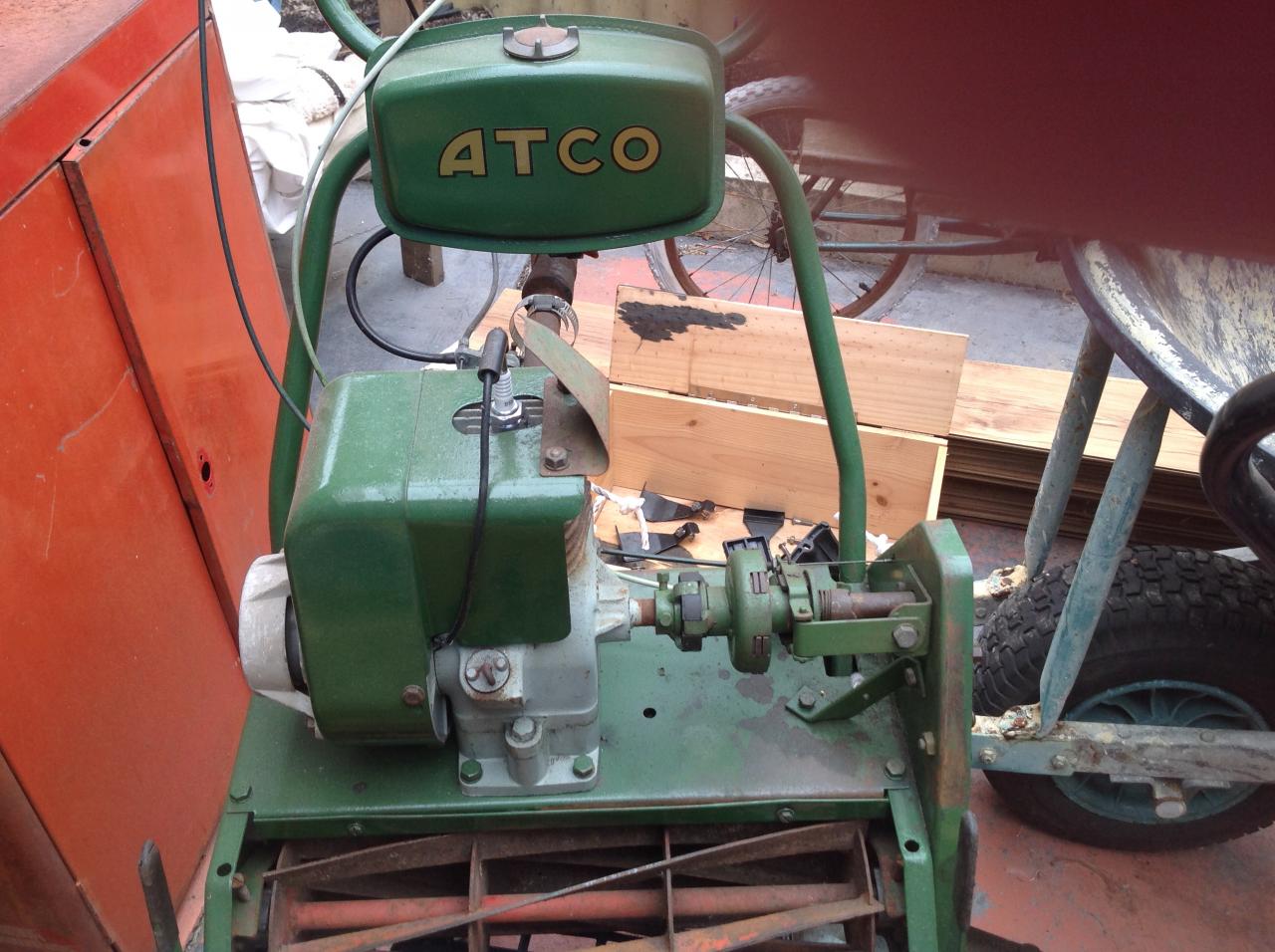

hi, what is missing on this mower does any one have a pic of how it should look when together,thank"s
Posts: 988
Likes: 7
Hello and welcome, I think your mower is an Atco. Looks to be missing it's rubber block that sits between the two claws
Have a look at this EBay auction, in the picture you are missing the part in the middle. It may be a rubber or nylon block.
http://www.ebay.co.uk/itm/Atco-B17-Commodore-EL-engine-to-drive-shaft-coulping-clutch-housing-/351627106914?hash=item51de9bda62:g:-RsAAOSwUdlWgSLY
The rest of the shaft would mount in between but the drive sprocket would be on the outside of the chassis. Hope this makes sense

Hi gml and Paul
Yep, as Paul said, an Atco.

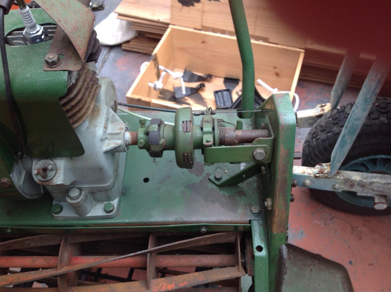

I have pics of mine - I don't know how to download them !!
Joined: Sep 2014
Posts: 14
I have a pic on my ipad but when I click on all done nothing happens!
Likes: 308
Hello GRNP
Information on downloading photos is HERE.
There may be an issue with your ipad software:-
https://www.outdoorking-forum.com.au/forum/ubbthreads.php?ubb=showflat&Number=71437
Joined: Sep 2014
Posts: 14
Okay lets see if this works!!!
Joined: Sep 2014
Posts: 14
I think your mower is a mid 70s Deluxe B 14. There should be a brass plate under a bolt just near the starter. It should have stamped on it B14 - or B something depending on its width. I am in the middle of semi restoring mine. They are very UNpopular over here in WA. They crop up on Gumtree and most people have no idea what they are and the local workshops dont want to know about them . My dad has had one for over 40 years. They are temperamental - will absolutely not tolerant stale fuel at all and some people reckon they are too fast . I like em!!! I grew up using an Atco and dont like using the SB/Rover 45 , but I like their looks and ubiquity. Spray painted it Brunswick green and got the decal off Ebay. Its going to be my regular mower so its not gunna be showroom spec.

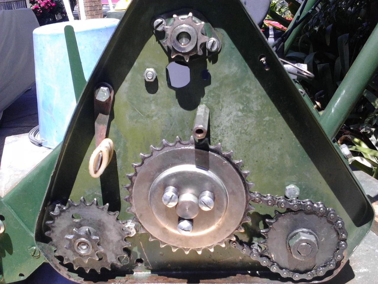

hi greenpool can you post pic of chain setup,and sprocket's,i am having a bit of trouble trying to get mine right,it wont drive i have something not right thank you
Posts: 282
gml
Offline
Greenfield Enthusiast
help needed!!!i have put my drive chain's back together(many many time's)and i cant for the life of me understand this system,it wont drive at the moment have tightened/loosened chain,now let me say this i am fairly handy with the spanner's but this f@%$%& thing has sent me crazy. how does the sprocket on the crankshaft stay on!! if i turn everything by hand (machine elevated)the sprocket just undoes with the movement, i have copied the setup of pics and part's manual, i have spent more time on this than i should have,
Likes: 308
Hello gml
I do not know if this is what you're after.
This is an earlier model, but it should have the same transmission.

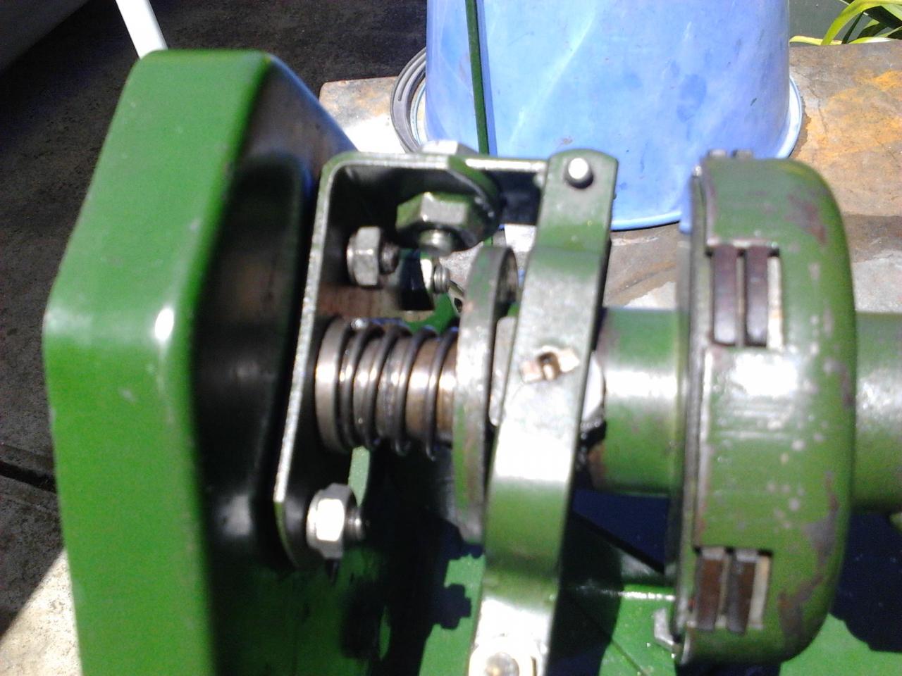

I take it you have the primary, plate clutch working?
Is there a secondary clutch (I) on the roller?
Posts: 282
gml
Offline

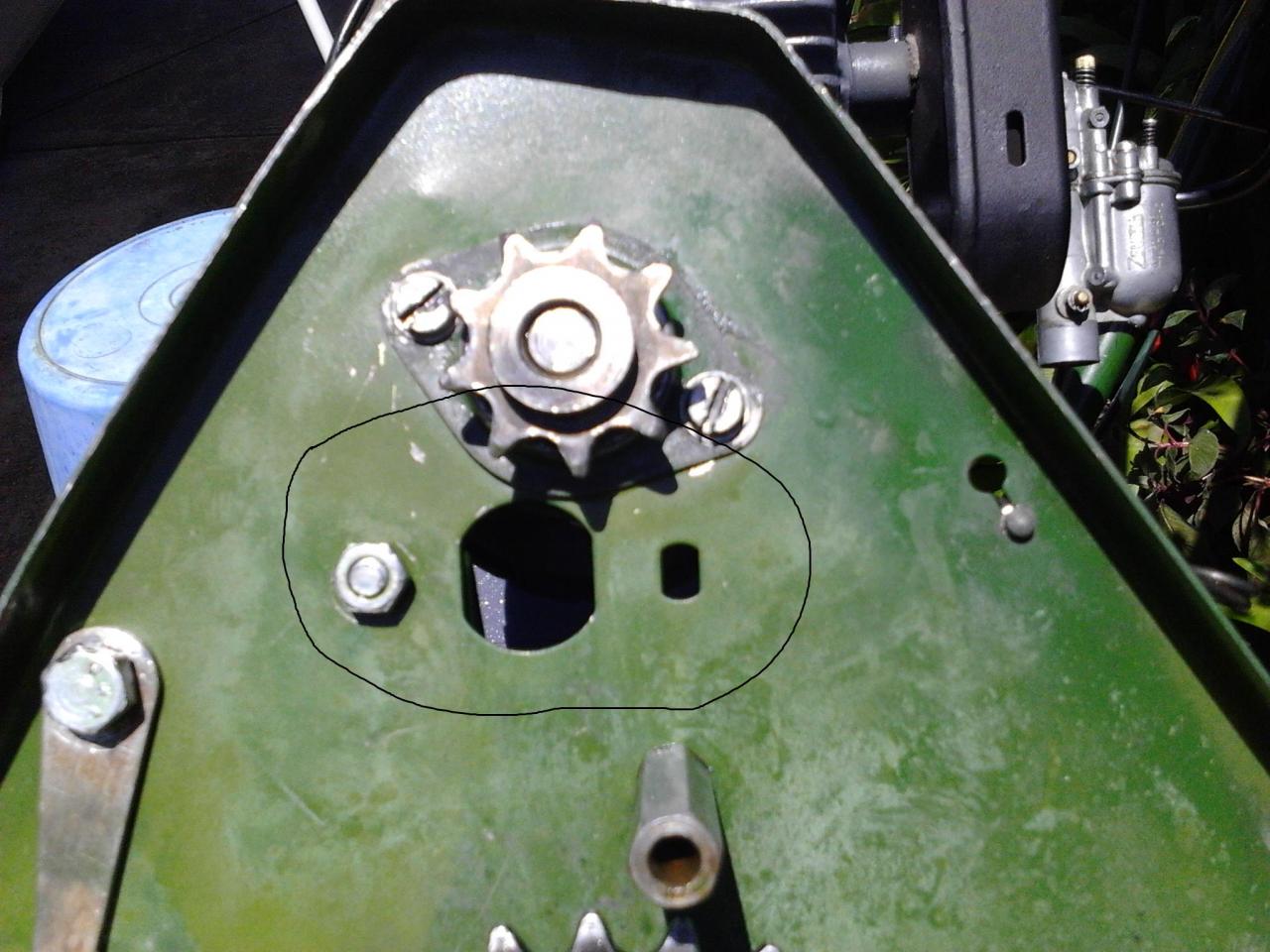

Thank's Jack i think i am missing something under top sprocket if you look at pic you can see where something should be,also the top sprocket tighten's up too much or winds itself right off,i need a schematic or pic of the same setup will post pics see if some one know's cheer's [Linked Image]
Likes: 308
Hello gml
Is it possible the bearing housing goes on the other side of the frame?
i.e. that it faces the clutch from the inside.
Posts: 282
gml
Offline
Thank's Jack will try it and get back to you,just looked back at this so i guess no it doesn't go that way [Linked Image]
Posts: 988
Likes: 7
My bearing is on the outside
Posts: 282
gml
Offline
Thank's Paul,i think i have a part missing,will see how i go
Posts: 8,142
Likes: 231
What I am not seeing is what holds the sprocket on
