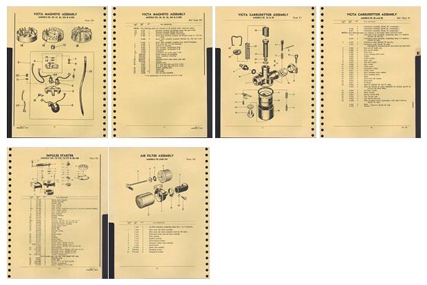

ENGINE ANCILLARIES
The Vicroy had the Victa 5e or 5J magneto and 3F Carburettor.
Special note should be given to the two different starter housings for
the impulse starter. Also of note, is the short-lived 7G & 7H choke
and filter assembly.
VICEROY - ENGINE PARTS LIST
VICEROY - ANCILLARIES LIST
