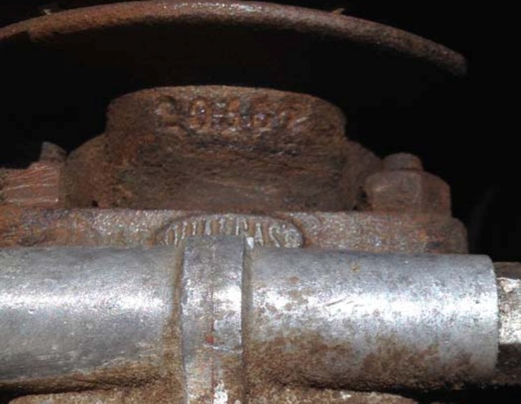

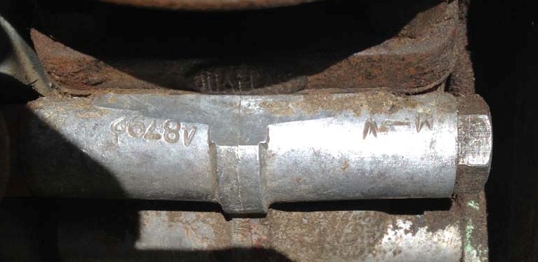

Some more pictures have come through on the above mower
and it has 'Qualcast' cast onto the barrel
Ian
Hello IanOZ and ODK Members & Guests
From the outset, I don't know the manufacturer of this unusual lawnmower.
All I can do is discuss the unusual features of this interesting mower.
At least, we now have a record of it, and I have filed it as 'Unknown'
[1] Engine.
I believe this engine is a JAP Model 80 (not the more-common C80).
The features that indicate this are: removable head; unusual port locations;
crankcase design; small flywheel; muffler design.
[I am not ruling out that this is, in fact, a Hardman & Hall Simplex engine
that had similar port locations to the JAP]
I can only speculate that 'Qualcast' appears on the cylinder as it was made
by the foundry division of Qualcast - a foundry that made component parts
for other manufacturers (including auto parts).
However, I note that Qualcast did takeover the Suffolk Iron Foundry in the 1950s,
(makers of the Suffolk engines), and 'Qualcast', itself, was the brand name
of the Derwent Foundry (originally). My best guess, though, is a JAP.

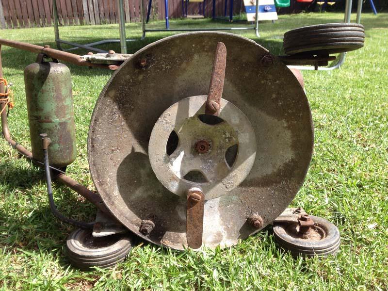

[2] The Chassis
This is not the run-of-the-mill 'toecutter'. It is mostly alloy.
The base is alloy with a very narrow skirt, and the alloy rails for the wheels
and height adjustment is most unusual.
The primitive height adjustment and lack of folding handle makes me feel that
this mower dates from about 1954 - 1956.
The blade holder is most unusual! It is cast alloy! I can't recall any other
rotary manufacturer that used this on petrol-powered machines.
There is a clue to identification in the fuel tank design. It appears identical to the
Pathfinder mowers that were sold through Myer Stores. The maker of the Pathfinder is not
known, but I have a suspicion it was a Melbourne manufacturer.
[3] Summary:-
I believe the mower is of Australian manufacturer (because of the base design).
The extensive use of alloy makes me think the manufacturer had access to a non-
ferrous foundry. The tank design is a clue that points to the manufacturer of
the Pathfinder mowers.
[4] Possible Suspects:-
The fuel tank design indicates a 'Pathfinder' link.
Other contenders are: Mi-T-Mow,Kleen-Cut, Eclipse and Park mowers.
Hope this somewhat helps.
JACK.

Another example of this mower has come to light, here are some photos. They are much the same as the previous ones posted but still good to have
I now have this one in my collection so I will have a good look over it and see what turns up.
Posts: 988
Likes: 7
The only similarity to be found so far is the fuel tank is identical on this Pathfinder mower
Hi Paul
I feel your, second machine, is a significant find.
There appears to be no decal traces suggesting this mower had a name!
This is the most curious of mowers - in that it does not conform to the 'usual'
design ideas for lawnmowers of the 1950s.
The base is all-alloy but in three parts. Who else did that?
The 'toecutter' base seems to have been cast for the the JAP engine.
The blade holder is a smaller alloy disc - compensated by longer swing-blades.
There is primitive height adjustment.
I now give this machine a time frame: 1955-1957.
This does not rule out a later mower - for specific purposes.
I hope we get a break-through about this one.
