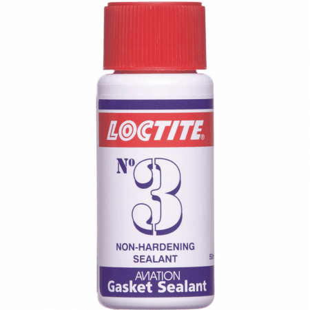

Unimog74 #61914 15/02/15 03:17 AM
I've always used,and have for a long long time,as far back as I can remember,I've used this:
Unimog74 #61916 15/02/15 04:52 AM
Yep thats him. Cheers Gadge for the clarification....:)
Spot on Blumbly, Basically the Same product just in Locktite Brand.
Been using this for over 20 years, I buy in bulk so I get the Permatex cheaper than the Locktite
Thanks Guys...
