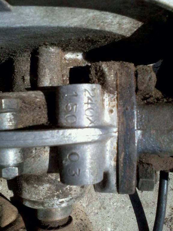

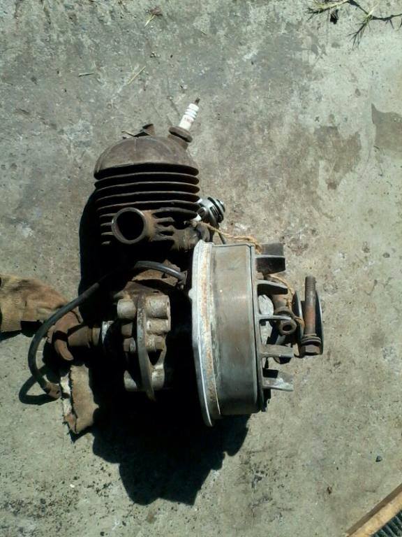

Hello,
I'm chasing some info on a 240X 15 03. Block is 3812 88898 V2. No idea what it's off found it in the shed.
Cheers!
Hi fishngurudes, and a warm welcome to the forum. grin
It's nice to have you aboard, as we all like to learn new things and tinker here. wink
To enable us to identify your engine, could you please post some pics?
Instructions for posting pics using our inline uploader and be found HERE
Once again fishngurudes, :welcome: to OutdoorKing.
Joined: Oct 2009
Posts: 40
hello, engine spec. 240x should be a mk3 midget engine,supplied to Taplin. I have no idea
who taplin was or what they supplied. it was fitted with a v148x3e air filter and a
b118au/1 cowl. regards,john
