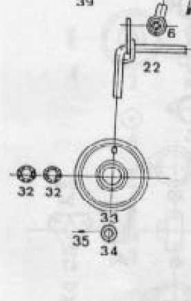

steffan, if it is the same as the one in the owner manual I quoted previously, the parts look like this:
The two Items 32 are the wheel bearings. Item 33 is the front hub. 34 is the collar that holds the wheel bearings on the stub axle. 35 is the grub screw that holds the collar on the stub axle. So, you loosen the grub screw with an Allen key, then slide off the collar. If the stub axle is rusty, you'll need to use some penetrating fluid and let it soak for a while first. Then you can slide the hub off the stub axle, with the wheel bearings still inside the hub. Once the hub is off, you pull the bearings out of it, using more penetrating fluid.

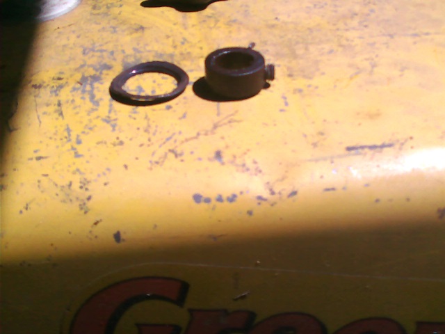

Thanks for that. The grub screw is loose and the ring (hub) where the grub screw was in cam loose (see pics) and a sort of a collar came loose. Any one knows the next step? Get the whole wheel of? Is there a trick to this?
Now that the collar is off, the wheel will slide off taking both the wheel bearings with it. Then you can extract the old wheel bearings from the wheel hub.
That loose piece between the collar and the wheel bearing is supposed to keep the dirt out of the wheel bearing. It may once have been part of the wheel bearing.

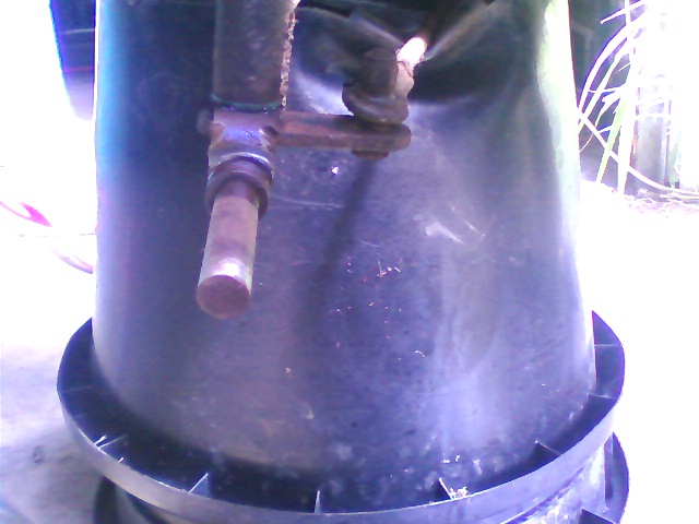

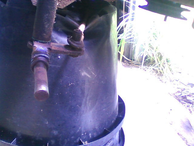

Allright got most of it of. I found that there was only 1 bearing in tact, the other one has just a view bits and pieces.
Now on the back of the shaft is still a ring left. Is that supose to come of aswell?
Thanks in advance Steffan [Linked Image]
That is the inner ring of the second bearing: the one that broke up due to wear and neglect. You need to get it off, which may be difficult. First step is to soak it with Penetrene or another high quality penetrating oil. Leave it for a couple of hours or more, then try to lever it outward with a couple of screwdrivers behind it.
