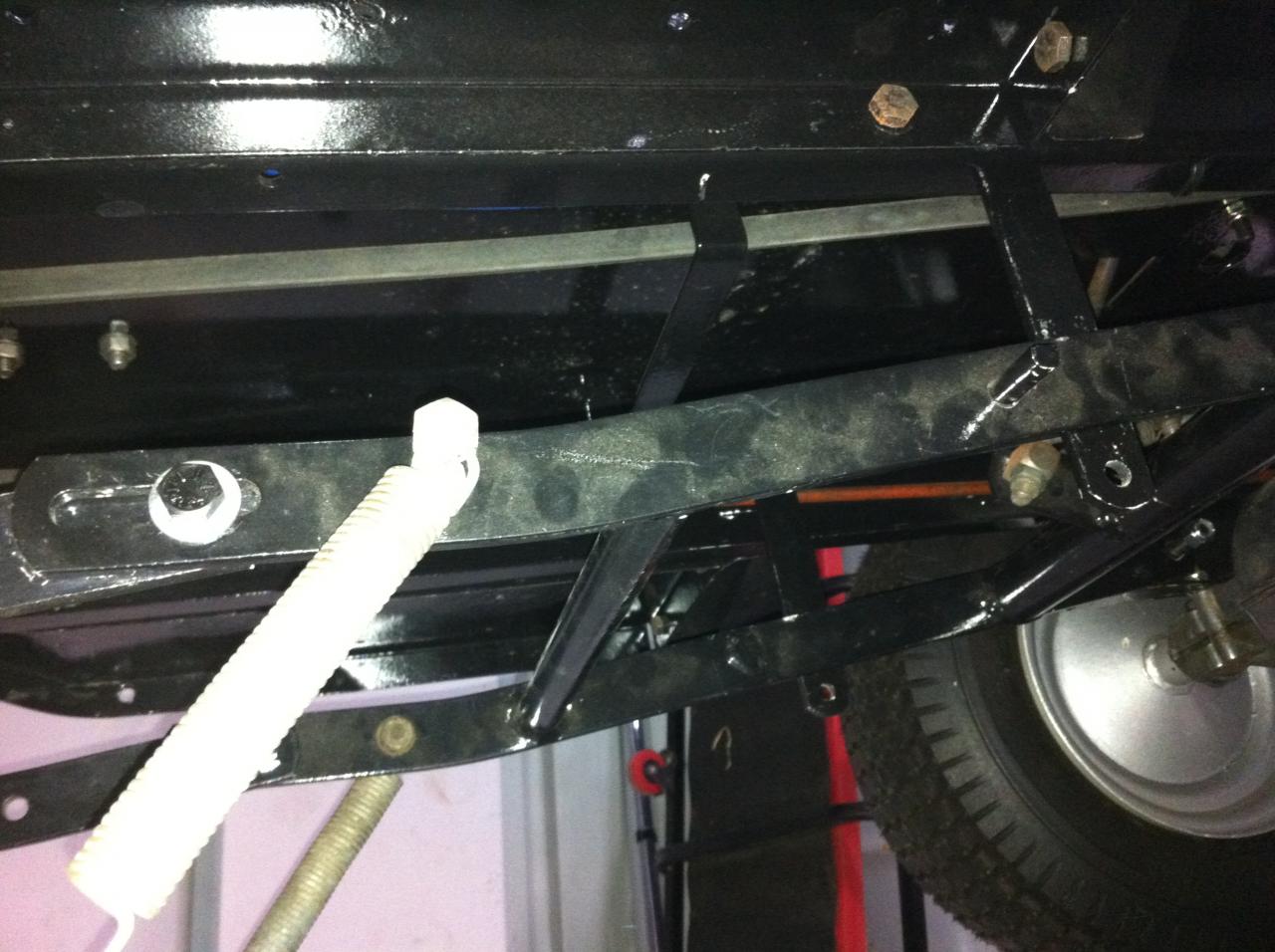

Hi Bob, it is a single deck. There are two L shape brackets, No. 18 in first pic, this is what the red arrow is pointing at. The second pic shows it a bit clearer. I am not sure if they need to be on the inside or the outside of the cutting deck lifting frames?
At first I thought maybe an inner support for the rear deck hanger mounting bolt. They sorta line up in the parts list you put up. Couldnt see how it would work and neither of mine had anything other than the hole in the plate for the transaxle to mount to and a spacer/collar.
Looked on the computer for pics of any ranchers ive pulled apart. Found pics of an autodrive, its got real similar to the older ones.
Then I remembered that I had a PDF for a Rancher on my PC.
I just had a look, ive got the PDF for the 1766 & 1744. whats the one you put up, the pics were slightly different in mine.
Part 20, transaxle support bracket.
On the back corners of the transaxle there are two threaded holes. Thats the bottom of the brackets.
The tops go in two holes in the rear of the frame at bolt 26.
They stop the transaxle from rocking.

They are the rear transaxle support. I have had the transaxle replace and those threaded holes are no longer there. Also the support arms do not match up with the threaded holes. Will pull it all down and check everything. Thanks for all your help.
Thats them there

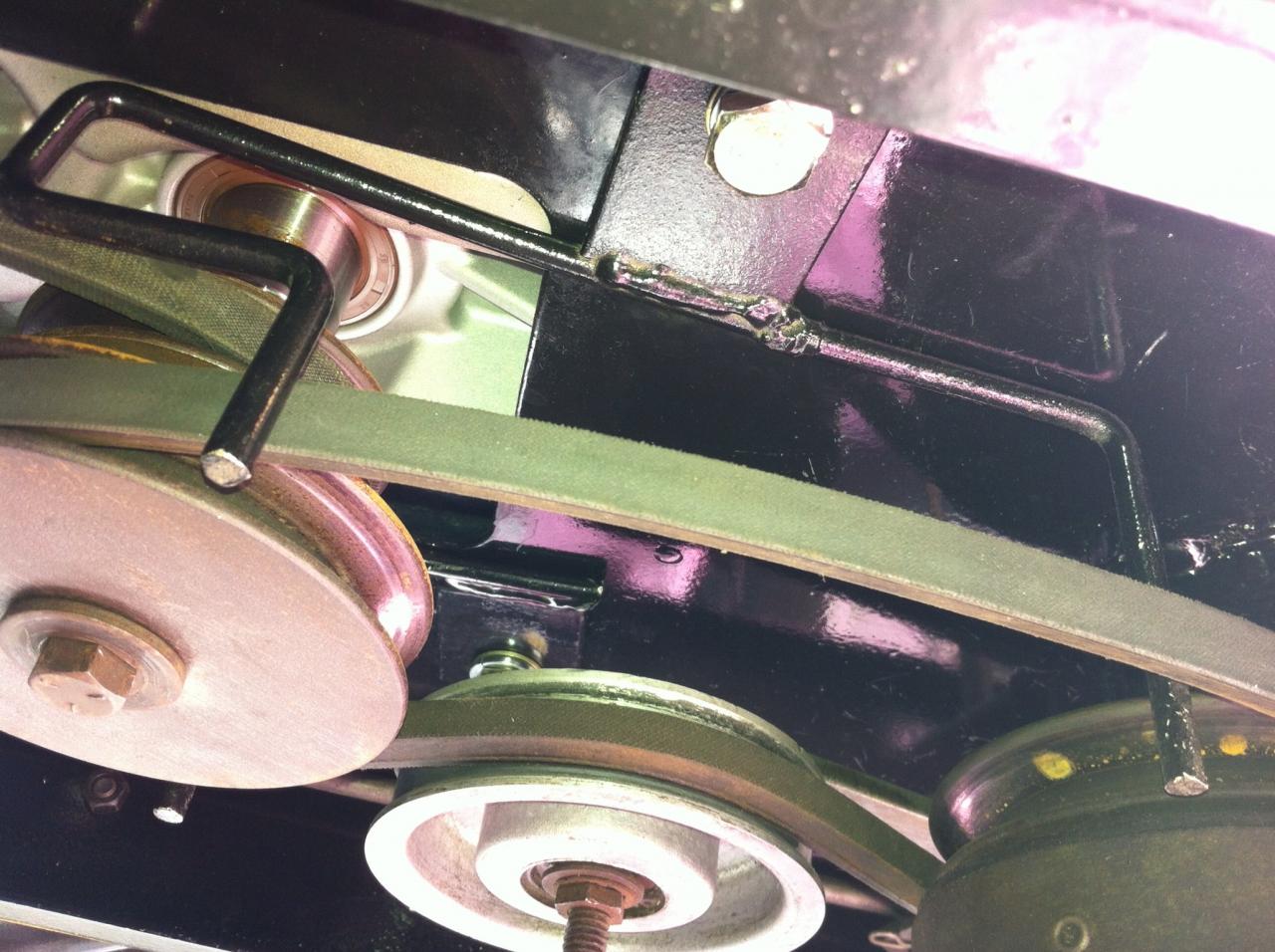

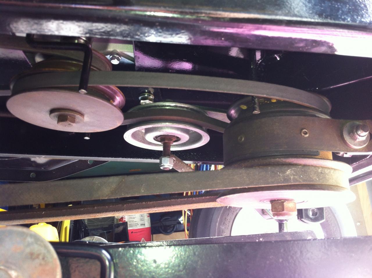

Have put the guides in and below is a couple pics showing the belt looseness. The drive pulley is engaged and there is still a lot of slop in the belt. These belts were put on new when the mover was given to my father in law. He had it a couple years before he passed. They don't look stretched, but then again I am not qualified to say if they are or not. Your thoughts are appreciated.
The belt is the wrong side of the pin at the front idler pulley, 3rd & 4th pic. And Id have it in a bit closer to the engine pulley. Less than half the width of the belt. Almost touching even.
Adjust the linkage to the PTO lever to make the idler throw in further.
Is the drive belt too loose as well???
In pic 1 & 2 id adjust that zig zag shaped bit of the bar to go in closer to the belt for the transaxle drive. Thats its run on side where guiding it onto the pulley is the main priority.
