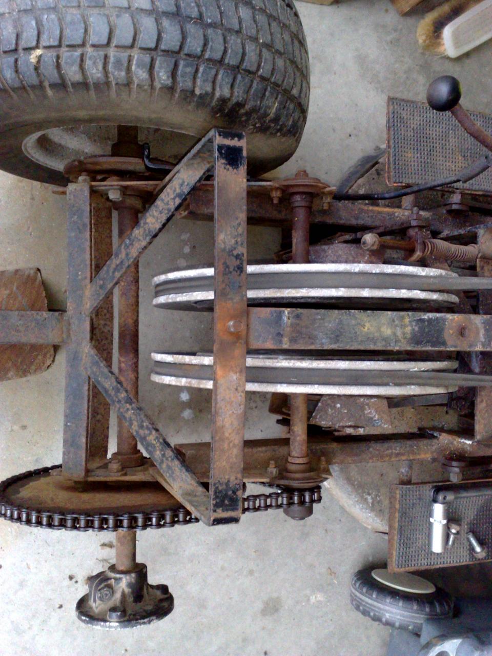

Tentimes, one of our members, aldot, has a Tractor 11 and can probably tell you the answer. If he doesn't join this thread you could send him a PM. Here is the chain drive on another member, KeithB's, 11-28:
The chain does look rather wide, but of course it may not be the original part - fitting wider chains and matching small sprockets could conceivably be a popular modification. However in the case of extreme chain drive ratios like that, I suspect that having a wide small sprocket might greatly outweigh the wear-life advantage of having the chain match the width of the large sprocket. I don't think we have ever had a completely worn-out large sprocket reported here.

With regards to the pic posted by Grumpy, it appears to be the same as the unit I have in my shop. 5/16 drive sprocket and chain, running to a 3/16 axle sprocket, so at least I'm not dealing with anything unique.
I agree about the added load capacity of 5/16 chain and primary sprocket and how this may have been a cheaper or more easily available solution, but chains are sneaky, devious little buggers that delight in going their own way, with the slightest provocation and usually when it proves to be most inconvenient. If you look at a rating curve for a chain, it's load capacity just about falls off a cliff as soon as you have any torsion (twist). Running a wide chain on a narrow sprocket (in this case 40% narrower) and running it in a hostile environment, is a good recipe for torsion.

I don't think it's a major problem, tentimes. Yes, the chain can wander from side to side on the axle sprocket, which will give uneven loads on the chain's sideplates, thus shortening its life. However because the sprockets are so close together, I don't think there is much opportunity for torsional oscillation as well.
