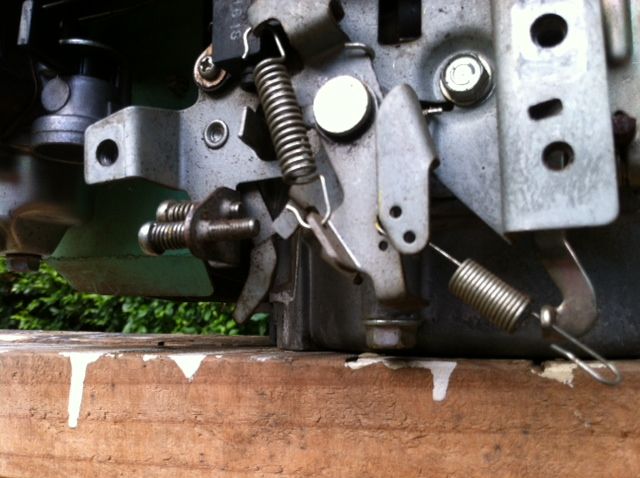

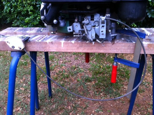

I am having some issues with this engine and its idle. It has sat for a few months so I cleaned the carb out, little bit of gunk main jet was slightly occluded. I cleaned up the fuel tap, tank filter and threw on a new air cleaner. It is a low hour job that I purchased for an engine swap but it has the one inch shaft so that's why the project has taken a while.
It starts and runs with no issues but it idles at 2800rpm by my tachometer. I have taken some pictures of the throttle linkages so that you folk may be able to help.
Any issues with the setup?

With regard to your original problem with idle speed, is the idle speed screw making contact with the idle stop when the speed control is set to idle? I notice that your governor spring is not in the hole shown in the workshop manual, at the speed control lever end:
Did you check that the governor arm is correctly set in relation to its shaft?

With regard to the sudden speed increase rather than it happening smoothly, I suggest you look closely at the set-up of the throttle cable and the speed control linkage. In the picture you posted, there seemed to be excessive slack in your governor spring when the cable was in the stop position, and the kill switch was being heavily mashed by the link that operates it. If you adjust the cable so that the kill switch is just operated relatively lightly at the extreme rearward movement of the speed control, the dead band of the speed control should be reduced.
