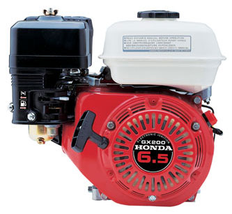

I am willing to lay down a bet its acopy of one of these....
Anyhow, I have found with a lot of them, the fuel system gives a lot of grief, the plastics arent up to fuel grade standard most of the time and either is any rubber hose or seal, On a couple of water pumps we replaced worn out hondas, we put on a copy engine then took the entire fuel system off one of the genuine engines and havent had a great deal of drama...

The 168-F1/2 Chonda looks as much like the GX200 as it does like the GS65, Joe. I don't know what the differences were between those two Honda engines anyway.

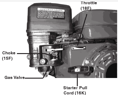

We can go through a carburetor tune-up process in this thread if you like. I don't have the carburetor in front of me, so we'd just be working from pictures you'd post plus the manuals. Meanwhile, you did turn the fuel tap ("gas valve") fully on, didn't you? (Push it fully to the right, as shown in the sticker near the tap):
A fuel tap that was turned off but leaked, or one that was internally mangled and just didn't work, might explain your problems. You could test the fuel tap by removing the drain plug low down on the front of the float bowl and checking the flow rate of fuel after allowing time for the float bowl to empty. The fuel should flow full stream with the fuel tap on, and stop with the fuel tap off.
