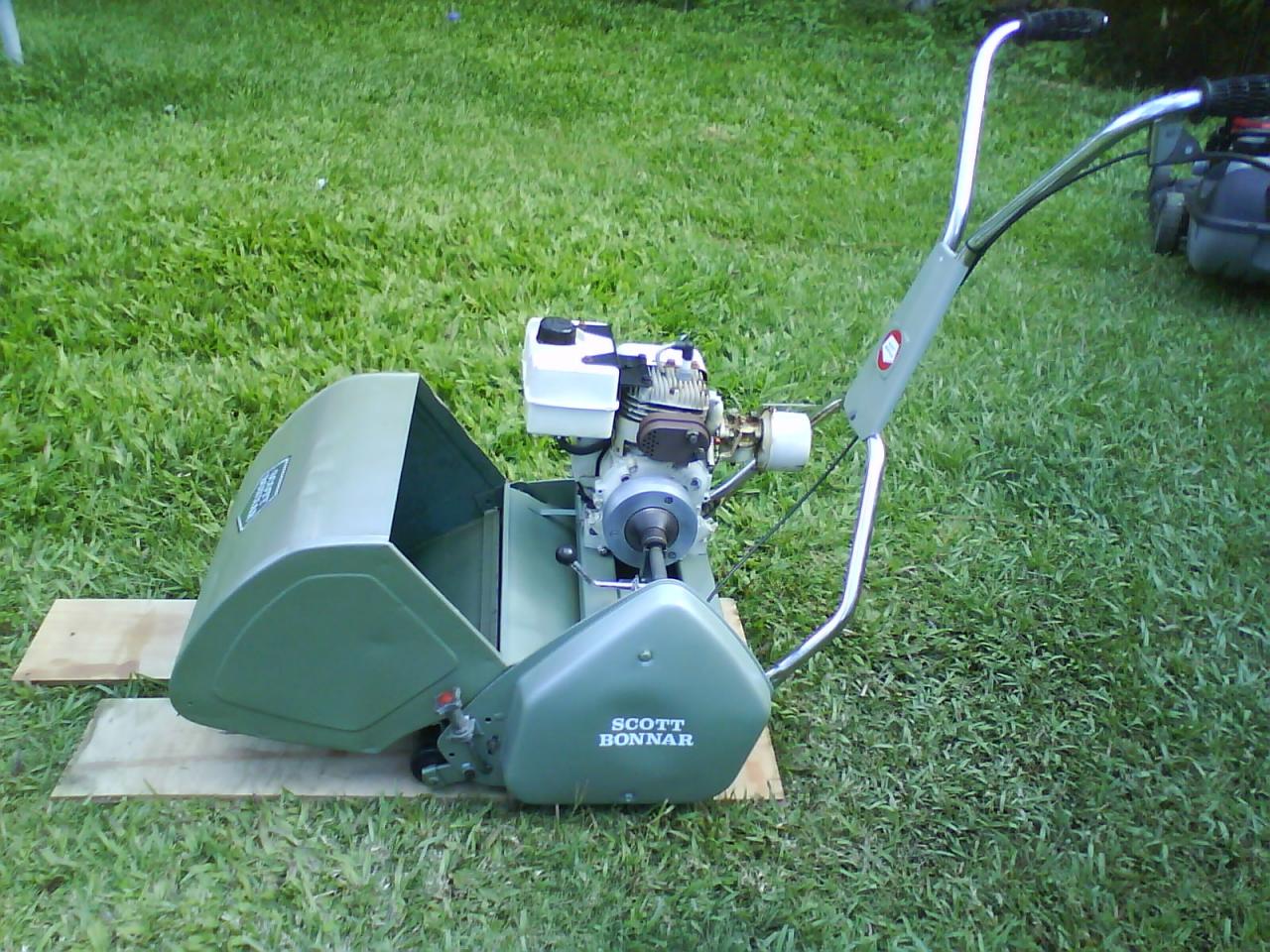

Here's a photo of my restored mower.
Yet to try it out on the lawn but it runs well.
The catcher has not been panel beaten; this is for a future project as is the motor restoration.
Dave
Reel Mowers do it better.
Hi Dave and congrats on a job well done mate; you have persevered with your restoration and the end result is "Just like a bought one" She looks a treat....well done mate! grin
I can't wait till she gets to work on that lawn of yours Dave, don't forget to have a mowing regime....and that is; never mow in the same direction twice. In other words, and this is for cylinder mowers...mow on both diagonals, straight up and down, and back and forth side to side......this encourages the grass sward to intertwine and the result is a flat but undulating surface that is lush, with stripes...and the envy of the street! wink
