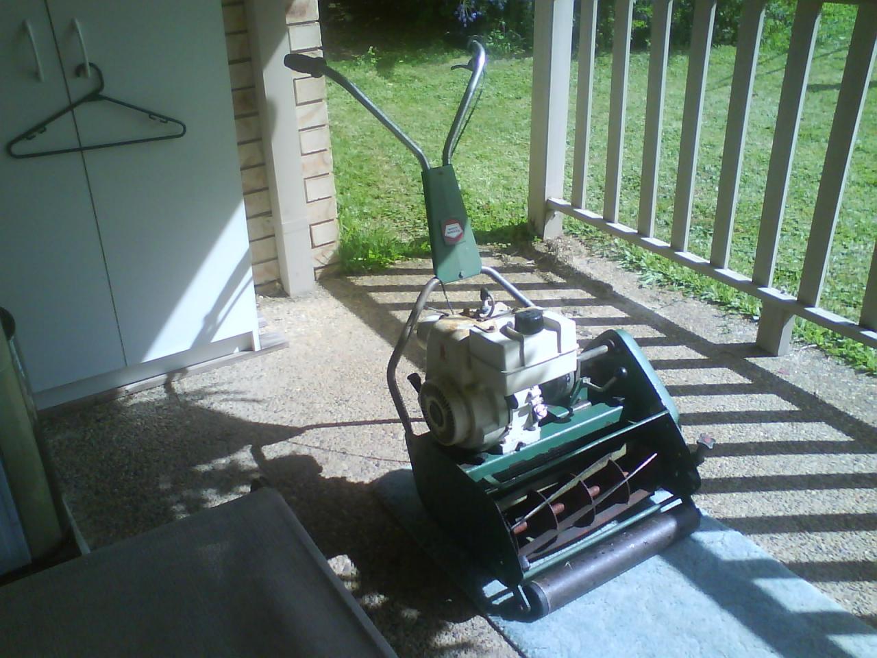

Hello, I have recently purchased a Scott Bonnar 45058 cylinder mower S/N 3951115, powered by a Tecumseh engine H30-35311S Ser 0151B.
I don't know anything about the history of this unit, nor do I have any idea of its age. I paid $240.00 for this mower which may or may not have been too much.
I've enjoyed reading the forum posts here and I am confident I can get the unit working properly with a bit of advice and perseverance.
The engine starts easily and the mower actually cuts grass although the blade setting seems to be poorly adjusted.
I tried to adjust the reel down towards the sole plate but I appear to have run out of adjustment on the two srews. The blades don't look too worn to me so perhaps I am doing something wrong.
Anyway I thought I'd begin this thread with a few photos and update it as I progress.

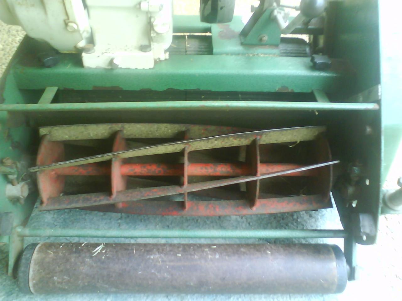

Perhaps a trained eye can give me an opinion on the state of the blades.

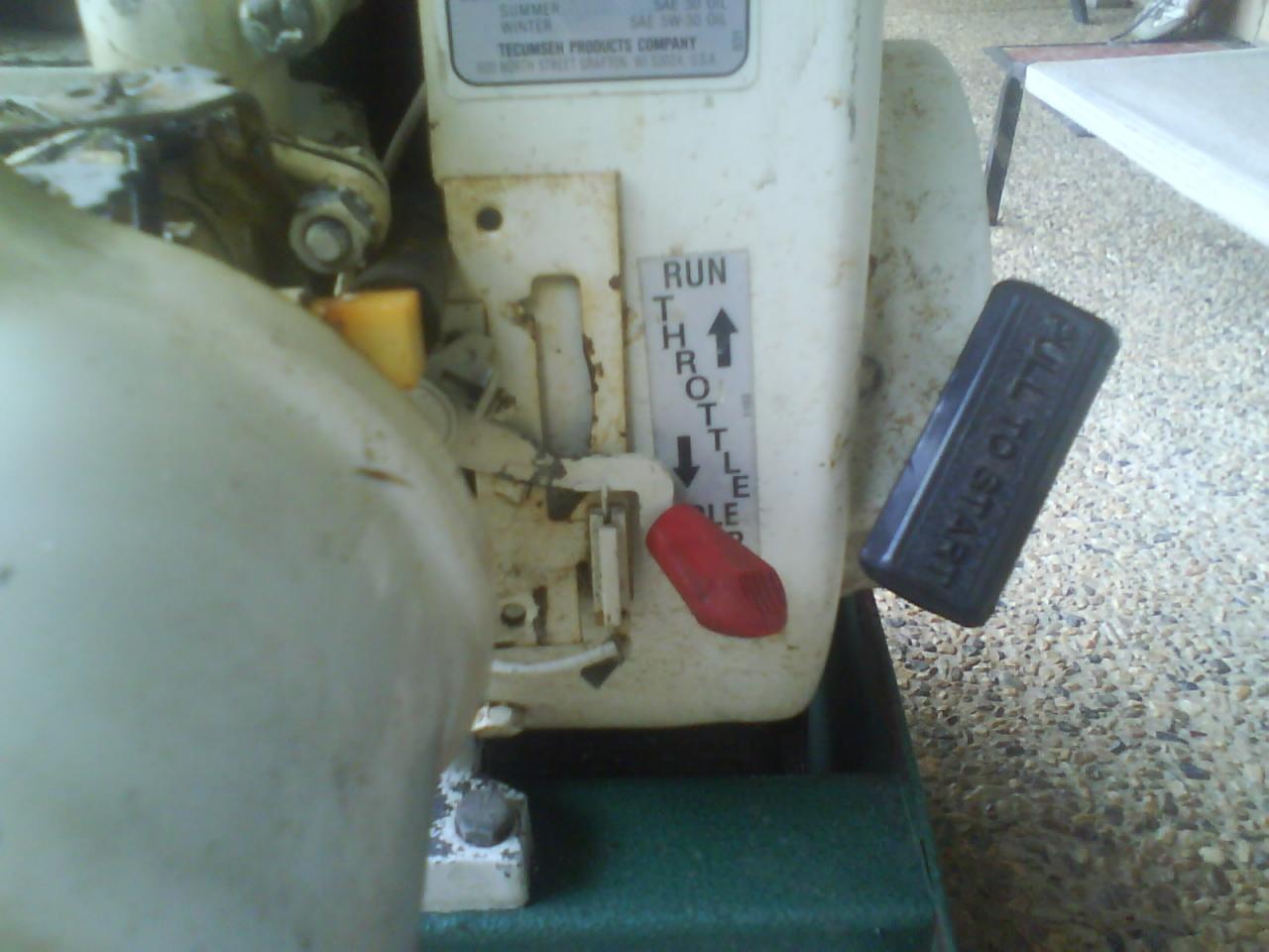

There is no throttle cable just this lever on the engine.

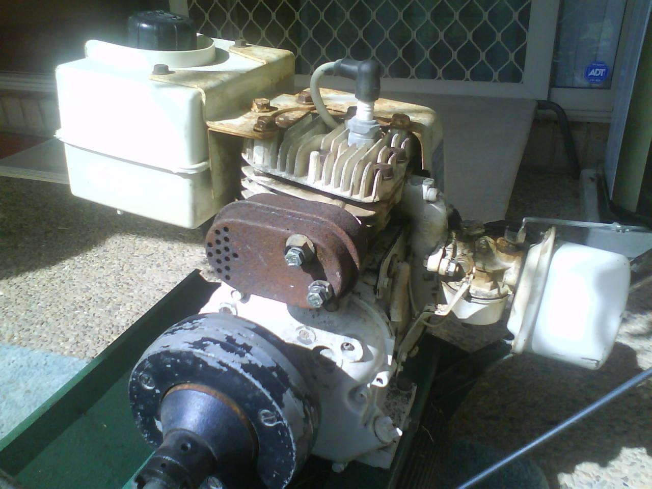

The Tecumseh engine.
Should there be a housing over the clutch and lever?

It is unusual, we have been discussing this on the forum this morning, with another member that has a 14" Model 45 (late model twin rail engine deck) with a 2HP Kirby engine.
This engine of yours may have been repainted at some stage...because SB has theirs painted in orange....See the pic;
[Linked Image] This is a 20" machine, but the colour is the same on all Kirby's.
Yours is painted white...I have never seen one in this colour scheme before.

The cylinder reel has plenty of life in it; but will need re-sharpening as will the bottom blade....check out the SB threads in the Repairs and Maintenance forum for instructions on Removal of the reel and soleplate. wink

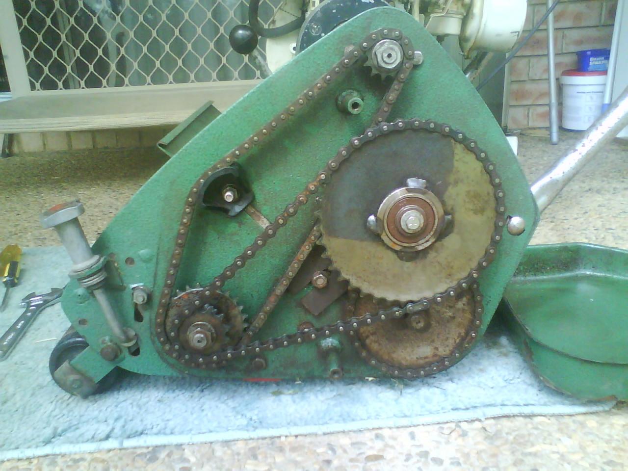

The photos below are not brilliant but it appears there is no damage to the cogs and there is even wear throughout.

Deejay, I think that is a later Tecumseh, made in the US, not one of the Kirby ones. The Kirby ones have a very distinctive air cleaner, visible in the picture you posted. Unless SB went through a period of fitting some Tecumseh engines in the latter days of the 45, it may have been re-engined.
Hi Grumpy, I think that may be the answer, I have never seen a late model Scotty with a US made Tecumseh....but who knows what they were up to, at that time...wish we had more records. cry
The plate on the engine states:
Tecumseh Products Company.
900 North Street, Grafton, WI 53024, USA.
I assume that is Grafton, Wisconsin.
It recommends OIL:
Summer SAE 30
Winter SAE 5W-30
Reel Mowers do it better.
Hi again Dave, I think this engine may be a later addition to your Scotty, if we could work out its date of manufacture we would have a good idea....however, I don't know how to date Tecumseh's....perhaps another member of the forum will. wink
I think Tecumseh did explain in their workshop manual how to date a lot of the later engines they made before they went belly-up. I don't know if Dave's white one is late enough to be included. Dave, if you post the serial number which has a few letters at the beginning, and the other letters and numbers from the same block of data, we can see if it features in the manual, and whether it contains a date code.
Thanks grumpy, I thought you might know the answer to that one....Tecumseh's are definitely not my forte`, so to speak.... wink
Joined: Apr 2012
Posts: 41
That is the information I needed, Dave. You have a horizontal shaft engine of 3.0 hp, made in 1980, 1990 or 2000 (the date code doesn't tell us which) on the 151st day of that year, on production line B. Presumably the 1980, 1990 or 2000 question is resolved by the type of engine it is. The "specification number" (similar to Briggs' "type") is 35311S, and in combination with a parts list I don't have, that might give the answer. However I think a 2000 engine would be a low emissions type, with a number beginning with "LEH" instead of "H", so it is probably 1990 (it doesn't look old enough for 1980 to me). Very likely a serious Tecumseh guy would recognise the engine, or its paint colour, or some other feature as we often do with Briggs engines, and know which decade it was made in.
Hi grumpy and Dave, well, that clinches it, the Scotties were using Briggs and Stratton exclusively in 1980 and by 1990, Rover had been manufacturing the 'Rover 45' for quite some time. (Different colour scheme and Briggs engine)
So Dave's machine has been re-engined at some time...it would be interesting to find out what happened to the original Briggs....perhaps it was like mine, which was a real lemon...right from day one. wink
Good to have a result, guys....well done!

Some more pics.
I don't see a problem with these sprockets.
Reel removed and the sole plate was next which I found surprisingly heavy. These mowers were very well built.
The chain also appears in good order.

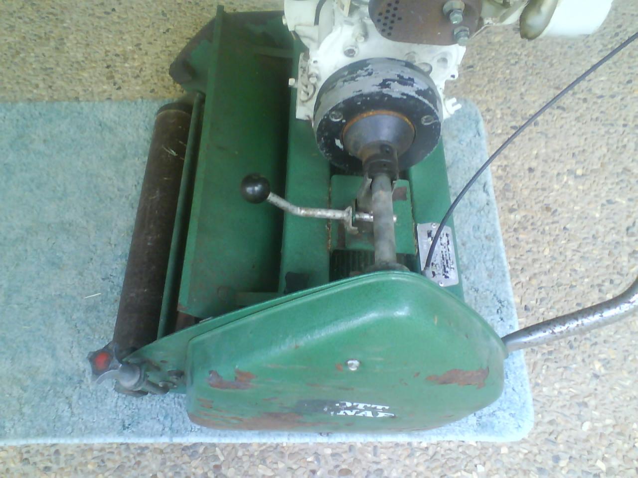

Well, now I have her stripped down to everything except the back rollers and the shaft from the motor.
I can't figure out how to loosen the nuts holding the last two sprockets in place.
This is the nut holding the sprocket at the end of the engine drive shaft.
Here I am pointing to the nut holding the rear roller sprocket.
I am unable to move the nut on the rear roller even when I can stop the roller from turning. The nut simply won't budge and if I try in the clockwise direction (left hand thread?), I can't stop the rollers from turning.
With the other nut, I can't get enough grip on the drive shaft to loosen that nut, the shaft just turns - I have removed the engine.
Anyone resolved this in the past?
Dave
Hi Dave, you normally crack all the nuts before you remove the chains, as you have found out, it is difficult to do after the chains have been removed. frown
However, mate, have faith that you are not the first to do it, nor will you be the last. grin
Righto, to get you back on track....
First, apply plenty of WD40 or CRC, Penetrene etc, to the sprocket nuts in question.
(2) For the engine sprocket....You need to arrest the engine clutch shaft with a pair of vice grips or stilson wrench to stop it turning. Use the correct socket spanner and undo the nut...in a anti-clockwise direction it is a right-hand thread. wink Tip: use some bicycle tube or scrap rubber between the jaws of the wrench or grips to help stop marking the shaft.... wink
(3) For the roller sprocket....place the correct socket spanner with a right-angle bar on the nut (after its good soaking as above) and give the bar a sharp hit with a hammer in a anti-clockwise direction....you don't need to hang on to the sprocket with you hand whilst doing this....a good sharp hit should crack the nut and then unscrew.... wink
Please let us know how you get on Dave,

I am also repairing/restoring an old SB45 fitted with a Kirby-Tecumseh engine, though mine is a 14" cut.
The two bolts that you indicate are both 3/4" right-hand thread. As Darryl suggested, I left the chains on, clamped the drive shaft and after liberal amounts of WD40, off they came.

Joined: Apr 2012
Posts: 64
Might be my turn to make a correction.
The two nuts I'm referring to are the ones on the end of the drive shaft and the one on the end of the reel drive.
I'm about to attack the drum nut as we speak - I'll let you know what happens smile

Joined: Apr 2012
Posts: 64
Yep - standard 3/4" RH thread.
I cleaned the tip of the shaft first so I could look at the last couple of threads and then braced the gear and very carefully and gently applied pressure. It came off quite easily.
