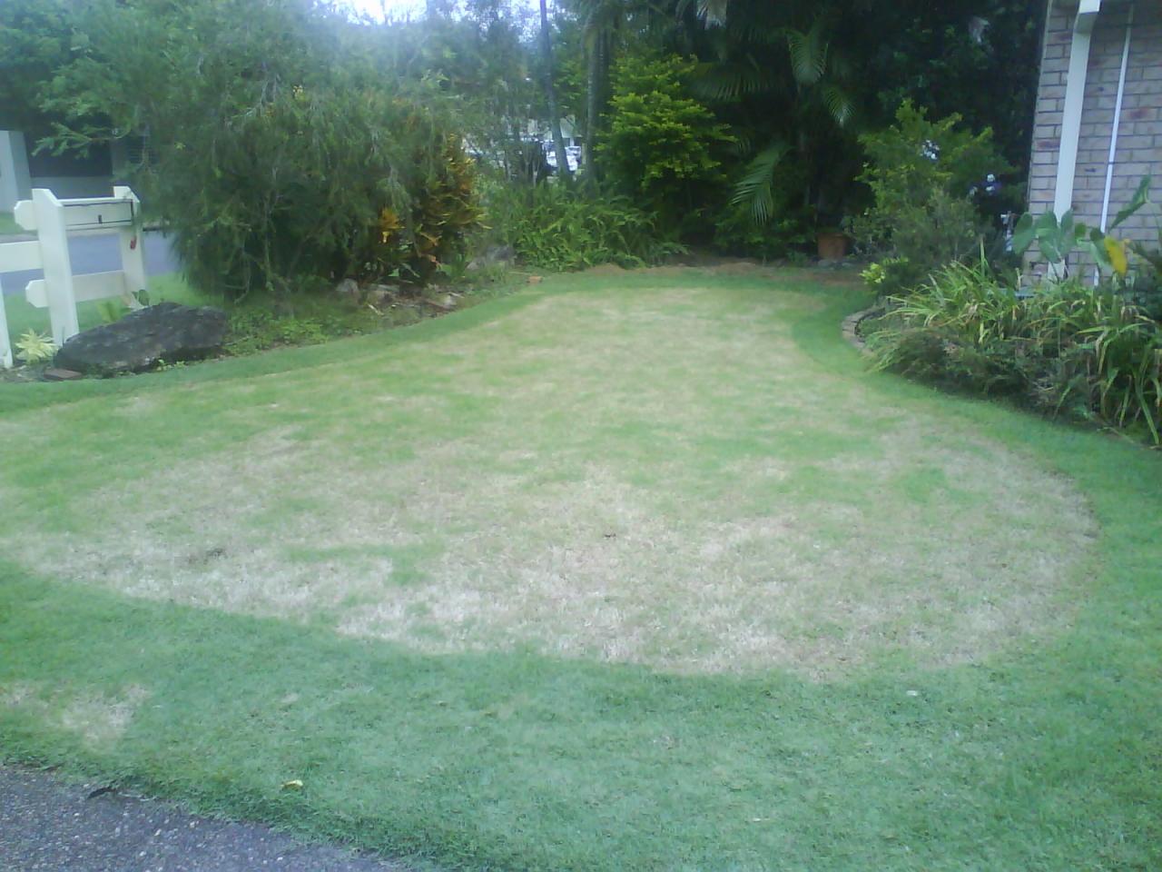

I bought it to build myself a putting green in the front lawn and just got carried away with the restoration - Addictive isn't it?
Still a lot of work to do there as you can see from the photo.
Will top dress this now that I have used the rotary to decimate it.
Dave

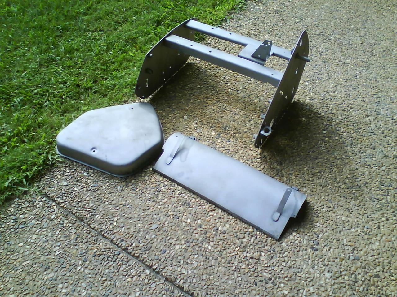

Hi all, this is just an update on my restoration project.
I got the mower back together but had these bits left over - Anyone know where they go?
Just Kidding!! I finally received the chassis, deflector and chain case cover back from the sand blaster and I am happy with the result. Have primed them and given them first coat of hammertone
More in a week or so.
