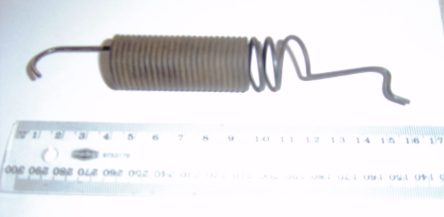

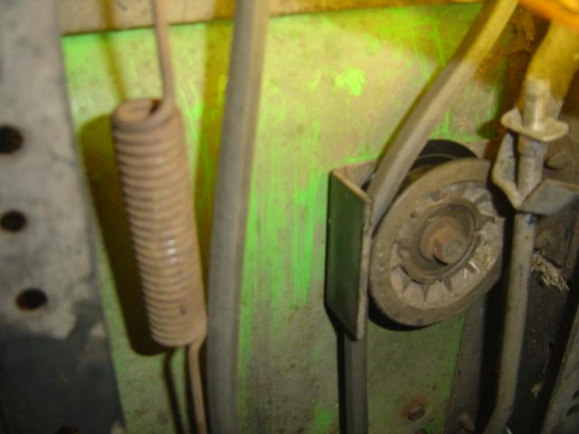

Ok, more on my MT44H, I have re assembled it and actually had it going and cutting , BUT, 1 spring keeps slipping off and mower stops moving. I have either got a worn spring or haven't reconnected it to it's proper location, this spring crosses from side to side of frame. Any ideas ?? [Linked Image]
The spring in your first picture is trashed, it is stretched severely and its end hook is completely destroyed. Whether or not anything else is wrong as well, that spring is useless.
It is stretched.
Not sure about the end. Some of them do have weird stuff.
More pics please. Can you open the pics in paint and do some coloured circles or something. Showing from where to where and the like.
I will have a look what i have here. I pulled a Viking apart yesterday. It wasnt a 444H But i might have something here that will work.
Most bearing/engineering supply places have a range of springs. You could guess the length and strength, you could test it weight for distance with an old style fish scale but keep in mind with those three pulled loops it will change things.
