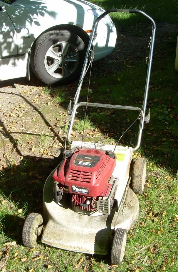

Hello all,
I have a 21 inch / 530mm wide cut mower that I wish to re-power, it is currently fitted with a Quantum XTL55.
I wish to purchase a Briggs & Stratton 850 Series I/C OHV 190 cc engine.

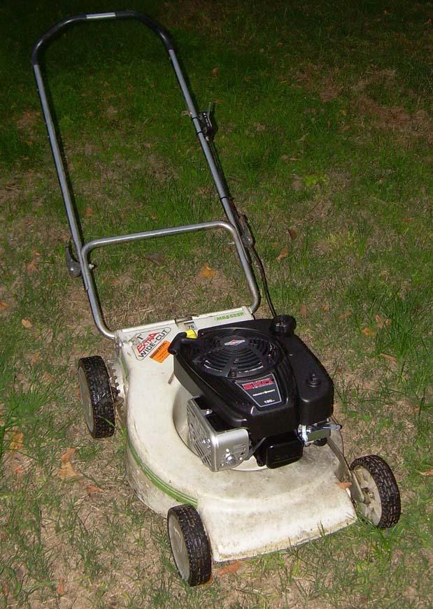

Hi All,
Thanks for all or your advice in this process of my re-powering the old Viking mower.
Today I managed to do the change over. It was a very easy process, and as suggest by Rodeobob the blade boss came off easily, via the use of the 3 legged gear puller. I had been worrying about this for weeks, as it had been in place since new (1997), however I hit it with some WD40 back on 20 Feb so it has had 3 weeks to soak before my change over works. I also used a product known as copper coat between the drive shaft and blade boss on the new engine so the two do not fuse over time.
I also hit the base with a high pressure washer during the change over, however due to the flash light it looks no better but is in daylight.
I also adjusted / straitened the muffler guard, as this was bent in the box from B&S as shown in my picture from 7 days ago. The throttle control is a temporary effort until I fit a new unit that will extend closer to the top of the handle.
The new engine started first pull and runs very smooth with lots of torque. Picture below of before and after change over.

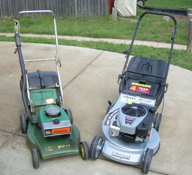

Joined: Feb 2011
Posts: 9
Hi All,

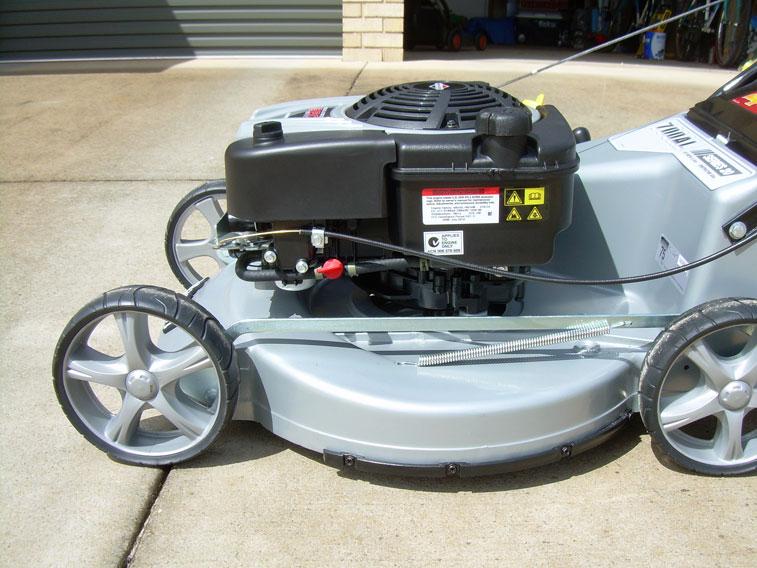

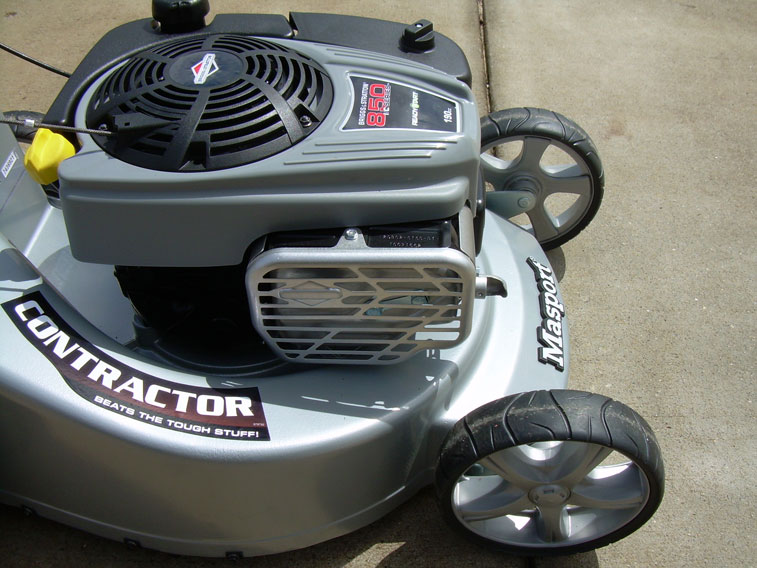

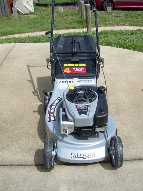

Since my post on 20 March above, I have used the repowered Viking for many hours and have found the 850 I/C OHV engine to be remarkable, it never runs out of torque in the rough stuff, is good on fuel usage and generally great to use.
I have been so impressed with the 850 I/C OHV that I have decided to go shopping for a new mower for my place. The Viking lives at my parents’ house, I have been using an old Series 70 Victa Corvette at my place.
I also should say that when I purchase a mower things that I look for are 4 blades on a disk, not cutting bars, alloy body not steel to avoid rust, plenty of torque, ball bearing wheels and an engine with an Iron bore for longevity. I decided that I must have an 850 I/C for my place on a new mower, and the only logical choice that checked all the boxes was the Masport 700AL Combo I/C. The 700AL Combo I/C has a 20 inch cut and comes with a mulching plug in addition to the catcher.
The Masport’s 850 has a different model/type code to that on the Viking. The masport’s is a 12Q902-0160-B1 in contrast to the Viking’s 12Q902-0149-B1.
The differences between the two 850 I/C OHVs are:
- 12Q902-0160-B1 has a fuel tap,
- 12Q902-0160-B1 has redirecting attachment on the exhaust tip to direct gases to the right,
- 12Q902-0160-B1 has a zone start lengthened starter, and
- 12Q902-0160-B1 has grey top in contrast to 12Q902-0149-B1’s black
I can report that this new Masport 700AL Combo I/C is great to use with plenty of torque and below are some pictures for those interested.
I bet that new masport does not look anywhere near as good in 30 years as the Corvette does.
