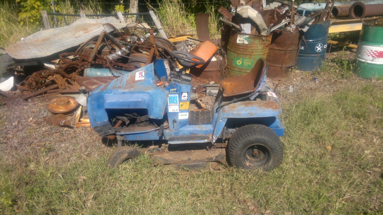

Hello I have Recently aquired this rideon. It is a 12 HP Victa, Serial no TD0401352 (under seat). I am hoping someone can help me identify model and year.[Linked Image]
If you could put up a few more images, that would be great, as well as any numbers and words on the engine, sides, hood, or anywhere.
Seems similar to this in my mind, have a look and tell me how close you think i may be:
I can tell you this about the mower in the picture i have put up:
12.5 hp Engine
Friction Drive
Electric clutch for the cutting deck
Heel Toe operation
40" Cutting Deck
As for the age, we may be able to help more with a few engine details you can give us.
I'm guessing its a briggs & stratton engine, somwhere on the cooling cowl of the engine (the metal cover bolted directly to the top of the engine) you will find a series of numbers stamped, if you pop those up, we can tell you a fair bit more about the engine, including its date of manufacture, whitch will give a good indicator as to the age of the entire mower.
Posts: 78
Hello the numbers on the briggs & stratton cowel are Model281707 Type 0213-01 Code 89062211
Well i can start you off with the Code, 890622 would be 22 Jun 1989 from what i know, there are others here that will be able to say more, I'm pretty sure your looking at 28 Cubic Inches (about 458.8cc)
The date of the engine would put it most likeley on an 89 mower i would say, or possibly early 1990, depending on how long beween the buld of the engine, and when it was put on the mower.
