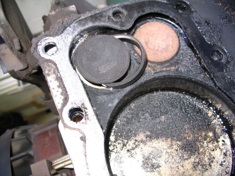

This is what greeted me when the head came off. Seat has come out of the head. Is this a job for the experts or something a DIY car restorer who has a bit of gear and good at improvising could takle?
Note also the amount of oil at the bottom of the cylinder (right side of pic) Normal or a ring job as well?

The replacement-or just reinstallation-of inserts isn't rocket science but there are a couple of special tools that you won't have and perhaps don't want to buy. Extracts from B&S manual follow.

I am used to seeing some oil in B&S combustion chambers and around the rings, because their oil rings are not highly effective, like those in a car. What matters is the ring gap.

Well - rough and ready fix. Rotated the engine until the insert was free sat it square under the valve and rotated engine and the valve pulled the seat partway into the head and a soft faced hammer finished the job. Now to prean over the lip as above and lap the valve in.
There may be dirt/carbon under the seat. First, this may make it come loose again. Second, obviously the seat is not guaranteed to be square to the bore now if there is dirt under it, so when you try to lap the valve you may find you can't get continuous contact all the way around.
If the engine hadn't been run with the seat loose, the odds would be pretty good. However it has obviously been loose from some time (the spitting on shut-down that went on for a while before it quit working completely) so I think there will be garbage under that seat. It might work anyway, though - time will tell.
being a bit of a redneck, I have done this repair before without even lapping in the valve, used the valve to hold the seat in nice and firm and just peened it as pictured.
I cannot reccomend my repair methods due to the nature of them, but for older equipment if tools and time is not available I just use what I can.
As for the oily patch, I would not be that concerned, maybe the rings are leaking a little, but just keep an eye on the oil level and she'll be right smile
