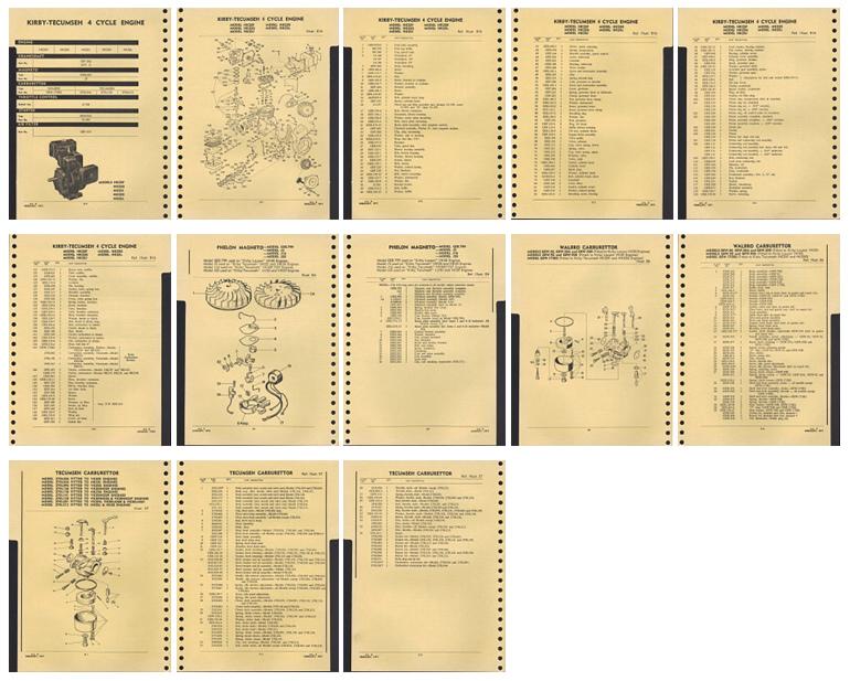

The original Imperials - 1966-1972 - were all powered by Kirby-Lauson-
Tecumseh 4-strokes. These were manufactured by James N Kirby, under license
from the American Tecumseh. The engines comprised mostly HK25 variants and
then the slightly larger HK30.

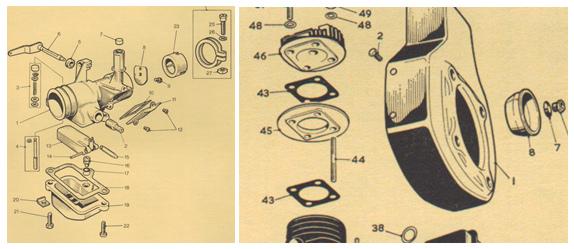

It would not be until the 1972-73 lawnmower season that Victa would
introduce their special version of the Series 70 Mark 2, 2-stroke engine
to the Imperials. This engine, fitted with a compression decompressor
(for easier starting), also featured lower compression (via a head spacer),
and a special version of the G3 carby (the 3-357), that removed the air vane
governor. It would appear that Victa were not prepared to spend the money -
or deemed it unnecessary - to offer a governed 2-stroke engine for the Imperials.
Why Victa would wait so long to use their 2-stroke on the Imperial is open to
speculation ...

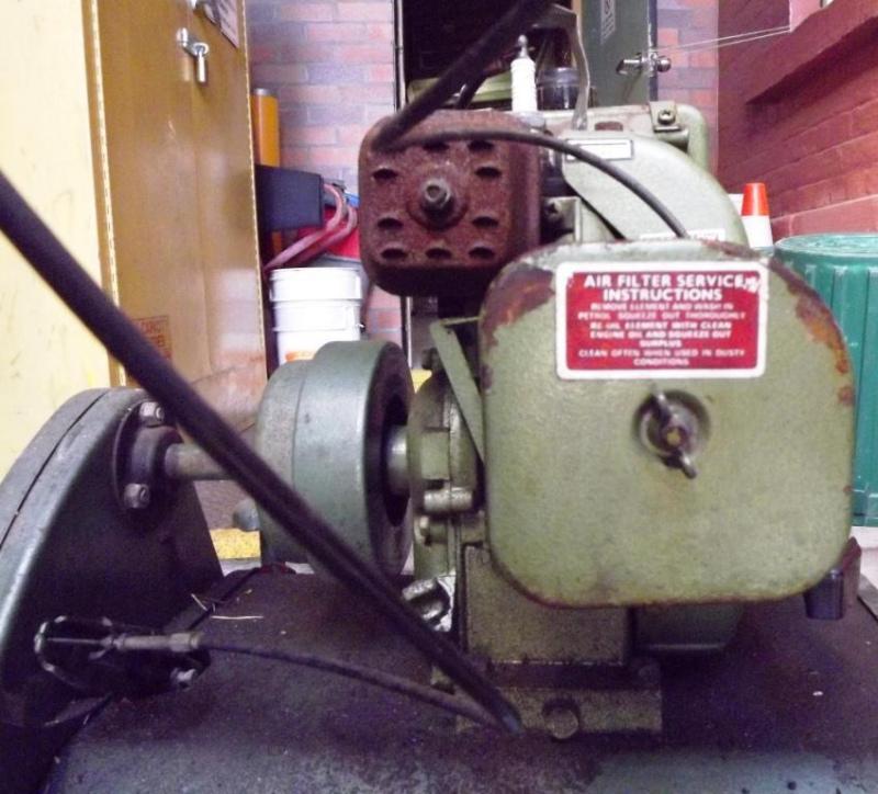

PART FOUR - The 4-Stroke Imperials
The main visual difference in the 4-stroke Imperials was the change to
the handle design, introduced for the 1970-71 season. The first, criss-cross
handle, was of a Ransomes design - and a good one - but it suffered from one
obvious defect: it could not be folded. The new handle permitted easy folding.
The only other significant change was to the Kirby-Tecumseh engine specification.
In the Victa Green Book (reproduced below) the carburettor is shown to have
changed 4 times! One can only speculate as to why ...
These first Imperials were finished in a most handsome two-tone green with
decals of white font on black and black font on orange.
PART FIVE - Kirby HK25 Parts List
VICTA IMPERIAL - KIRBY HK25 PARTS LIST

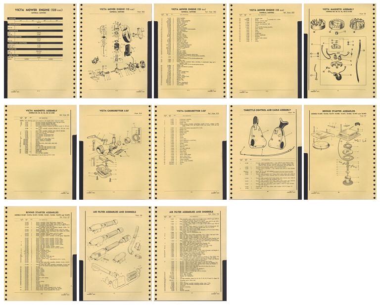

The main modification to that engine (for use on the Imperial) was the
addition of an alloy spacer between the cylinder and head. This reduced
the compression ratio; probably in order to smooth the power impulses of
what was a basic loop scavenge engine design. The result was a cooler
running engine requiring less lubrication, with Victa recommending
BP Zoom Outboard (50:1).
The other change was the removal of the air-vane governor from the
G3 carburettor. This was achieved by simply plugging the hole and
removing the small bevel gear set to make the un-governed 3-357
carburettor.
PART SEVEN - Victa Imperial 125cc Parts List
VICTAA IMPERIAL - 125cc PARTS LIST

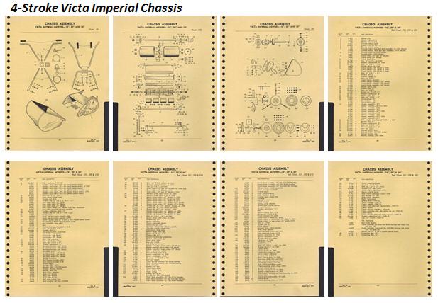

PART EIGHT - The Victa Imperial Chassis
The Imperial chassis was made of pressed and welded steel, giving it great
torsional rigidity. The design was based on the Ransomes Minor Mk 7 of the
late 1950s.
By 1973, Victa were offering four cut sizes in the line-up 14", 16" 20" and 24".
The 14 inch came with a single piece rear roller (no differential) and would
be the only size fitted with a single helix reel. The 16 inch was offered in
two variants - one with a single piece rear roller (no differential), and one
with a split roller (with differential). The 24 inch machine also came in two
variants - a standard model and a Heavy Duty model.
Transmission was via a primary centrifugal clutch on all models. Both the
second version of the 4-stroke Imperial and the 2-strokes would be fitted
with a heavier clutch-side flywheel. All Imperials had a secondary landroll
clutch
- a single plate clutch with three tension springs. The landroll clutch
was activated by a handlebar clutch lever. A sealed chain case housed the
three transmission chains and the landroll clutch.
CHASSIS PARTS LISTS
VICTA IMPERIAL - CHASSIS - 4-Strokes
