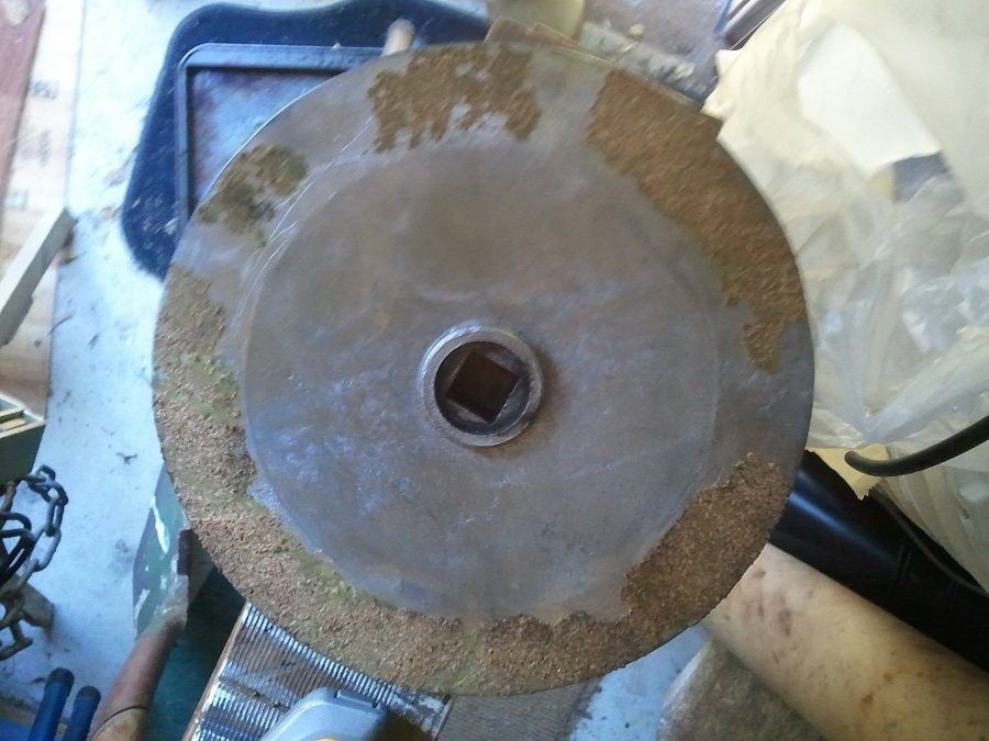

Last week I had a few spare hours so I decided to finally replace the cork liners on the clutch plates for my Tractor 11.
The hardest part was removing the old lining. I'm sure smarter folk out there have better methods but without getting too heavy handed I came up with this idea.
I used one of my old fish filleting knives and cut around the lining in such a fashion.

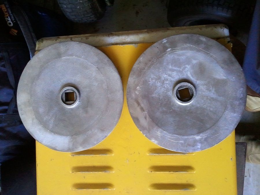

Once I removed most of the cork bulk I put a few mm of fuel in on old baking tray and plonked the plate in to soak for a few minutes. The fuel did a great job at softening the contact cement. The rest of the removal was a slow process involving removing a bit and then resoaking etc etc,

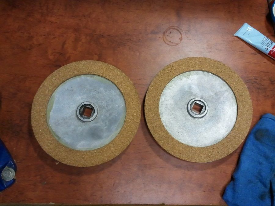

After a while I came up with the finished product
The scratches on one of the plates is from a prior attempt by someone. I usually try and limit damage to anything I play with. I take a steady steady approach.
I used a fast dry contact cement which I applied with a cheapie narrow paint brush. Coated both sides till touch dry then applied both surfaces together and slight pressure and I left them for a few days.
Hopefully I will have a nice responsive reverse pedal which is what I was lacking.
I might have to play with shims upon axle reassembly due to the thicker pad material. If that's the case I will add the detail here.

With regard to the contact cement and the cork clutch linings, I use a method something like yours but as I recall, acetone works vastly better than petrol as a solvent. My experience has been that life's too short to spend removing cork a bit at a time, when acetone strips it off in moments. To attach linings I let the contact cement sit for just a couple of minutes, it is still quite squishy, then I clamp the parts together for 48 hours. You have to sort out some suitable packing, flat pieces of wood to squeeze it between, and lots of clamps, ahead of time. You need even pressure from equally spaced clamps. If any extra glue squeezes out, I clean it up with acetone while the glue is setting.

I have managed to pick up some genuine shims and reassembled the clutch drive. I spoke to a guru who has done this quite a few times and his recommendations were; when pressure is applied to the clutch plates shifting the whole assembly against one drive plate, the opposing drive plate should spin almost freely with minimal contact against it's mating clutch. Do the same thing on the opposing drive plate. I have managed to pretty much get that spot on. All this has to be accomplished with the least amount of play for the sliding clutch assembly. Otherwise there will be too much pedal movement.
I had pretty good pedal travel on the old plates as I shimmed them up about a year ago. With new cork liners I had to fit 0.5mm of spacers to both sides. I chose to do this with two 0.25mm spacers per side for easier adjustment down the track as it wears.
