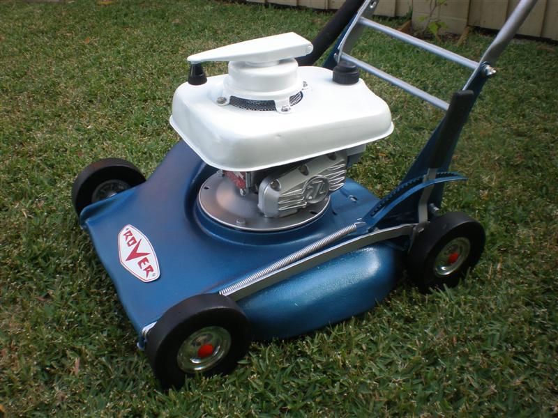

HAPPY NEW YEAR EVERYONE !!!!!Finished this on weekend , could anyone ID it for me please ,year and model name ?, has Kirby Tecumseh engine .
Engine should be painted white , but I personally cannot bring myself to painting any machinery white , I even had to toss a coin about the cowl/fueltank colour and I lost the toss .
Hope you like it as I am happy with it , have not found a starter for it yet but to me it looks OK with a pulley. Al[Linked Image]

Interesting - and good-looking - machine, especially for a Rover. Seems as if it would have had an impulse starter - in my opinion the pulley looks horrible. Engine seems completely unfamiliar - is that a 2 stroke Tecumseh?
alwil #32492 09/01/12 09:05 AM
Hi Al, It is an unusual machine....I have never seen one like it....I have to agree with grumpy...I am not too fond of the pulley either...but, until we can identify the model and what starter it had originally, the pulley will have to suffice...
congrats on another nice resto, mate! grin

Yep , two stroke MODEL No. KAV74 , SPEC No. F6684 , SERIAL No. 12308852 , I agree ,it would look better with a starter , anyone have one ????? Al

I have done a bit of digging for you, I can't find much on the mower itself, though I have some information on your engine.
Power: 3.3hp (@3200rpm)
Bore: 2.3125in (0.005in Wear Limit)
Stroke: 1.769in
Main Bearings: Ball Race
Big end Bearing: Needle
Small End Bearing: Caged Needle
Intake: Port Controlled
Carburettor: Flywheel Airflow Governed
Spark Plug: Champion J18Y or equivalent
Timing: 0.080in btdc
Spark lug Gap: 0.030in
Points Gap: 0.020in
All I can find so far about the mower leads me to think you have an early Rover Super 2, possibly 67-69, hopefully more will come up.

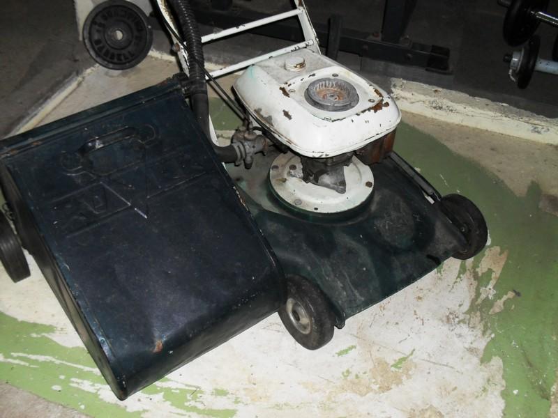

I have one here the same base, but with a Briggs on it.
I also found a catcher that someone knocked up for it. I will grab some pics of the catcher, been meaning too for a while.
I think Ty has the big brother to this one.

anyway thought i would share my rovers .mine has a villiers engine,muffler and tank. different again?the early 60s had a triangular badge whilst the later 60s got the rounded version.always thought it would look great restored. now i know for sure. yay

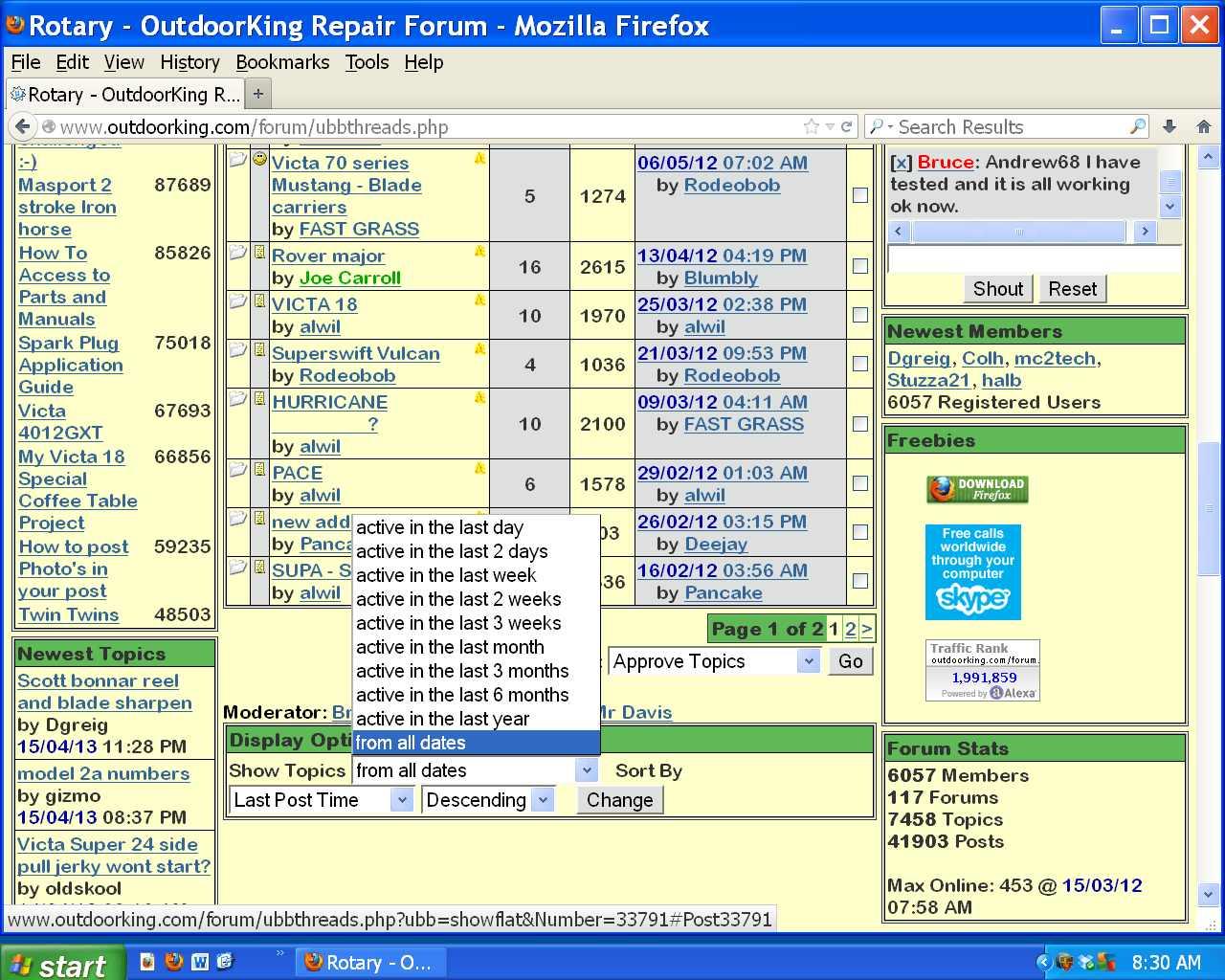

Hi Gizmo, and thanks for posting your pics. I particularly like the last pic....Wow! look at the size of that engine! shocked
To help you navigate around the site...here is a tip; when you view the first page in a forum....showing all the forum topics, click on the topic you wish to view, in this case: Collectors Corner > Rotary ....then scroll right to the bottom of the page and look for "Display Options"....click the blue button at the end of the box "Show Topics" and select from the drop down list : "from all dates".
Like this: [Linked Image] and then click "Change"
You will the have access to all the posts in "Collectors Corner" You can do this in all forums. wink You will find some very interesting posts in the archives. wink
Hoping this helps...
