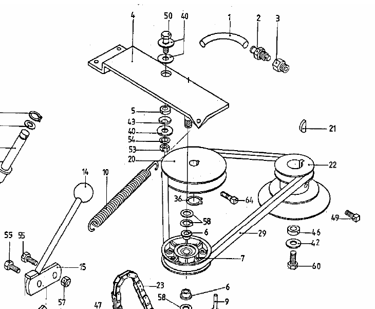

Those are the correct part numbers as shown in the Colt illustrated parts list. There is no real illustration of the cutter belt, but here is the wheel-drive belt:
Joined: Oct 2012
Posts: 6
Thanks Grumpy. Ive tried to fit the belts as suggested but both are definitely too long at least by 2 or 3 inches. The pulleys all look factory and as per diagram you posted. I will measure the belts themselves to check what Ive been sold. The model plate definitely shows 73113.
