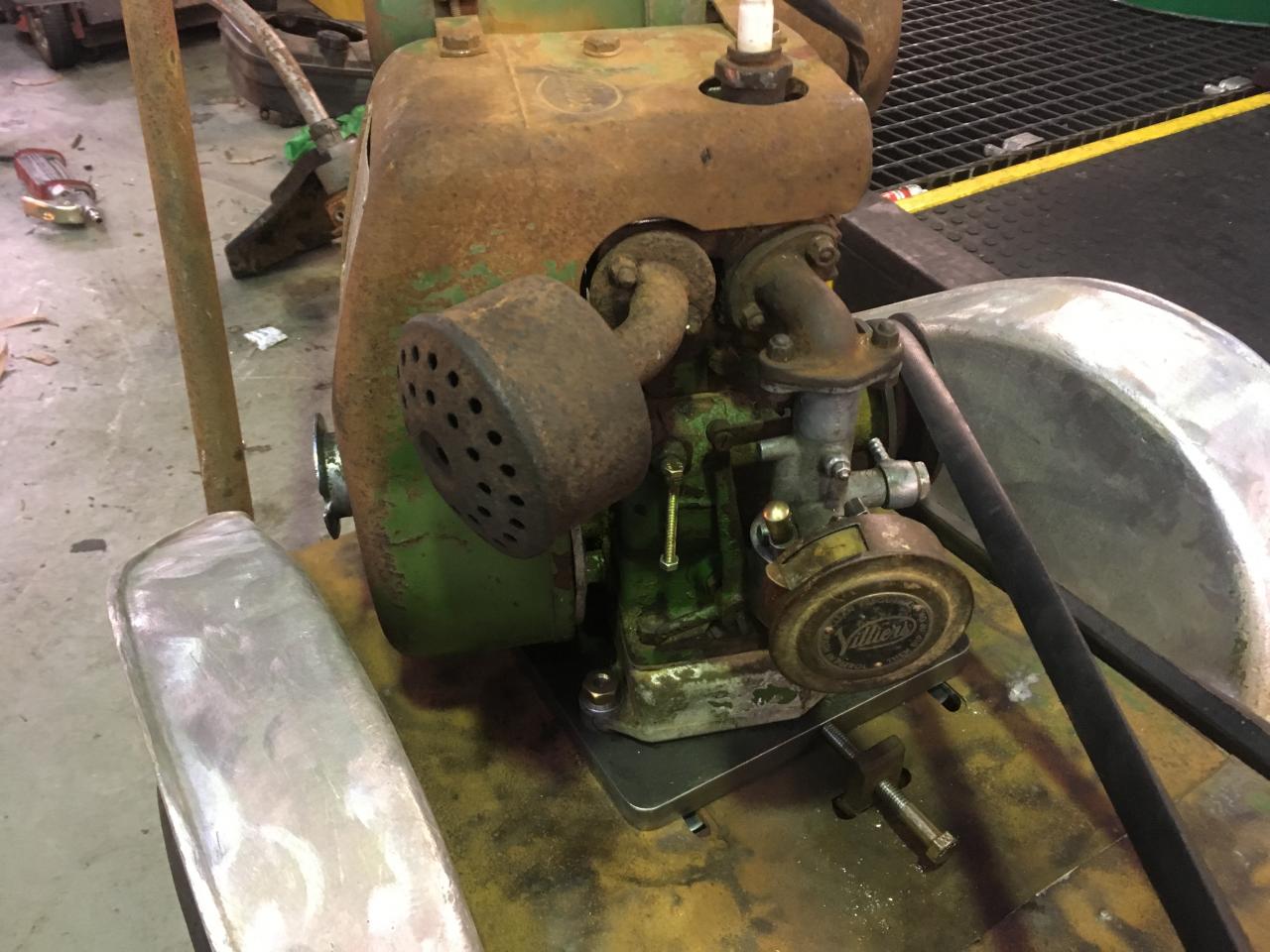

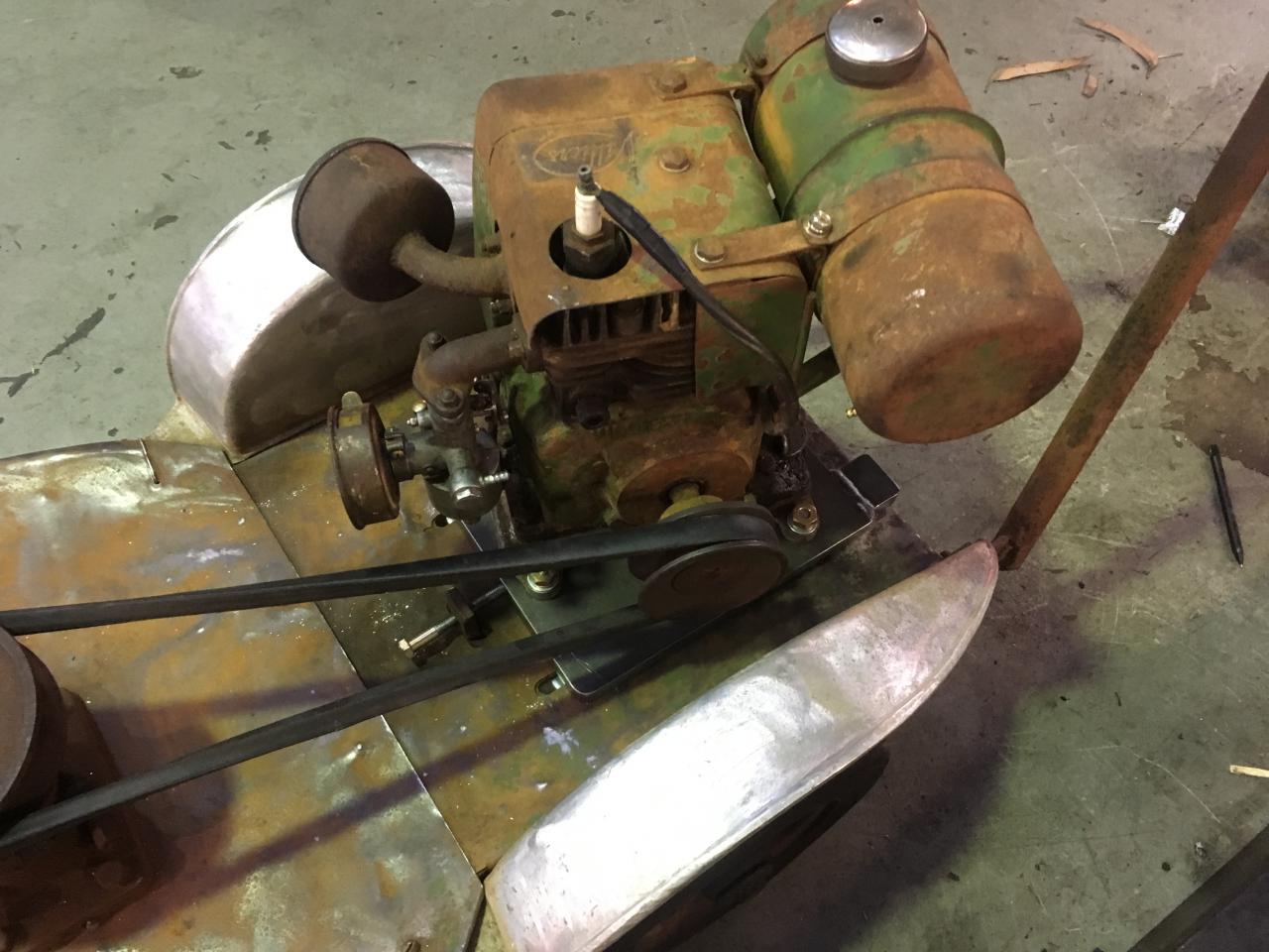

The engine adapter plate has been completed engine fits well. Now I need to find some flat steel bar to make a blade bar.

Hi Everyone been a long time since there has been any progress on my whirlwind slasher. With life being very busy the whirlwind has sat on a shelf in pieces for yeara. But with extra time off work due to corona I decided to get stuck in and finish her off.
A new blade bar was made as well as some new sheet metal for the frame. Also original pulley for the blade drive had been drilled by the previous owner so the pulley got replaced. I can proudly post some photos of the finished product pretty pleased with how it looks.
Just waiting on my whirlwind decal to finish it off.
